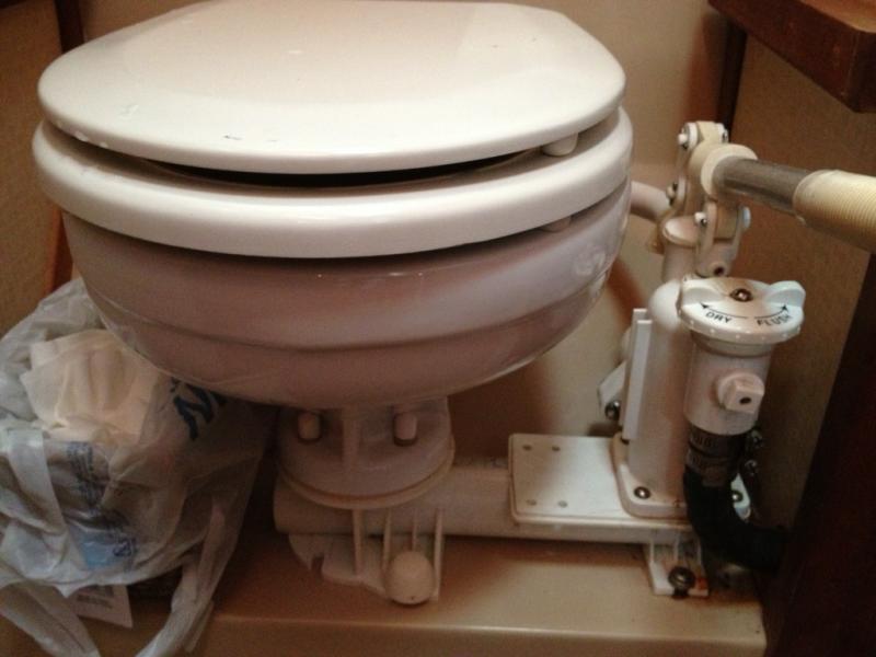

I feel really stupid for asking this but here goes anyway: How do I use this head?
Do I fill with water, do my deed, turn to dry and pump till deed disappears down the hole? Do I fill with water, do deed, , pump more water, turn to dry, pump out, fill with more water, turn to dry, pump out again to clean pipes? Do I do deed in bucket and sneak it over the side when no one is looking(wink)?, or what!
Efficiency counts because I have to go to pump out.
Please give step by step instructions as I obviously am not too bright.
This is our first day as a live aboard and we are overwhelmed! Can't even use the toilet correctly.

Here is the head.

Here is the head.
On our boat, the dill is": Pump enough to wet the bowl, do the deed, pump until the deed disapears, turn to dry and pump dry. At the end of the weekend or when pumping out, pump enough water through it to clear the pipes.

Take a look at your plumbing and hose lengths. On mine the hose length from bowl to tank is on the order of 7 feet. If you leave that loaded with solids you increase your risk of clogs and odor permeation. Operating a marine head is a skill.
23,525
Looks like a Raritan PHII. That's a VERY good unit, probably the best one made. You can download the manual from the Raritan website.
We pump on flush a couple of times before #2, then dry to clear all the lines. For #1, do it, on flush a couple of times, then dry. Pump enough on dry to get all the stuff to the holding tank, maybe 6-10 times, you're just moving it along, not adding (much if any) water on dry.

Hi matt, it seems that no matter how much i pump the deed stays in. that was what was confusing us was the idea that if we pumped long enough, the contents would flush. but it never would. So, today i just decided to just pump a bit of water in, then turn to dry and pump everything out. that seems to be working pretty good so far. As you guys have said, with urine, we just pump dry.

On your PHII head, wet bowl (flush) keeps pumping water IN a lot more than the little it pumps OUT. That's why there's the dry setting. If you don't have the manual, get one, it explains it all, 'cept it's wrong! It says in flush it will pump in and out. That has NOT been my experience.
