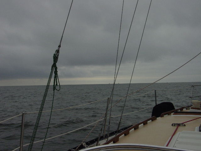

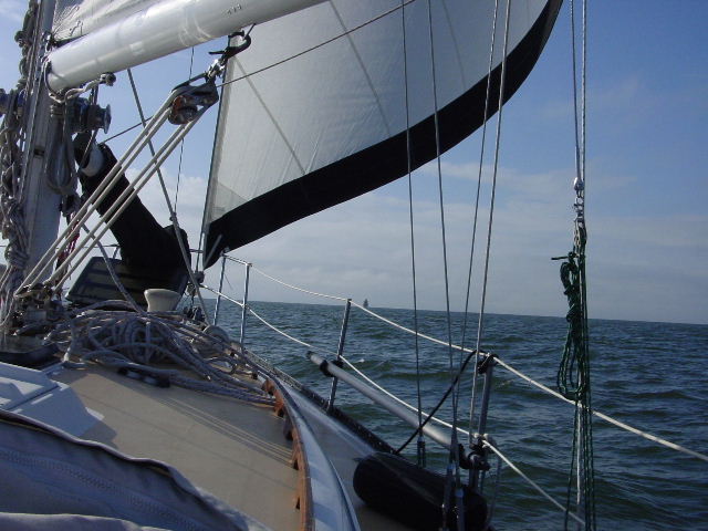

I found that they work well when clipped onto the toe rail about 1/2 a meter infront of the companion way. That puts them at an angle that helps support the staysail's forestay. The mast doesn't bend enough to try to use the check stays to change the shape of the sails. But, of course, the further you move them back, the more they'll get in the way when you're running down wind. Gotta watch that gybe or you could take down hardware when that boom swings over and tries to take the check stay out.
