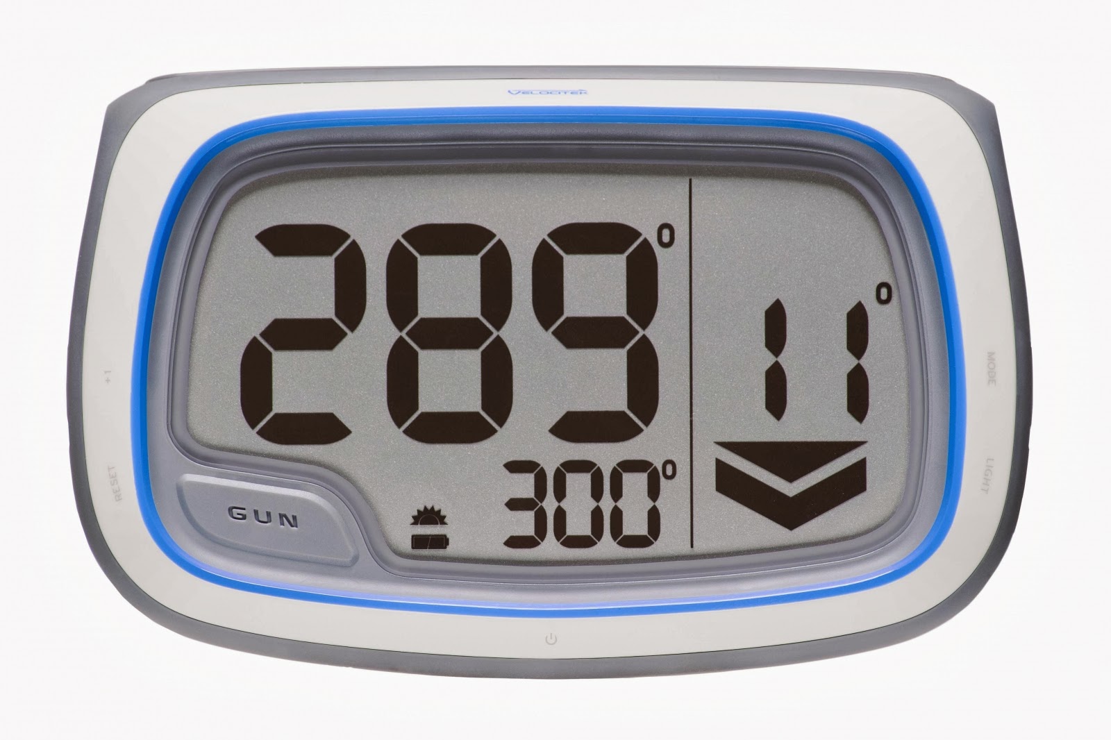

The only way your wind instrument can help you tactically is if it networked to your compass, and is designed to report TRUE WIND DIRECTION. This is different from True Wind Angle, which is always relative to your boat's heading. Going upwind, TWA will normally hover around 40-45 degree for most boats, no matter how much the true wind direction swings (shifts). Racing instruments like Raymarine tacktick and B&G Hydra will do this calculation and display it.
Stand alone devices like the Velocitek SHIFT will also do this. Here showing an 11 degree knock.
