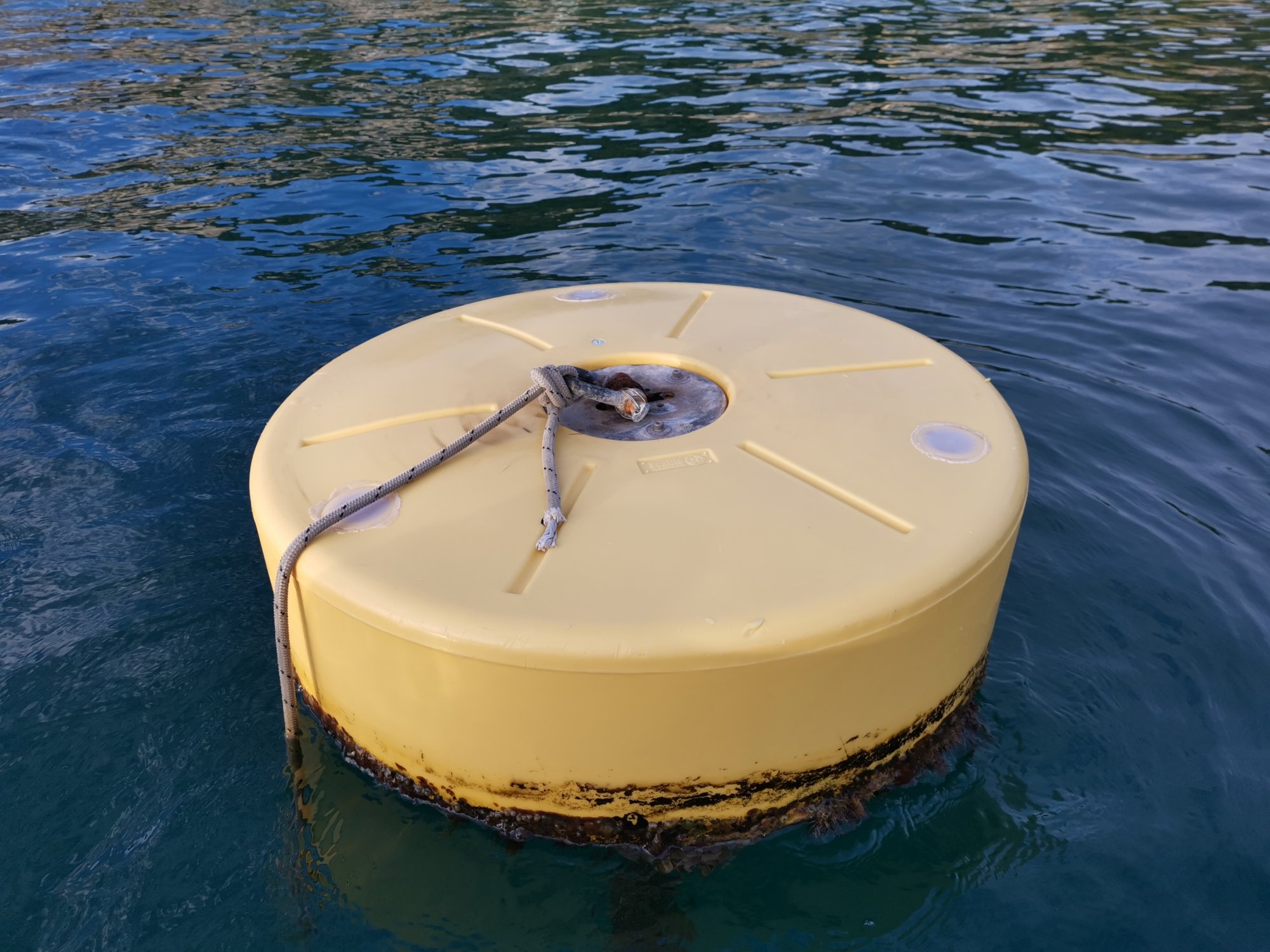

Today I encountered a type of mooring (see attached pic) that I'd never seen before and was hoping to get some advice on how to hook up to one. The float was a disc about 1 meter in diameter with a d-shackle in the centre. There was a thin line attached to the shackle but this was not to be used to tie off (it was much too thin anyway). I couldn't see how that thin line was going to help me attach a mooring line to the shackle so I didn't use it. Luckily for me the sea was dead flat with virtually no wind so I managed to hook the shackle with my boat hook, then thread my mooring line through the shackle from the bow, then pull the line back up with boat hook. This method would have been impossible in most conditions so I'm wondering what type of mooring equipment people use to connect to one of these? Also, are they very common?

The thin line is to lift the chain through the mooring disc. Making it easier to thread your mooring line through the D shackle. This type is common in Canadian National Parks.

Oh, I didn't think of that. It doesn't look like the chain would come up through the slot, and it didn't when I pulled it with the boat hook. But I wasn't really trying to lift it, just hold it steady. Will have a closer look tomorrow when I go back to the boat. Thanks for the quick response.

Some fo the mooring have a straight shaft that is a couple of feet long. It is the shaft that slides up through the buoy.
When we use moorings where we supply the line, we bring the buoy back to the cockpit area to attach the line. The freeboard is lower making the buoy easier to reach. This also enables one person to feed the line and the other to hold the buoy with a boat hook and still be near the helm. Once the line is fed through the shackle the boat drifts back and the mooring line is secured.
