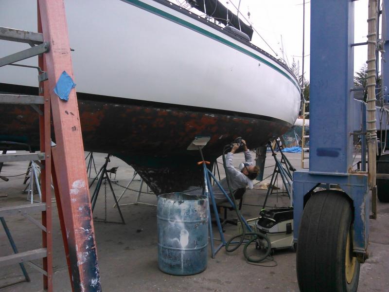

Currently got my 1980 Hunter 36 out of the water for the second time since I bought it in 2007.
This time I have DIY power sanded the existing bottom coating more aggressively than last time. In more than a few locations, underneath the current blue bottom paint color, then past the previous black coating, then past the even earlier red ... I've encountered white. Which is either barrier coat ... or I've exposed some gelcoat. Total percentage of white compared to the previous bottom paint coverage = hardly nothing = say .1% of the total surface area
Assuming the white is gelcoat, can I just apply the new hard modified epoxy bottom paint. Or should I pre-prime with something first?
A picture is attached of me sanding/grinding away on the boat's bottom which also happens to be on the first day that I can claim SS benefits. (But I am still on the fence whether to wait a few more years before actually doing so.) Before I started sanding, the color of my boat's bottom was the same as the garbage bin and the boat hoist's frames also in the picture. Can't think or a better way to spend a birthday?! Except that evening, my wife and I enjoyed mango infused tequila tonics together ... albeit at a safe 15 miles away from the boat!
