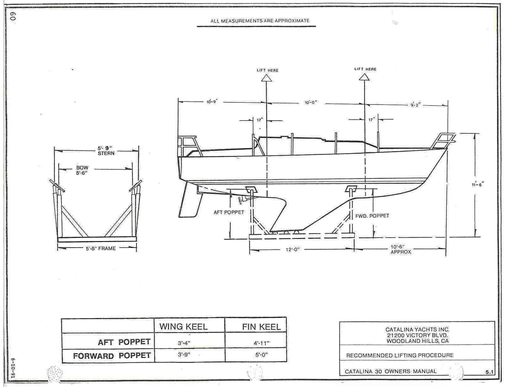

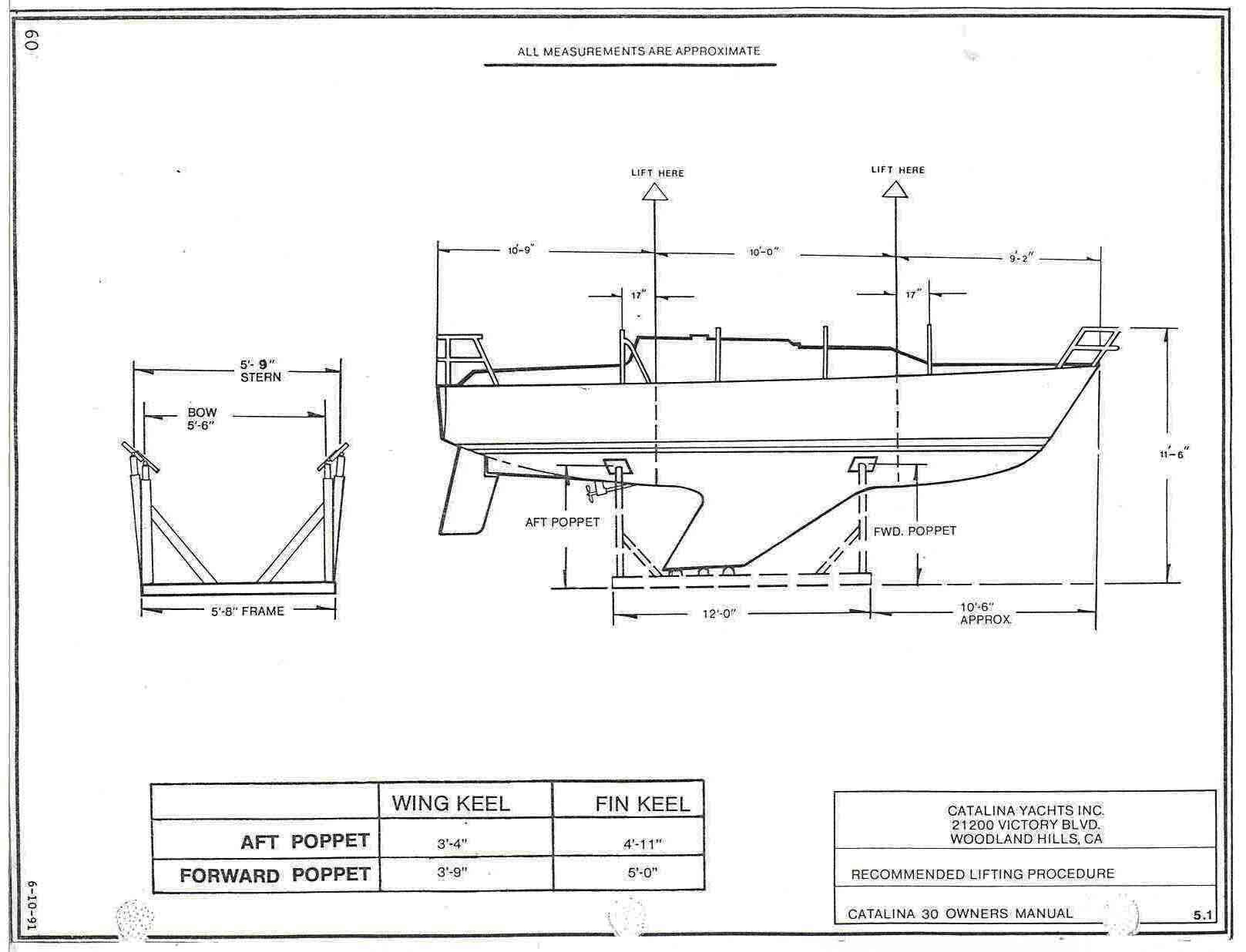

As an added bonus, here's a pic of the lift point & block-up locations for my boat. I would think you would be the same but, ask them to send you this for your boat.
Hope this helps pal........
