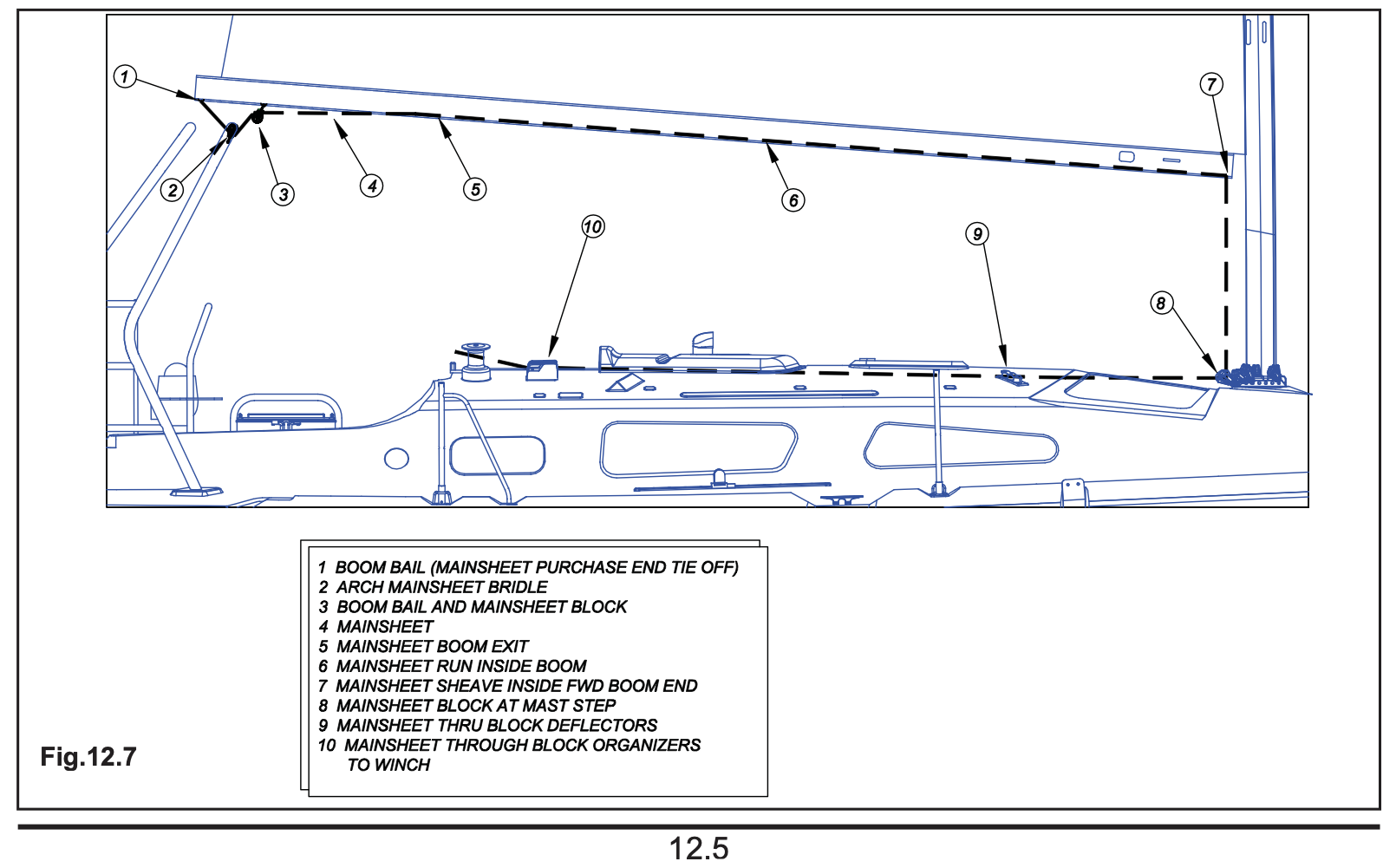

I see what you are talking about, Mark.
I would run a messenger line on a fish from the exit of the boom (stern end) down through the boom to the mast mainsheet. exit. There is nothing fancy about the mainsheet in the boom. The diagram shows the mainsheet lying on the bottom of the boom. Tie the messenger to the mainsheet and pull it through the boom.
