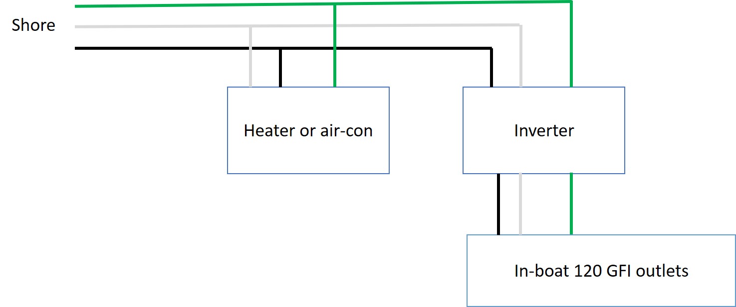

Background: My boat has a Xantrex Freedom HF inverter/charger. It was professionally installed. Here is what happens:
1- At my marina when connected to shore: no problem. Shore electrical is many years old.
2- At other marinas with new pedestals (ELCI-style), shore breaker is tripped after a few seconds, indicating a >30 mA leak between neutral and ground.
Per this forum and others, this problem is usually related to improper wiring of the inverter, mainly the need to separate the pre-inverter neutral bus from the post-inverter neutral bus. In layman's terms: place air con and water heater (which only run on shore power) before inverter. My boat has a common ground and neutral bus for all.
So far so good.
My issue is as follows. With the shore cable OFF, I measure 170 kOhms between neutral and ground (at the connector). This is because the Xantrex bonds the AC neutral and ground when not connected to shore. It breaks that bond after a few seconds when shore power is detected.
To make sure that I correctly identify my problem (improper wiring or inverter failure), I want to simply disconnect the heater and see if I still trip the ELCI. However, my marina does not have pedestals with ELCI!
How can I continue to troubleshoot and test?

So this is my goal then: create a new pre-inverter bus as shown in high level overview. Sounds like there will not be a way to test until i get to a dock with an ELCi equipped pedestal.
14,176
Looked at your drawing and I don't see where there is a buss.
When you are plugged into shore power the boat does not have its own generating capacity. The boat is just a big extension cord. However, when the inverter is being used to power the AC outlets, the Boat is now an electric power plant.
On shore power you the white and green wires should not be connected any where on the boat. When the boat is off grid and using the inverter, the white and green wire should be connected.
I haven't researched this, however, I believe there are switches to handle this and there may be some automatic switches that sense when the boat is connected to shore power.

I do not have aircon, just a Raritan hot water heater. We never use the heater when inverting (when not connected to shore). From what I figured out, the 3 GFI outlet neutrals + the water heater neutral are connected to a common neutral bus, post-inverter. Same with the ground. When I am disconnected from shore, the inverter bonds the neutral and ground. When connected to shore, the inverter breaks (or is supposed to break ) that bond.
90% of the load is to charge the battery. Ours is a very small boat with a single stater battery and a single house battery.
There is a switch/breaker between shore and inverter.
The GFI outlets have a on/off switch (not breaker - applied to black only). The water heater also has its own on/off switch (also not a breaker, also on hot or black) which we always leave off. I need to check but both circuits may be fused.
Why would I have an ELCI problem when the 3 GFIs and the heater are in OFF position? Regardless of Xantrex recommendation for a separate neutral bus for the heater, wouldn't this indicate a problem with the inverter itself?
It sounds like the simplest way to test is to wait till I go back to a new marina and then disconnect the heater altogether. If that does not work, disconnect each GFI neutral 1 by 1 until the problem is fixed. If that does not work, disconnect ALL neutrals from bus except the inverter neutral. If that does not work, the inverter is faulty or otherwise not installed properly. All of this is not very proactive unfortunately.

@Stu Jackson I am not the owner who got this installed. I know it was professionally installed and I know that I saw a single neutral bus and single ground bus for all 4 A/C circuits. When disconnected from shore, the neutral and ground were bonded, as they should.
When connected to ELCI pedestal with these 4 circuits OFF (on the hot/black wire), the breaker trips within 1 or 2 seconds.
I read elsewhere that the inverter does not break the bond automatically, it takes a few seconds. The ELCI is quicker to trip.
I do not mind the work, I just don't want to randomly change things without being able to test or at least isolate the problem.
One final detail, the green AC bus was jumpered to the DC black bus. These seemed correct with I looked a the Freedom installation guide.

For the ELCI to trip, it must detect a 30 mA current. For there to be a current, there must be a load. If all 4 circuits are OFF, there can be no load from these devices. At that initial moment, the only load is the inverter drawing AC to generate DC. That's what made me suspect the inverter, all things being equal. Again, I am looking for a sure way to test without have access to ELCI pedestal.

@Stu Jackson I thought about turning off the inverter BUT, here is what happens. 1- shore to boat with in-boat shore AC switch off = GOOD. As soon as in-boat AC switch is ON, the inverter automatically turns on, creating the fault.
@dlochner Yours is a good point. I checked resistance between neutral and ground at 2 places (NO SHORE AC PRESENT). At the connector: 170 kOhms. At the post-inverter neutral and ground buses = 0 ohm. The 0 ohm makes sense because the ground is bonded in that state. The 170 kOhms pre-inverter does NOT make sense.
In fact, now that I write this down, I see that this could be the issue. The ELCI will trip immediately if neutral has path to ground. If we extrapolate, I may have a leak pre-inverter between Neutral and Ground. not sure...

I am not ready to ditch inverter yet unless faulty. One, I do not want to rewire if i can avoid it. Two, we occasionally run our business from the boat and the limited inverter capacity is enough to power our hotspot.
What i need to do is test the wiring from the in-boat shore power connection to the inverter IN, with a special focus on white and green. more to follow. I will do a diagram first. Of course, boat is very cramped so I anticipate slow progress.
