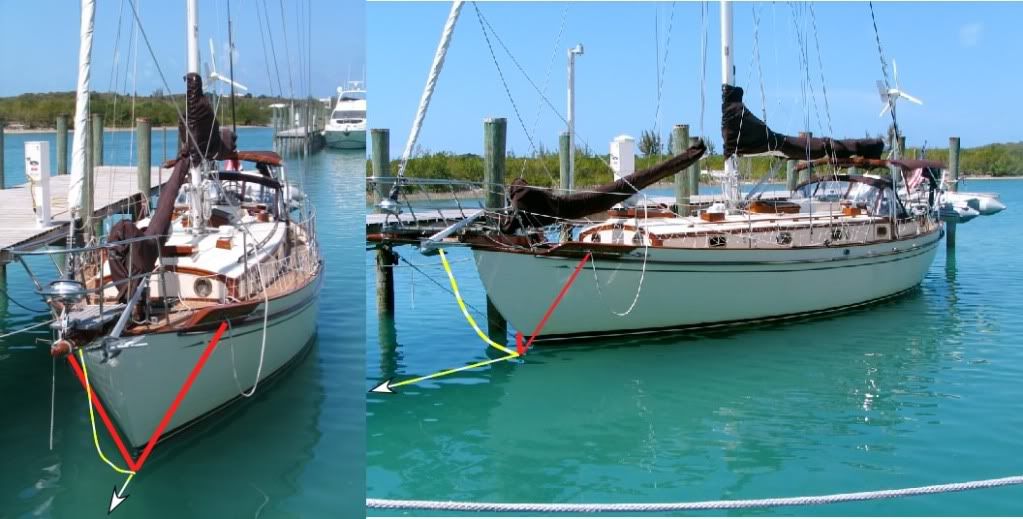

Another 'trick' to dampen swinging when on a mooring or anchor is to use a bridle ... a 2-part pendent attached 'back-from-the-bow' and so arranged that the 'connection' to the mooring pendent is AT near the waterline and 'under the bow'. How it works is that when the boat begins to swing, one side of the bridle will tighten or take up strain before the other side and will 'tend' to keep the boat straighter to the wind.
This is a mooring/anchor technique that is becoming more common in the 'hurricane' prone areas; and, many boats who moored/anchored this way in St. George harbor in the island of Granada during hurricane Ivan didnt wind up beached on shore as did the majority of boats which did not.
The mechanism with the bridle, affects a 'function of stability', especially for boats with high freeboard
Here's a diagram of how the bridle is attached ... and needs 'chocks' or hawse holes to prevent chafe and other boat damage. You also have to pull the bridle in under the bow so that the bridle is fairly taught. The bridle in effect lowers the angle of the rode. Not all boats will have their 'swing' dampened, you have to do a trial before you use this method:

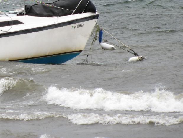

Here is a little offbeat solution I played with for a while, had some limited success.. for your "entertainment", Ill post what I tried..:D
I had a Mac 26S on a mooring a few years ago and in some wind conditions, it would do some fairly wild swinging, even somewhat violent banging in higher winds. I tried a bunch of stuff and never did really solve the problem. I had tried a riding sail or sorts but found that in gusty winds, it did almost nothing. Im guessing that anyone who has success with a riding sail is in much steadier winds than I had. What made the most difference (but still didn’t completely solve the problem) is at least a little interesting.

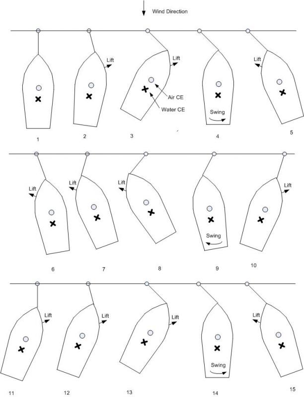

I had sat on the boat and observed the pattern it makes in the swing and the illustration below shows what I saw at least on my boat.
The swinging occurs because the boats center of resistance in the water is behind the boats center of resistance in the air and this is not stable when the bow is pointed into the wind as the bow wants to fall off. This is what caused the boat to go from "1 to 2" in the diagram above in the first place. Add to this the lift of the hull and you get everything needed for an unstable system.
One thing I noticed is that the bow of the boat moves a LOT during the swinging. Also, if you add some drag to the stern, you tend to move the underwater center of effort backwards and this exaggerates the instability caused by the the air center of effort being forward of the underwater center of effort.

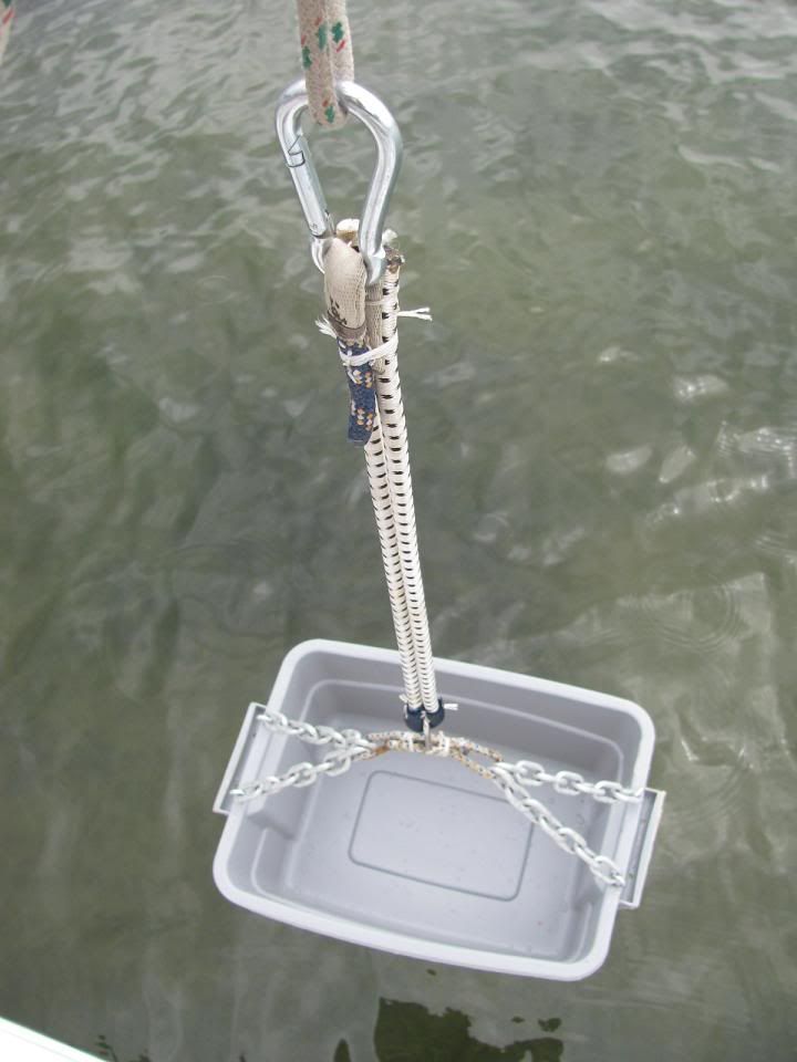

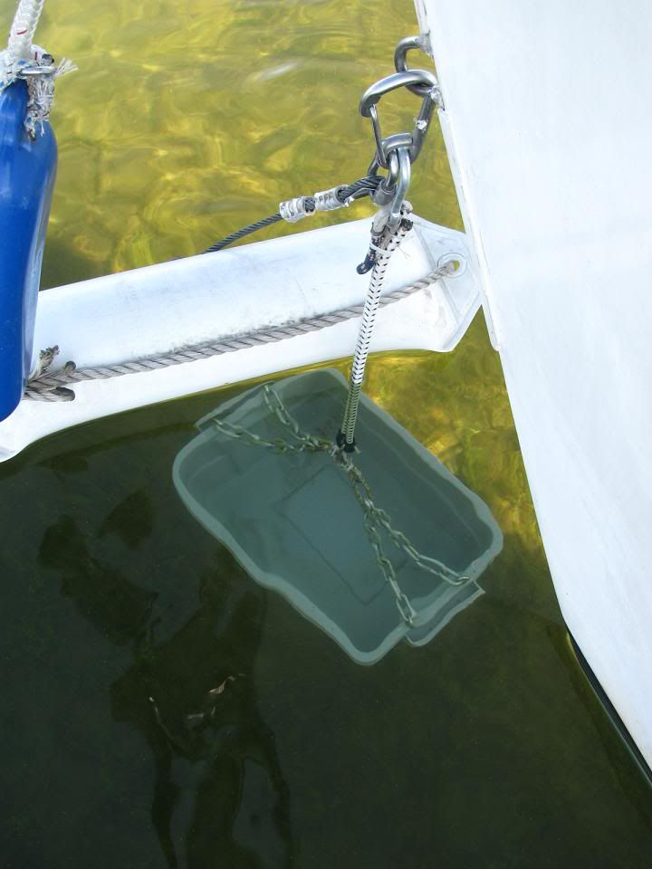

So I added under water DRAG at the BOW as this does two things which in theory at least should be positive. It moved the underwater center of drag forward which helps with the initial stability problem and it also dampens the bow movement. Interesting that a second anchor off the bow also tends restrict the bow side to side movement.
I had added the drag bucket shown in the pictures below and would just clip it to the bow eye strap. Since you’re trying to move the boat underwater center of effort forward, the rudder and outboard should both be out of the water and I found this did help.
As mentioned, the drag bucket didn’t completely solve the problem but it made way more difference than the anchor sail off the back or any sort of offset bridle arrangement I had tried.
