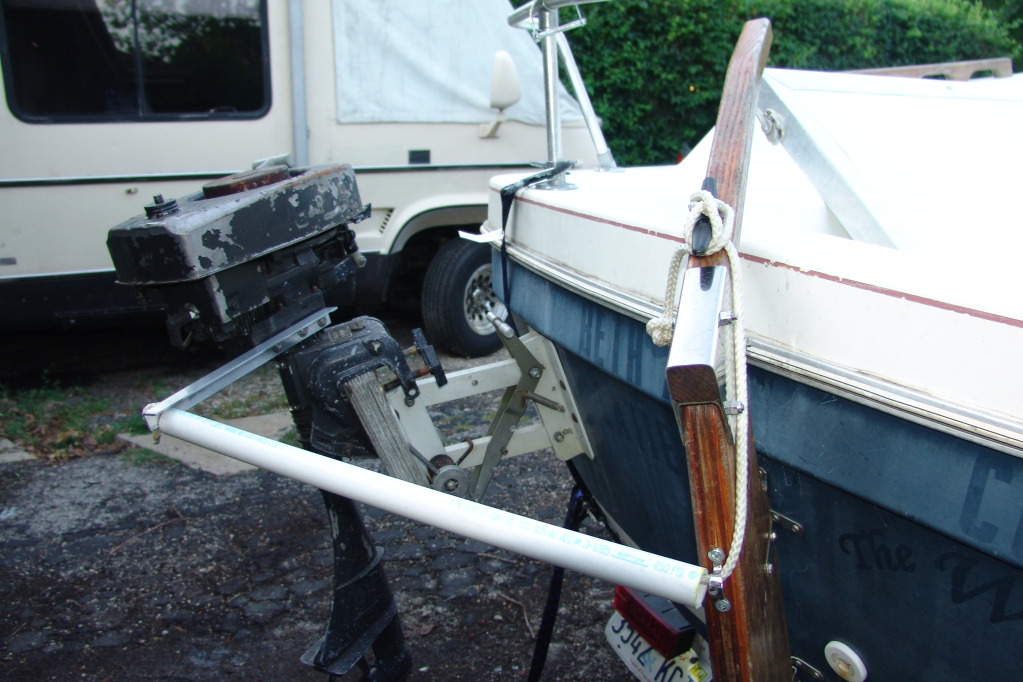

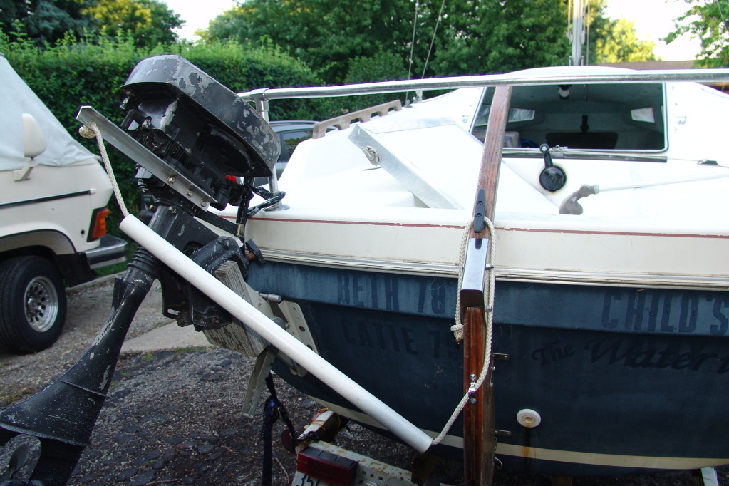

Anyone who says that tying the two together is complicated, has made it much more complicated than it needs to be. On my previous boat, it was very simple to add a bracket to the motor, and a cleat to the rudder. Tying a line between the 2 and cleating it down, is super simple, and quick to engage and disengage. I can tell you it helped immensely when docking and moving the boat in tight quarters. The boat would do a 360 pivoting on the centerboard, without any forward motion.

The photo above your post shows an outboard with no reverse. If the motor was running, the boat was moving. I put enough slack in the line, that the motor could flip 180 if need be. Any time I backed away from the ramp, I had to flip the motor the wrong way to back up. Even in the confined area of the launch area, it was still simple to flip the motor back around and yank the line tight to synchronize the steering when moving forward.
