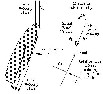

A sail DOES NOT move a boat by deflecting wind.

Yes it does. Unless you meant 'defecating' instead of 'deflecting'. Not sure which letter you left out.
Deflecting. Boats move forward when lift is created. And deflecting wind (turning it aft) is not lift.
8,150
I'm still trying to wrap my head around how throwing bricks off my transom will make the boat go. And, I took Physics - 'though all I remember is F=MA and you can't push a rope. For me, all of these explanations are constructs to make something difficult to understand (Unless you understand aeronautics) understandable.
8,150
So, like I said I'm not a aeronautics guy and can't play one on TV. But I have a few problems with all of these constructs. The first, the speeding of the flow over the the top of the wing has several problems. Some of which were covered in the video. But I'd like to add that the proposed foil shown is nothing like the shape of a sail. For that matter neither is an airplane wing. For a sail, which is maybe .5 mm thick, the distance the air flows on each side of the sail is virtually the same. You probably couldn't measure the difference. So the lift wouldn't be due to the differential distance the air flows on both sides of the sail. The Newtonian model I'm trying to grasp. I understand, from being a kid and, having my hand out the car window for hours, making different shapes and feeling the difference. Yes, if the angle of attack is up and the palm feels most of the pressure the hands wants to go up - and back. I don't get why that makes a boat go. I know the construct a la Arvil Gentry, and books, North U etc. about air flow around the sail, which I can barely grasp and doesn't really provide me with a usable model. What I do know is that the more attached flow and the less drag the better the sail performs. This is empirical not theoretical. Attached flow = boat go. Unattached flow = boat slow. Yes, the sail alters the flow of the wind over it by bending it. I'll stipulate that creates a pressure gradient. But we also want attached flow. So we want to bend the airflow enough to alter the airflow but not enough to cause separation and the dreaded drag. But, for the windward side, the bend is virtually the same (Remember we want tell tales flying on both sides of the jib) and the pressure gradient would be the same but in the opposite direction and I can't see any net difference. " 'plain to me please..."
