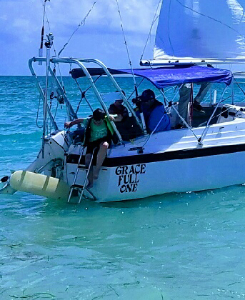

This pic shows the arch well, but you can't really see the lines or where they go. Please excuse the mayhem.

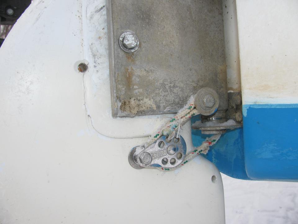

That is a nice feature of the quick release. If the rudder kicks up you just pull it back down and put the line back on the quick release and you have full rudder control restored in seconds. They are not a big dollar item and I don't think I've ever heard of someone removing one once installed. A good upgrade for the S,..... If you break the rope or pin you CAN NOT sail the boat with the rudder free, it will bend the rudder pole.

Do you use the Uni-Arch for your mast cruch when transporting with the mast down?
The arch appears to go from one side of the stern to the other. Can you easly board from the swim latter with out a lot of ducking?
Mine has a 1/4" line attached to a lower hole on the front of the rudder, up through the tiller shaft and over the top of the tiller to a cleat on the top of the tiller. Lower the tiller, pull tight on the 1/4 " line and tie it off.my rudder only came with a line attached to the trailing edge, which I use for raising and lowering. Am I missing a line that should be attached to the leading edge for lowering?
