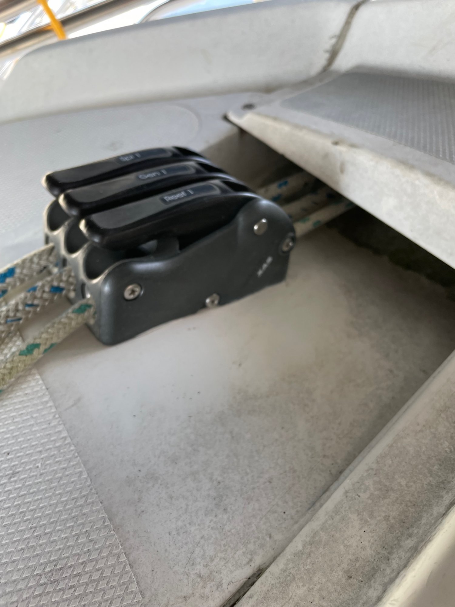

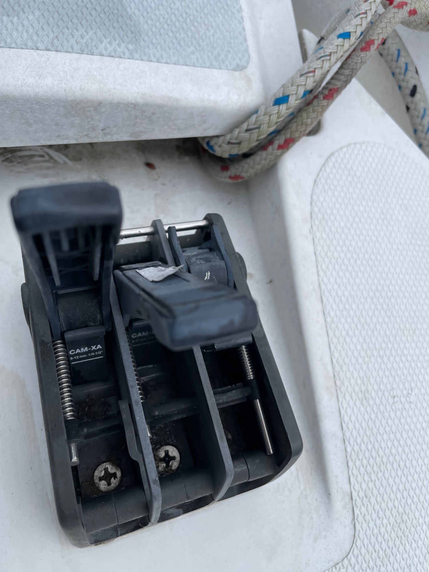

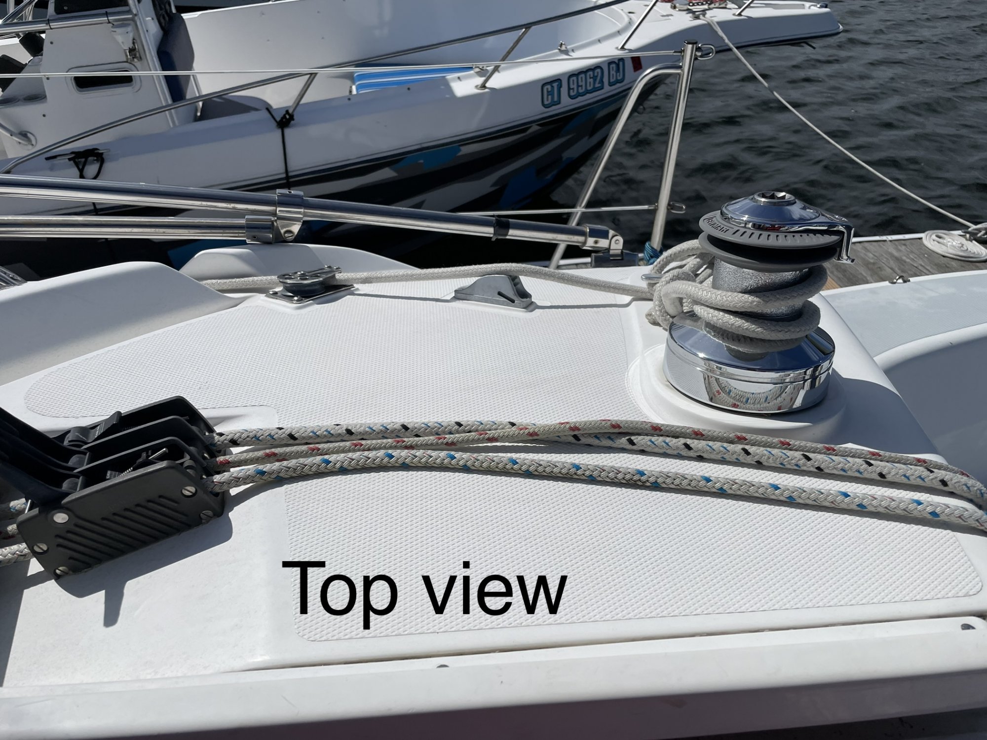

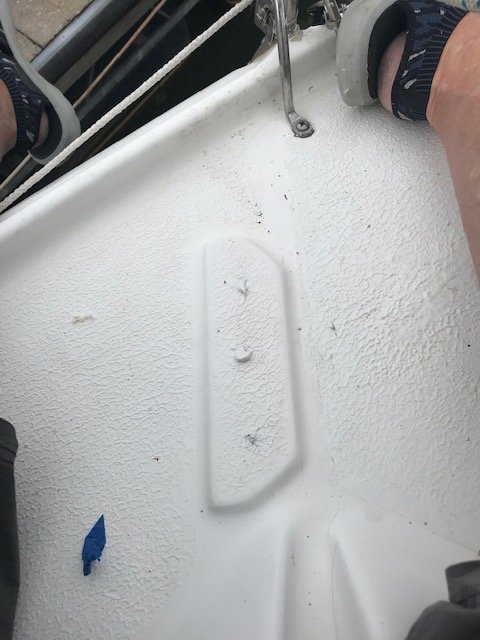

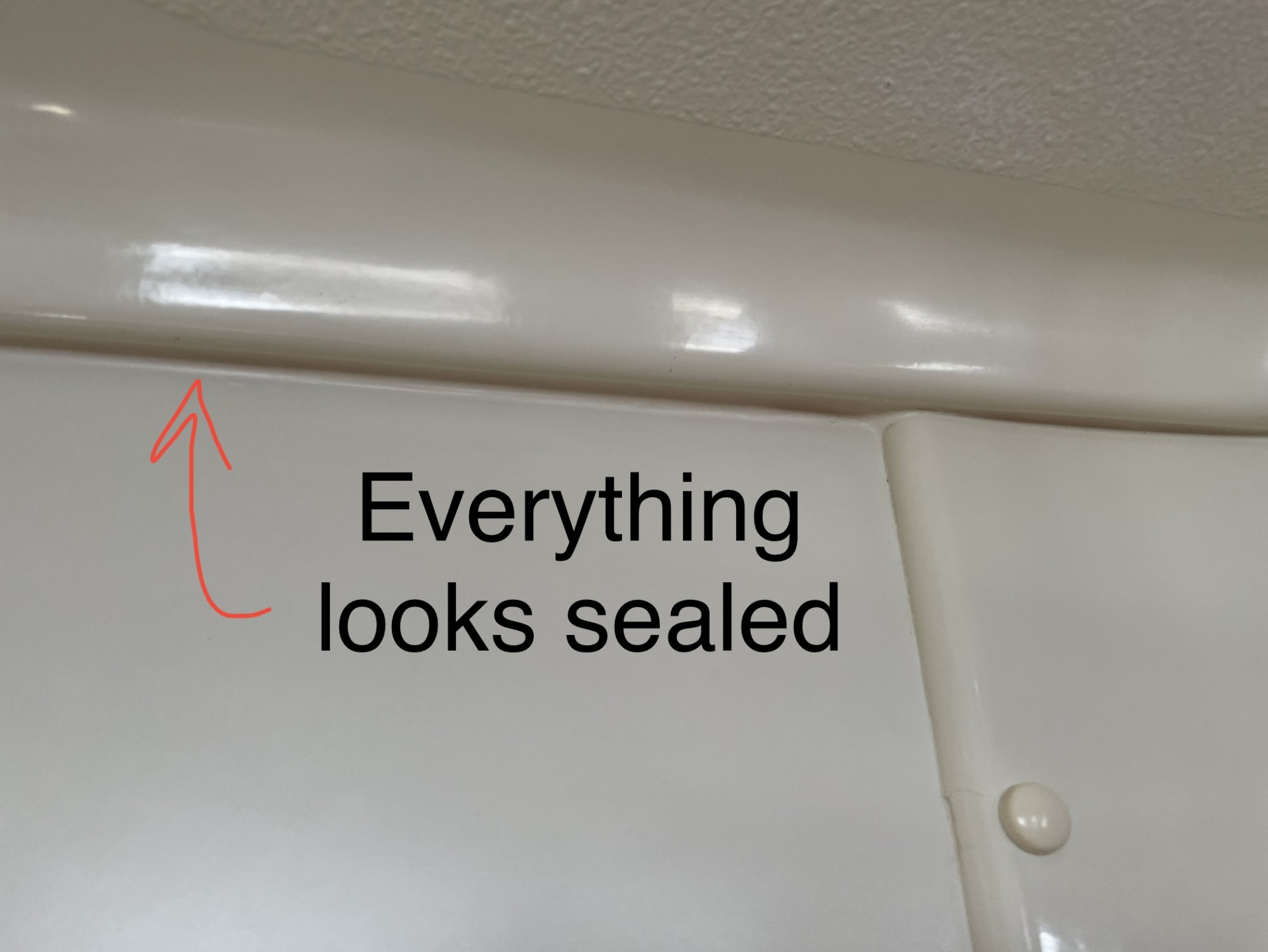

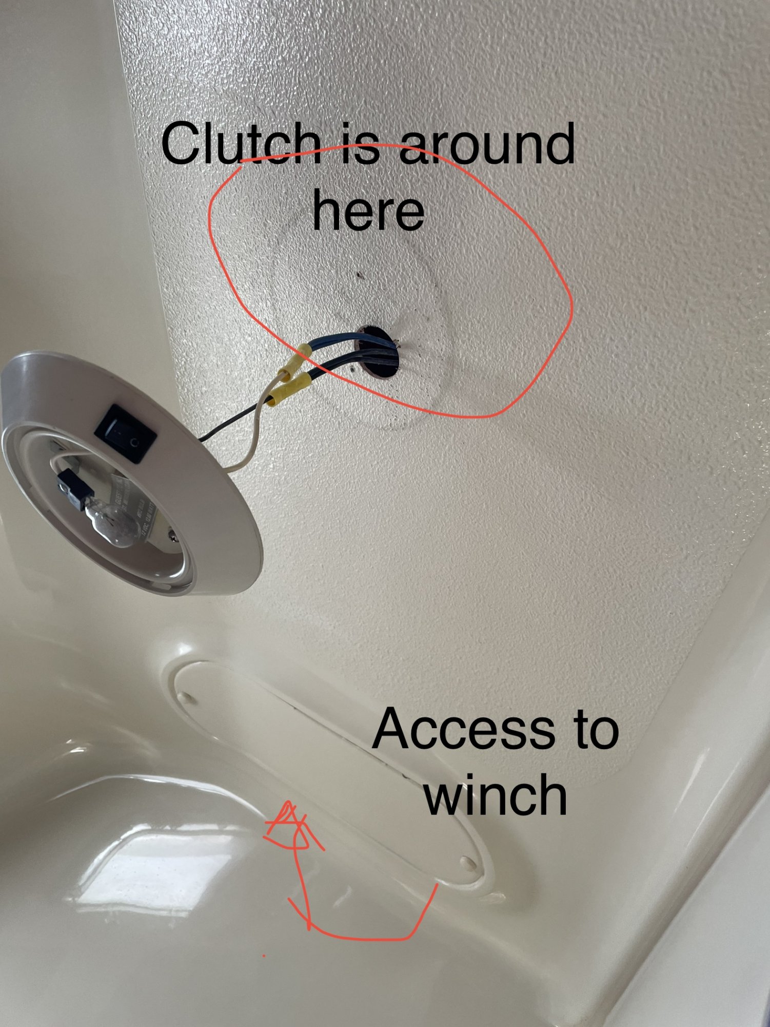

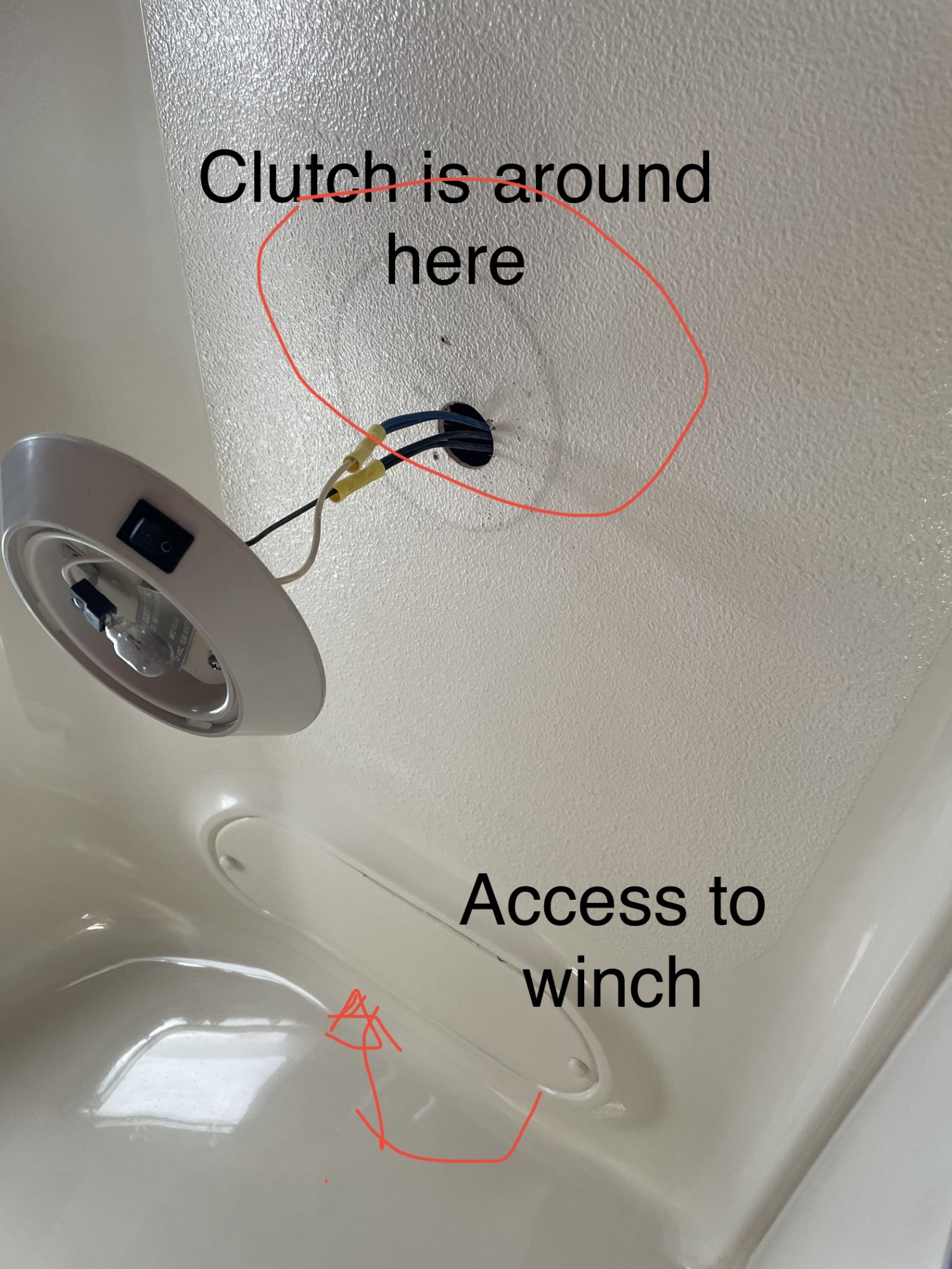

I want to replace the starboard triple rope clutch on my Hunter 336 (one of the handles broke). I’ve seen videos online on how to do this on other boats and seems simple enough if you can access the rope clutch from beneath, as there are nuts that you need to access in order to remove the old clutch and install the new one.
I don’t see a way to access the bottom of the clutch at all (see pictures attached), so I am wondering if in the case of the 336, the clutch is only glued to the deck….?
There is only small opening to access the winch on both the port and starboard sides, but no access to either rope clutch.
Has anybody replaced this?

Can't you just replace the broken lever/handle , work all done from top? That's what I did for my h326. There are 2 long smallish bolts that can be remove from the clutch assembly for access to remove levers/handles. The rod holding the levers should be able to be tap out.

Thanks Ken13559…. I’ll look for the replacement handle first. The new triple clutch is about $250 at Defender (new model XAS), so I’ll check the price of the handle (legacy model XA).

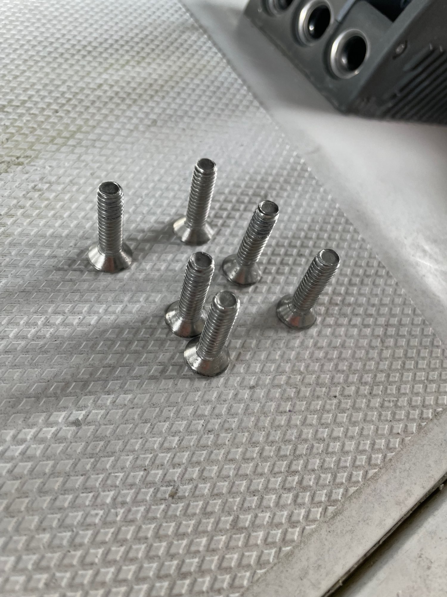

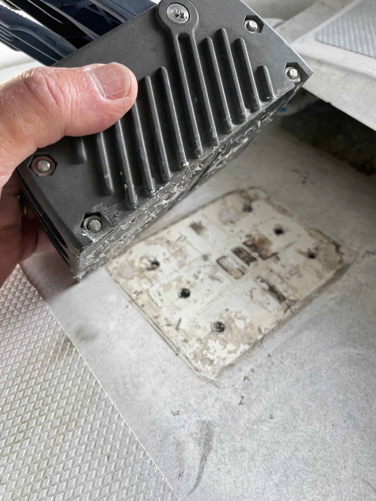

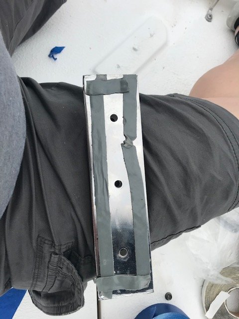

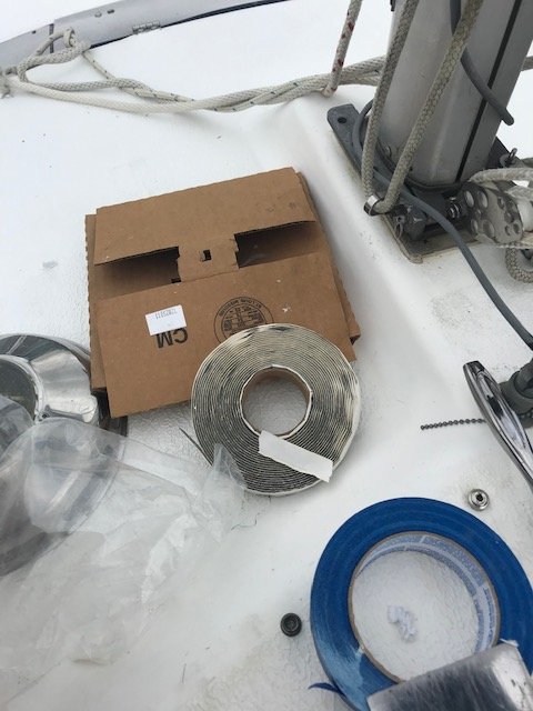

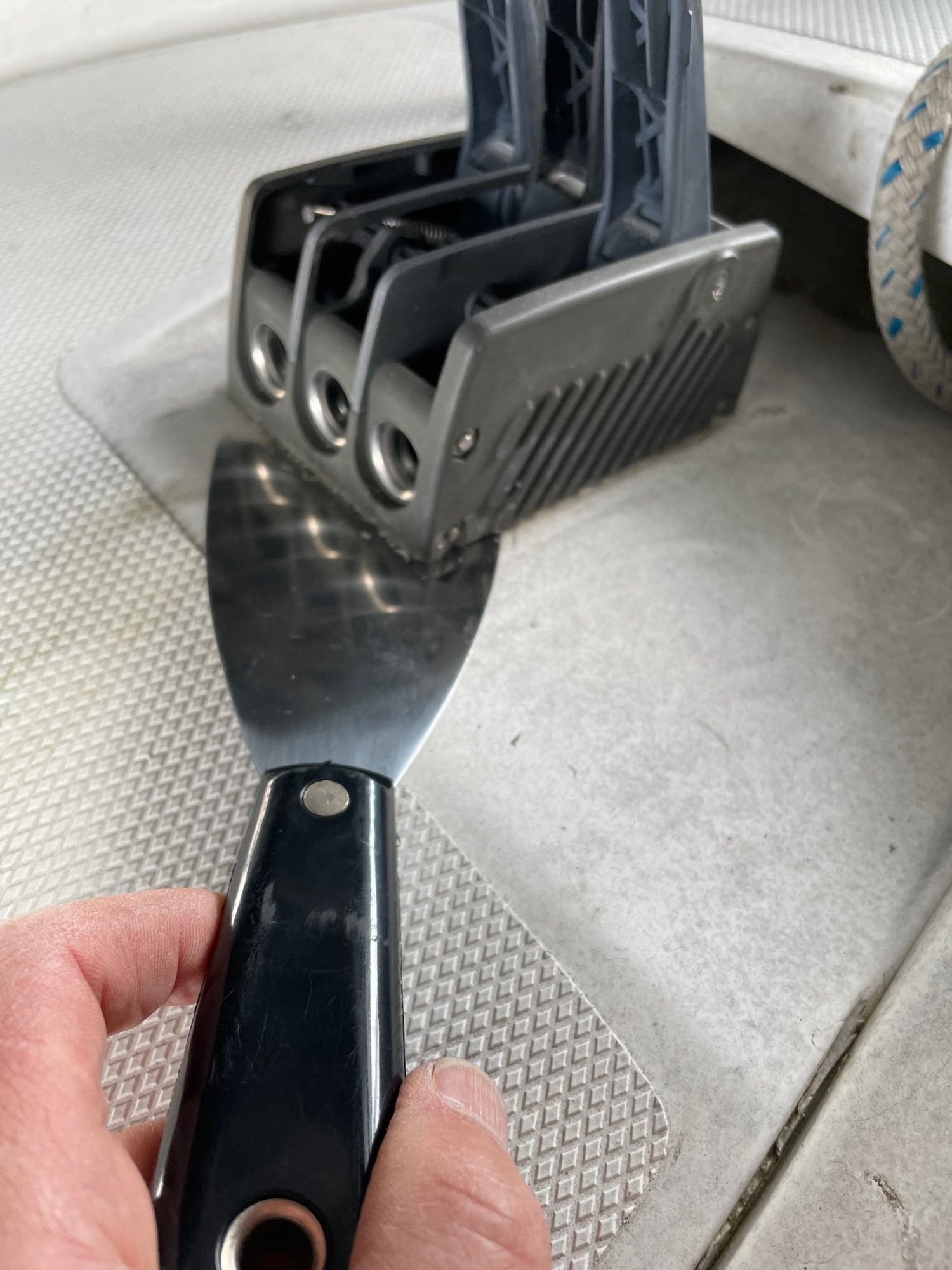

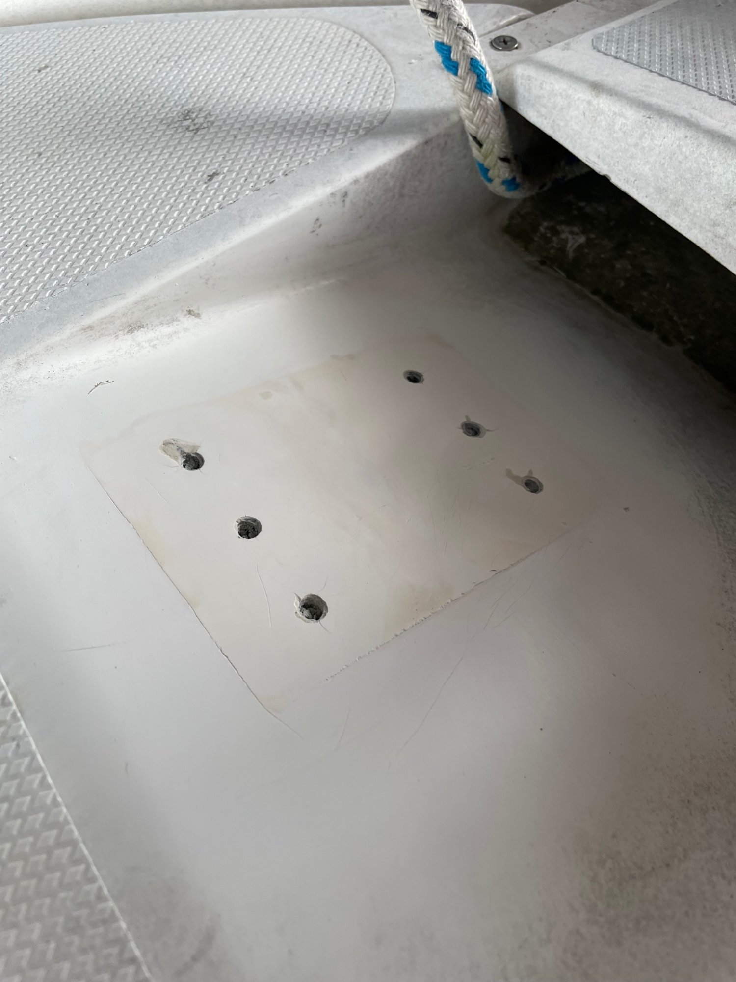

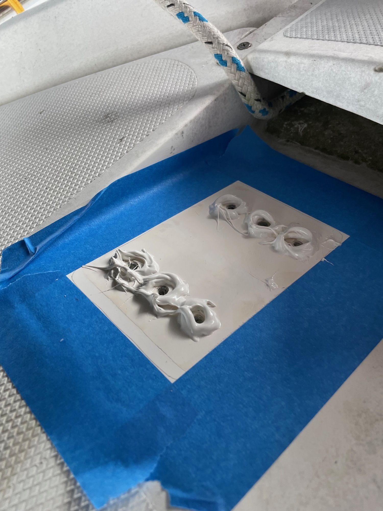

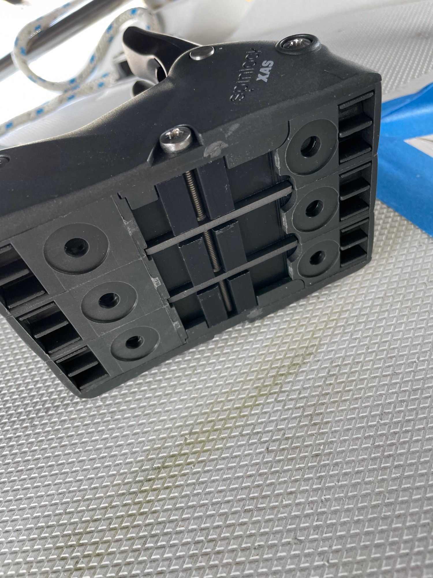

Finally got around to replacing the rope clutches. I decided to bite the bullet and replace both, since Defender had them on sale for a mere $225 each. It turned out to be much simpler than expected. I had an impact driver ready but the machine screws came out without issues using a regular screwdriver. I used a metal spatula to pry out the old one and it came off easily after scraping and prodding it some.
The key thing was to align the screw holes and mark where the new rope clutch sits before applying the adhesive. Once the adhesive is on and you lay the clutch on the surface there is no way to see the screw holes, so it gets messy if you skip that step.
The new clutches did not come with screws, so I reused the existing ones. They were somewhat gunky but nothing a little acetone and goof-off couldn't fix.
I used acetone and a regular dish sponge to remove the gunk from the boat's surface. I had to use the spatula at times as well.
Thank you all for the guidance, and here are the pictures...
A technique that can help in a situation like this is to get some threaded rod matching the diameter and thread pitch of the fasteners (or some long screws with the heads cut off) to place in two of the holes diagonally from each other. These will act as guides for putting the clutch block in place. This will help you start the remaining screws and then the guides can be replaced by the fastening hardware
