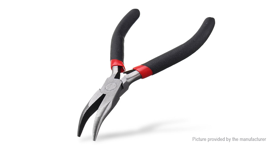

Are you talking about the separator between the two sheaves at the bottom of the mast on the starboard side? Where the halyards go out and around the turning blocks and back to the clutches?
I replaced mine last year or the year before. I cut a new piece from some leftover material I had when I replaced the friction plates on either side of the tiller above the rudder.
It's all totally independent from the mast, so sure it can be up. There is about a half inch steel pin going through the sheaves and the separator. I used needle nose pliers to grab it between the sheaves and push it forward and out the hole. There's nothing holding it in but friction.

Yes. You got it. Thank you. I am going to try the needle nose pliers. I didn’t realize it would just slide out. Do you know if caulking is necessary?
13,044
I replaced mine... the pin was set with Dow 4200

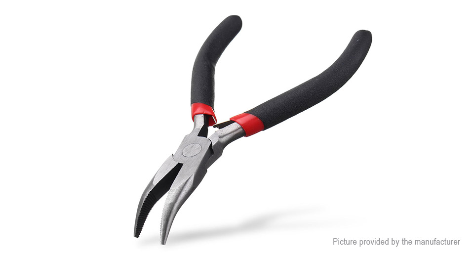

Halyard separator is all done. Thanks everyone. The 90 degree bent tip needle nose were awesome. The pin pushed right out. Note if u buy the halyard separator from this site u need to drill it to the size of ur pin. No big deal just make sure you take ur drill ! And I keep forgetting to take the gel coat pix. Coming soon Crazy Dave Condon.
