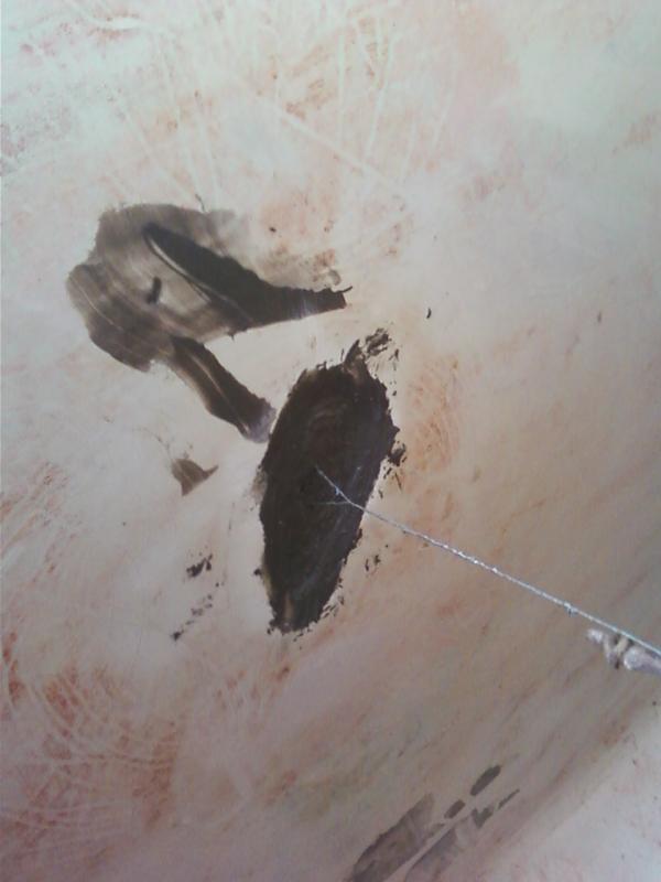

I've done this... it works and is rather easy.
Here are some pics...
I took a piece of plastic sheeting and laid it over the hole, then using a sharpie, traced the shape of the hole. Then I made a backing plate out of fiberglass right onto the same plastic sheeting. I was able to make the backing plate 6 layers thick. The backing plate was slightly larger than the hole. I drilled two holes in the backing plate and slipped some dental floss through the holes. I slipped the backing plate into the hole in the boat smeared Marine Grade JB Weld around the edges and then pulled it tight with the dental floss... I tied the floss to a tree and wound it up with a stick to make pressure. Once I had the backing plate in place, the rest was a normal fix with beveled edges etc. In the end the backing plate was 6 layers thick and the hole took 9 layers to fill. Each layer successively larger. That "hole" is now 15 layers thick. Should do the trick.
