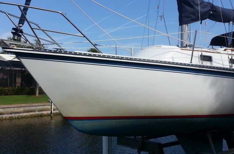

When we bought our boat it had some yellowing color on the Hull. (See attached Photo) The previous owner said it was from the salt water. I have tried to remove it with wax, toilet bowl cleaner, soft scrub, polishing compound, and simply green. I do believe it is a little better than it was but still cannot seem to get it all off. Any suggestions as to what might remove the yellowing tint? You can see the discoloration right above the red water line.

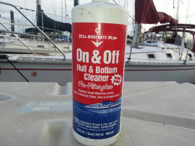

You need a good acid. I tend to prefer On/Off GEL as it tends to stay where you put it and not on the bottom paint to eat the copper. One bottle will last you ten years....

That will work. Just make sure you don't get it on the bottom paint. I would tape off the bordering area between the gel coat and bottom paint. Pour some of the acid on a towel and rub the soiled area. Once removed hose off the hull. The water will dilute and neutralize the acid.
I've used the same product but in a gel form. It works great because it doesn't run. I picked it up at West Marine, it's called, " On Off".

Thank You everyone. I got some of the On/Off. It worked great after a few hours of applying it to the whole boat above the water line. Now the boat finally looks white.

Please check your MSD on what you are using first. On Off's active ingredient is Hydrochloric Acid, nasty stuff, thats why you need to use gloves eye guards and mask off everything else. It will pit your galvanized trailer. Some of the other stuff like sno bowl cleaner, Bar Keepers friend is oxalic acid and is a little more user friendly. I would try an oxalic based one first and if it is really stubborn go for the hydrochloric based stuff.
