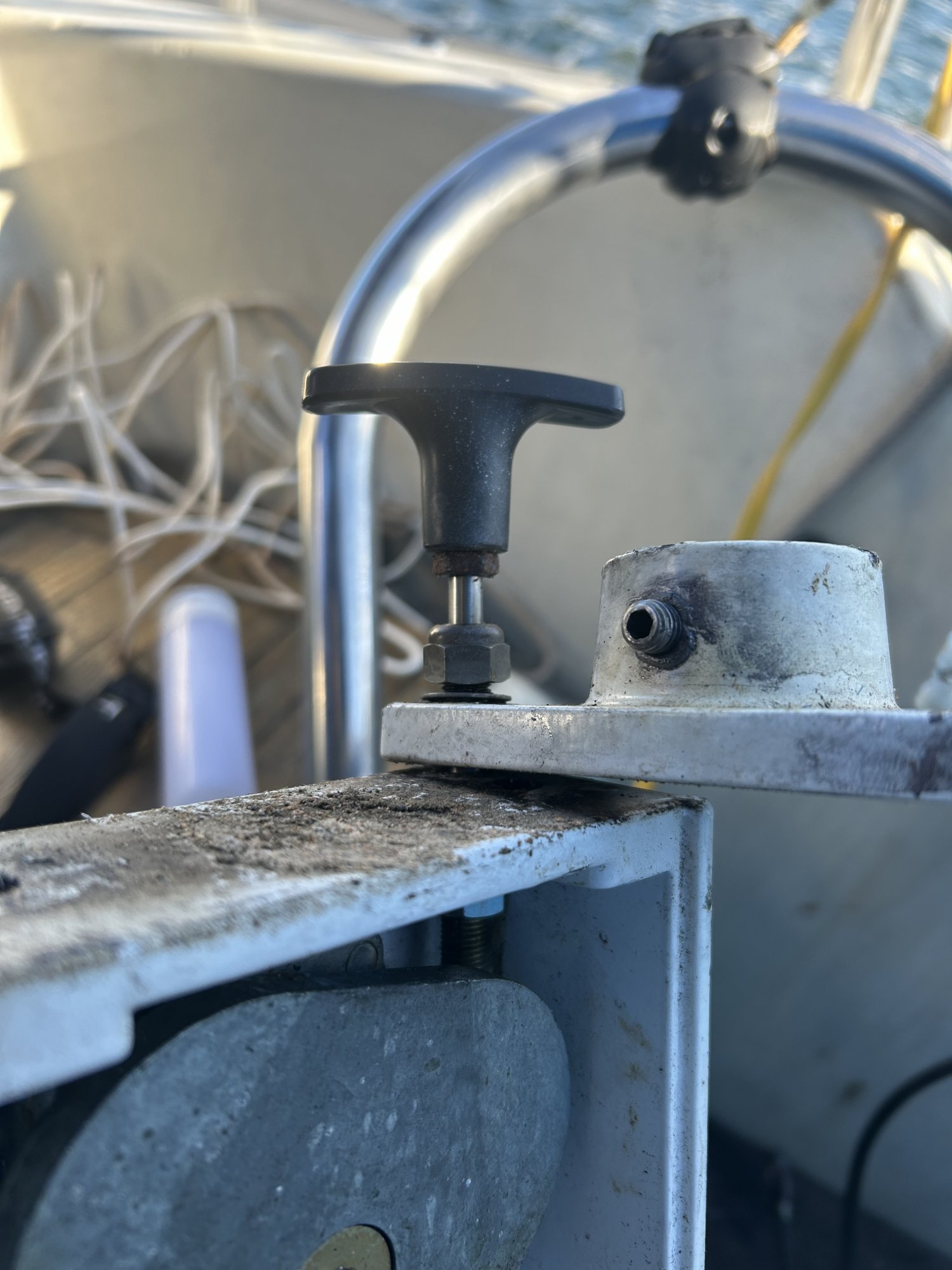

I’m taking apart my Whitlock Cobra (4?) pedestal. The last thing holding the top plate on is the handle for the fuel cut-off cable. Is there a way to remove the handle only, or do I have to disconnect and remove the whole cable?
Jan 25, 2011
2,439
S2 11.0A Anacortes, WA
Looks like there is a nut below the cable signifying the shaft is threaded. Loosen the nut and the handle should just screw off..
