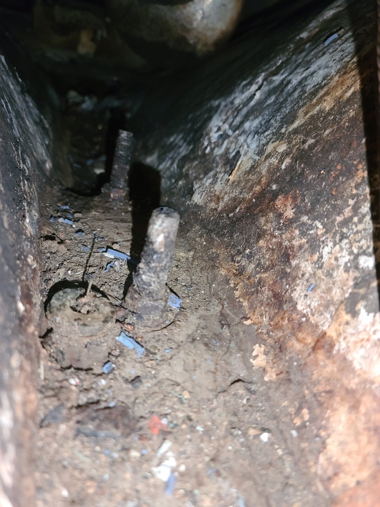

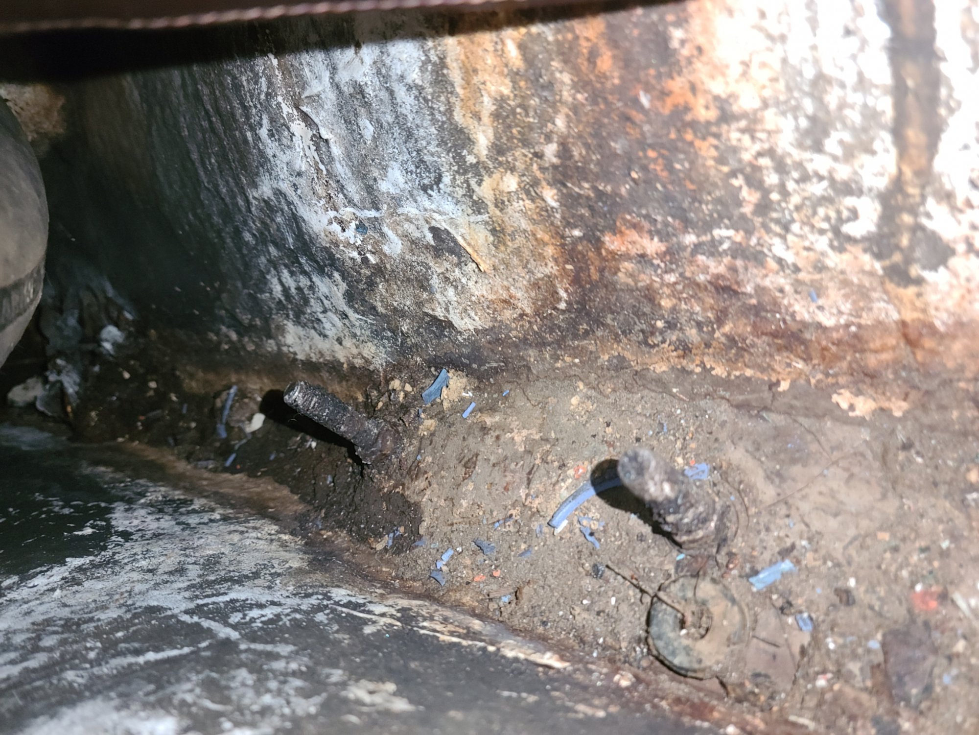

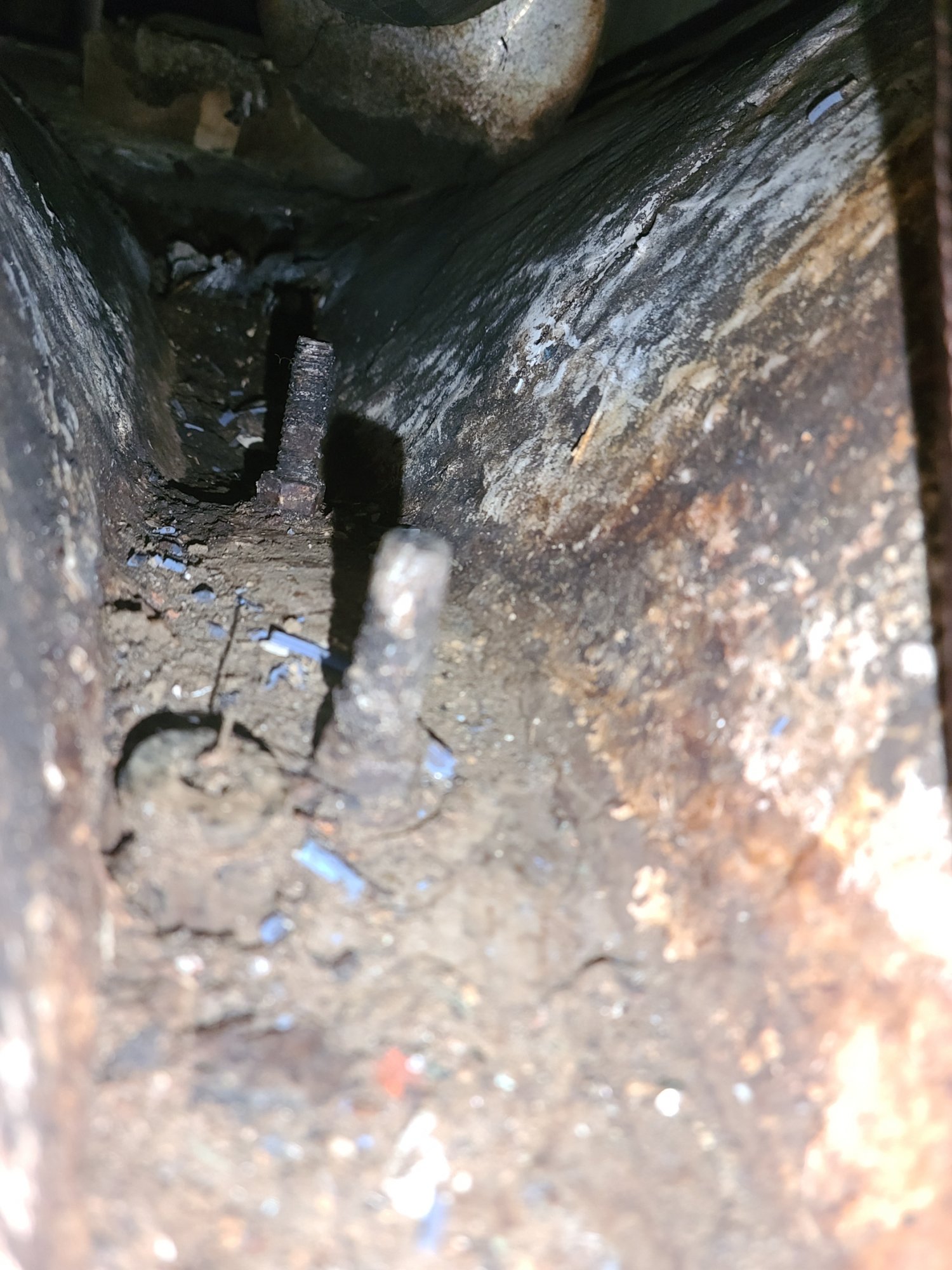

I was looking at the propeller shaft strut bolts underneath the cockpit and they are extremely rusty.
An angle grinder won't fit in the area.
Anyone have any ideas how I can remove these?
Best regards,
Rick

I remember those. Mine weren't too bad, but then she was only about 10 years old when I bought her. Possibility - drill the heads out from the outside and remove the strut, then punch the remaining bolts up inside or with an extension, turn them until free and removed.
Jan 4, 2006
7,770
My first try would be to remove the nuts and grab the bolts from the inside with a vice grip and try working them out of the holes down through the strut.
If they're bolts with protruding hex heads, you may be able to worry them to death with a Dremel grinder (they're small but low powered). If they're flat head machine screws (like mine) time to kiss the strut goodbye.
Looking further into this, is there really any advantage at all in removing the bolt heads ? If you can't force them downwards it's doubtful you'll get them going upwards either. Mind you, desperate times call for desperate measures.
Pay particular attention to @Tally Ho 's comment in post #2. If it were me, I'd be looking at removing the strut to reseal the area under the strut once the bolts were out. Too much chance of leakage if the sealant under the strut breaks. If you destroy the original strut, re-alignment with a new strut will be difficult requiring new holes.
Lots of thought and planning ahead. Best of luck and let us know how it goes.
Will look into this idea. Might be that the drill can't align straight on the heads. We'll see.
Nut splitter? (ouch)
Maybe.... I'll have to look closer and see if it'll do the job or make things worse... Everything is so rusty inside...
If I can remove the nut and/or cut off the bolt inside Working the strut down and off the boat should pull the remaining bolt length through the holes. At least that's what I think should happen. :)
I believe they are hex bolts sunk into the strut. But I don't follow.. Why would I have to kiss the strut goodbye if they're flat head?
I'm thinking that the removal job will be a cake walk if either the nut is removed, bolt & nut is cut off inside, or if the bolt head is drilled out or removed.
Definitely in the thinking stage. Having the yard do all this is on the table as well.
Jan 4, 2006
7,770
If they are flathead machine screws, I can see the grinding doing damage within the countersink.. I can just see part of the strut base going with it unless you're super careful, and very religious.
I suspect there's sealant under the base which will not be pleasant. That'll require a whole new vocabulary to remove the strut, unless :pray: :pray: :pray: the sealant is deteriorated to the point where it'll let go easily.
You seem pretty comfortable with this type of work so I would not approach the yard until absolutely everything else has failed. I have seen too many of these guys bulldozing through a job in an honest and sincere attempt to avoid spending endless hours ($ $ $ $) doing what should have been a simple job. You may be looking at some really time consuming crap with this but in the end, it'll give you the results you want.

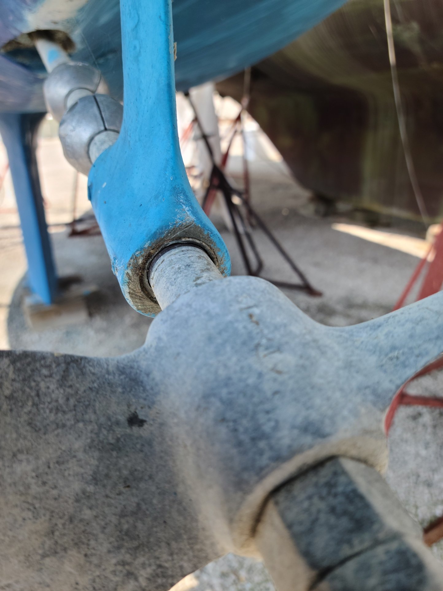

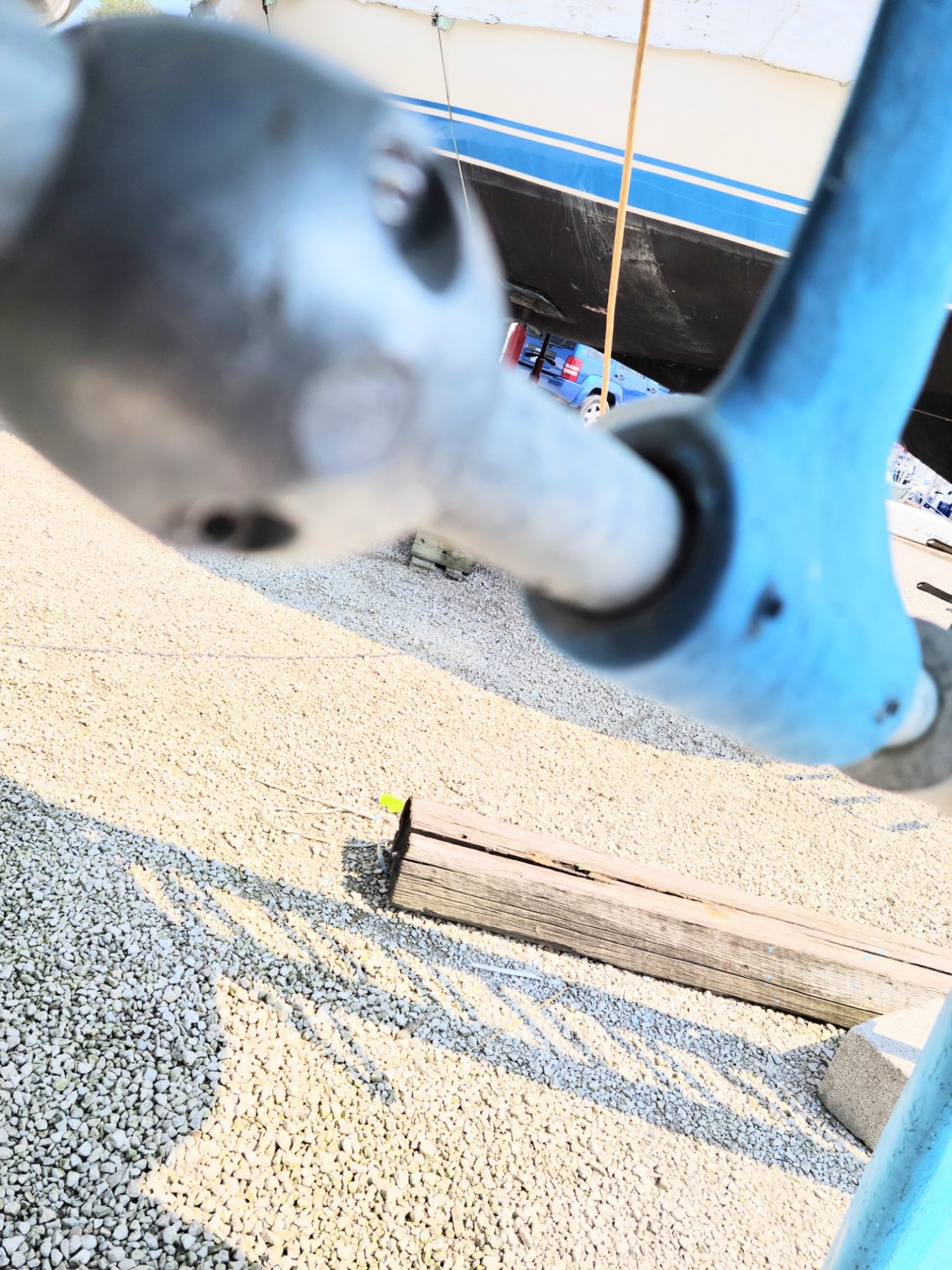

I had the survey for insurance and one of the items is that the prop might be misaligned. On the back side of the shaft, you can see a small gap while on the front side there is no gap. The size on the back side? I don't know really, but if I had to guess - about a 10th to a quarter of a mm.

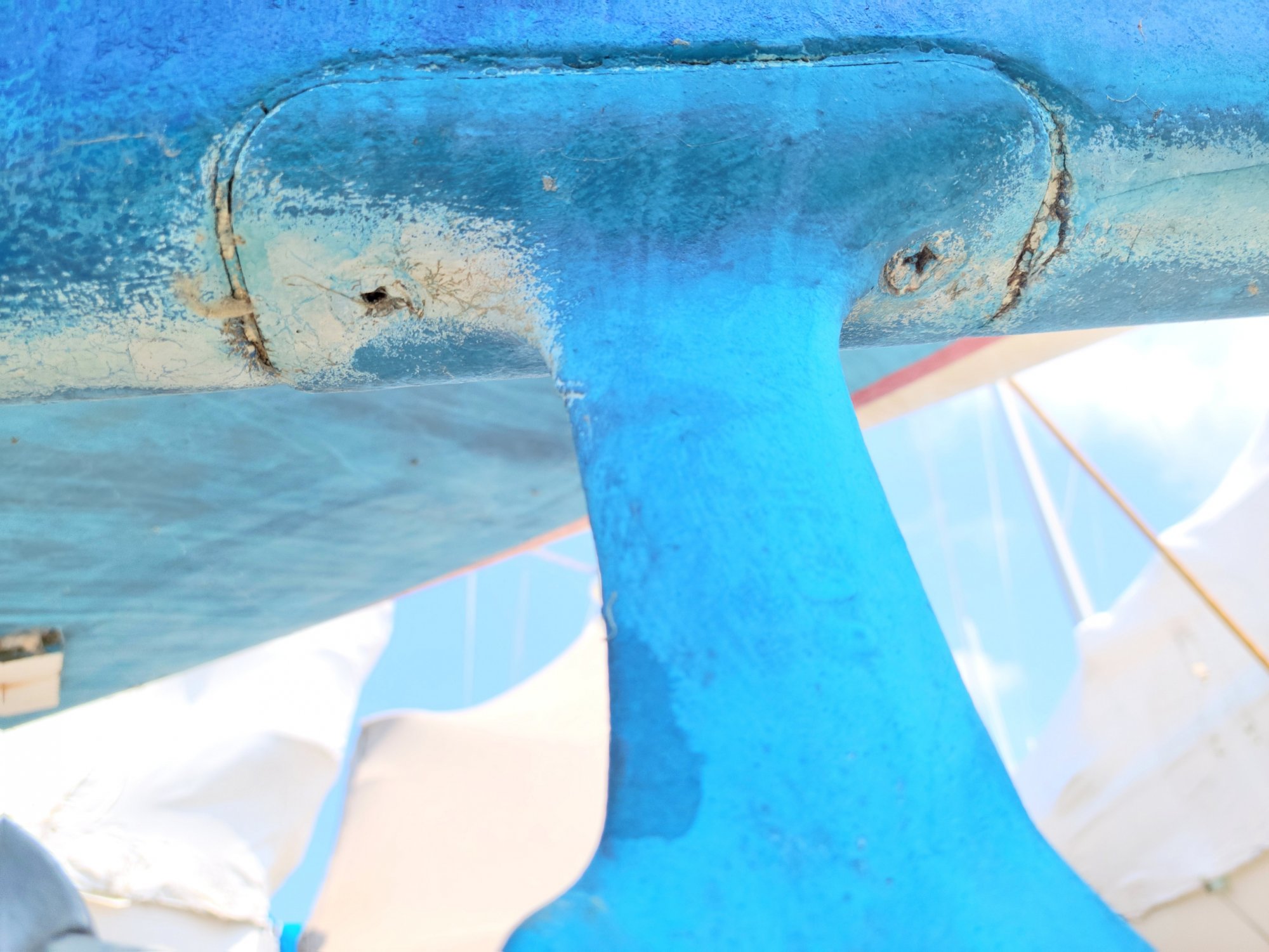

Took some pictures this weekend while I was working on the boat this weekend. I didn't notice, but the front of the strut image isn't all that great. It should show a smaller gap under the shaft and an larger gap above.
