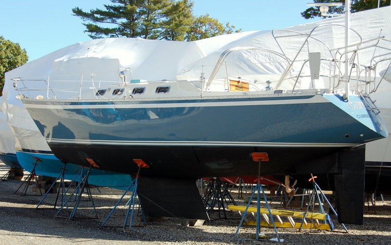

I had very good luck with Colinite Fleet Wax #885 on gelcoat and currently use AwlCare on my Alwgrip finish. I had zero rust at the water line this season but my un-waxed dinghy well........
She came out of the water on Friday afternoon Oct 11 and I took this photo Saturday morning Oct 12. This is untouched other than the boat yard pressure washing the bottom. I do plan to wax her before winter but as you can see the AwlCare, applied last April, did a great job of preventing rust stains at the waterline..

I have a similar stain on both sides of the bow of my Hunter 30 "DreamBoat". We "cleaned" the hull with Zud at last haul out (June 2008) and waxed the entire hull. Within weeks the stain was back. I cannot wait to try your process. That's a beautiful photo, by the way. DreamBoat is 26 years old, and we have had her for almost 5 years. She's a good old boat, but doesn't look anywhere near that good.

That Boat Looks
Better coming out Maine Sail than mine does going in. How in the world did you do that to it? That is a gel coat with the color in the gel, isn't it?
Regardless, she looks brand new, if you aren't proud of it, you should be. I don't know if I have ever seen a boat with a finish that pretty :).

She's not gelcoat..
Tom
I wish she was gelcoat but she's not! It's Awlcraft 2000 which is a two part acrylic paint similar to Imron..
