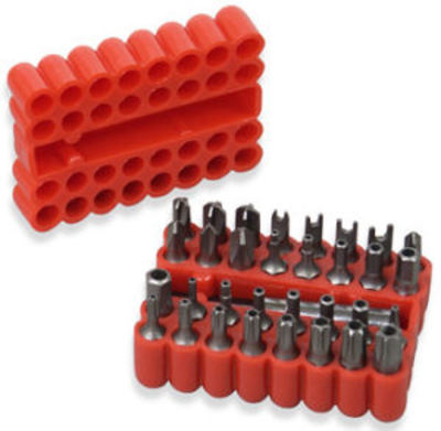

My nav pod uses security torex screws. torex with a pin in the center. You can get a complete set of bits at Harbor freight for about 10 dollars. The security torex are becoming very common on autos, plumbing items, electronics, home appliances.

I bought this entire set for $5.00 at O'Reilly Auto Parts (formerly Kragen's, formerly Grand Auto, etc., etc.) Its got them all for license plates, boat electronics and more.
