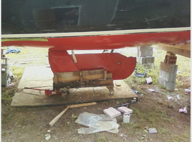

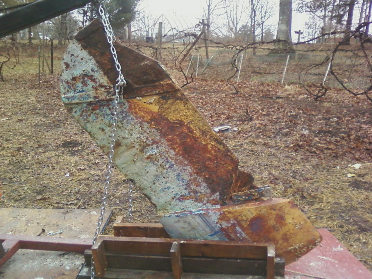

I've removed the keel on a Mac 21, A Rhodes 22 and a Balboa 26. On the Mac 21 and Balboa 26 there was a bolt that sent through the keel trunk. The keel trunk is inside the cabin.... I suspect yours is the same way. On the Rhodes the keel trunk sat under the boat's hull. You will need to block up your boat and get it off of the trailer. then build a dolly on wheels to support the keel ... jack the dolly up under the keel and take the pressure off of the keel bolt. That is a tricky step because you need the pressure on the bolt to be neutral or you won't be able to pull it out... so get a friend to gently raise or lower the jacks until the pressure is off of the bolt. Then pull the bolt, lower the keel and inspect.
The pictures are from my Balboa 26. That keel weighed 1200 lb. Yours is going to be a lot lighter... probably less than 400 lb. So you might not need the engine hoist. Maybe a picnic table to set it on ... and a buddy to help you lift and set it on the table.
