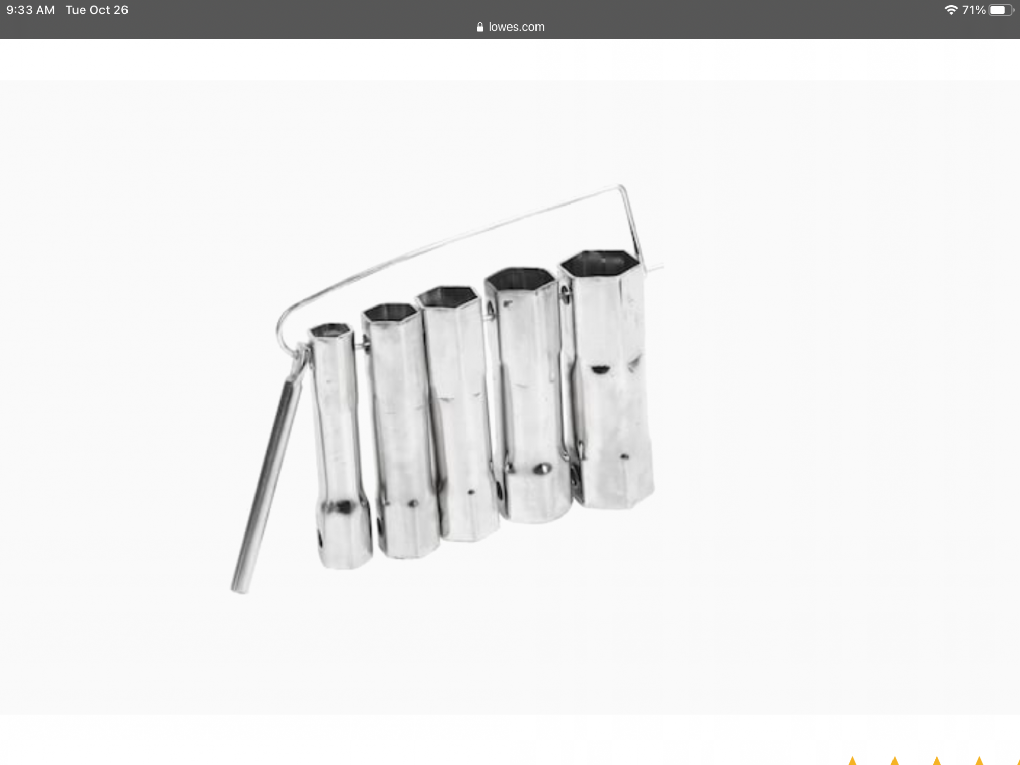

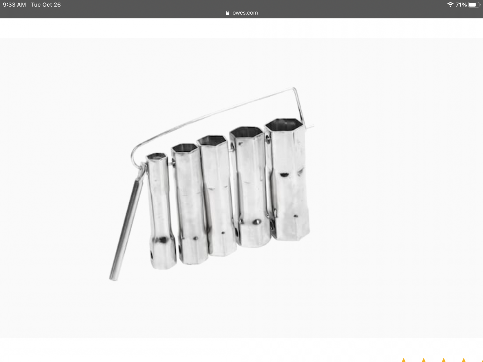

@JamesG161 I have one of those for years, used it once and it doesn’t work well. Better in concept than in practice. (Also not size appropriate for this thread).

Ideas? I keep thinking there must a sleeve like socket that would mate with it to tighten and loosen, but searches are empty.
