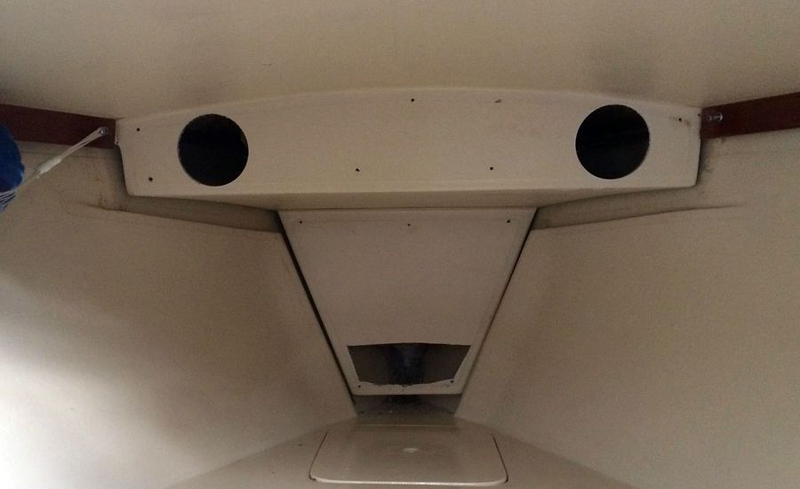

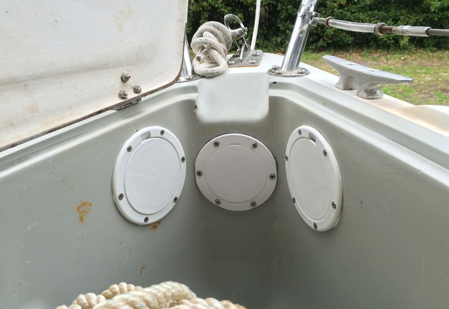

I installed ports on each side to rebed (and reinforce!) the cleats, as well as give more access to the forward pulpit legs:

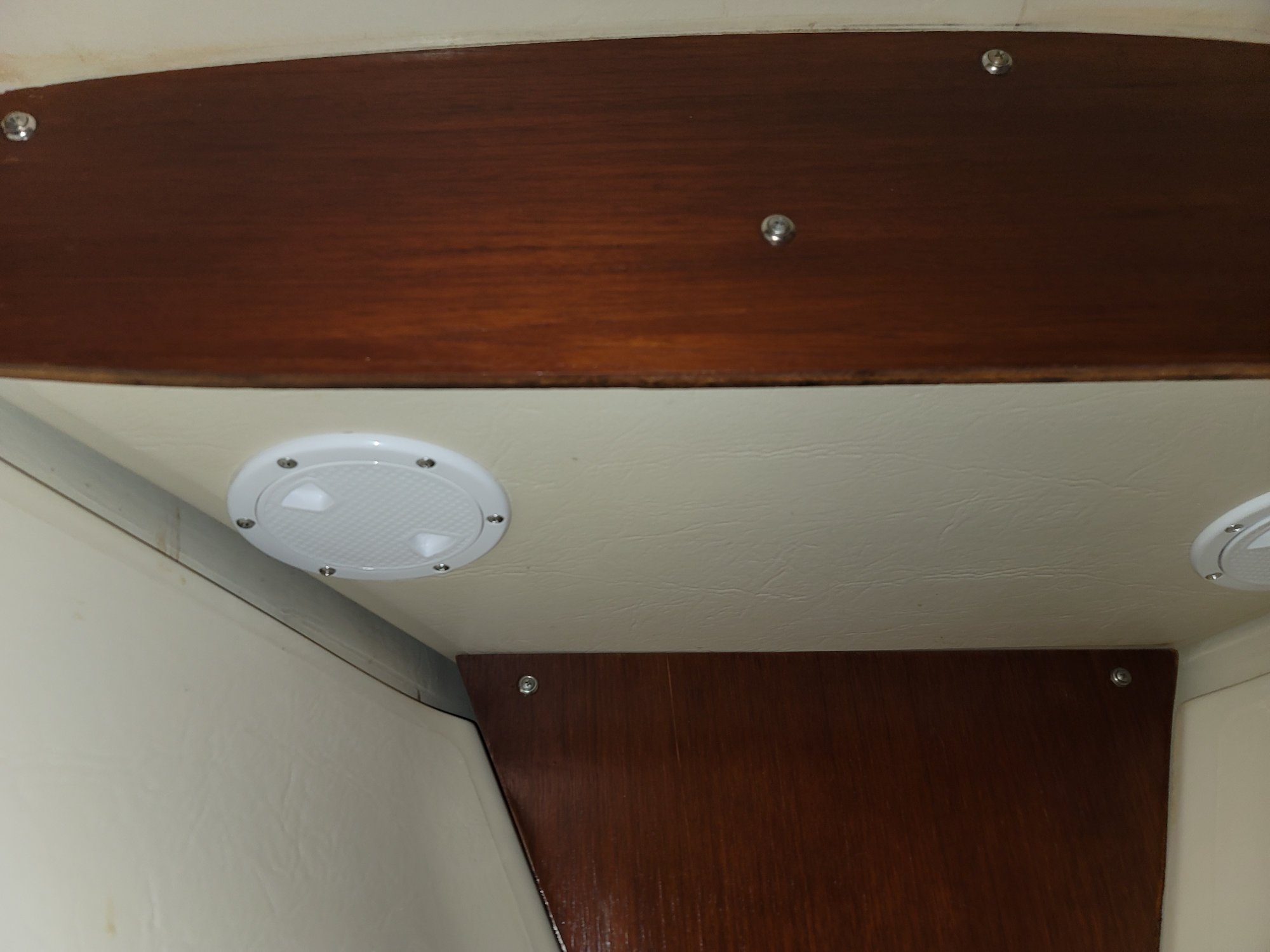

I drilled these round holes to access the aft pulpit legs, but then I found out they weren't really necessary because ...

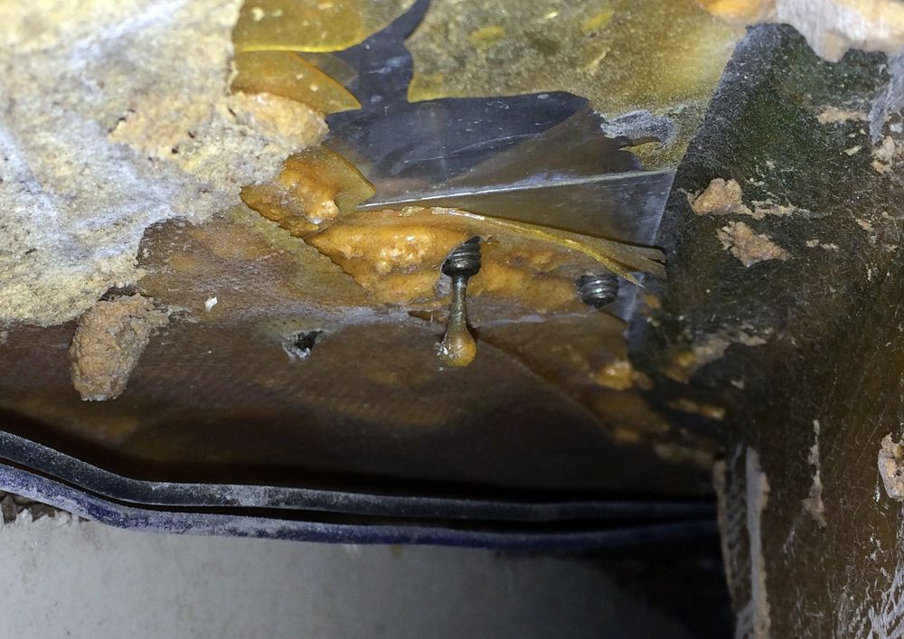

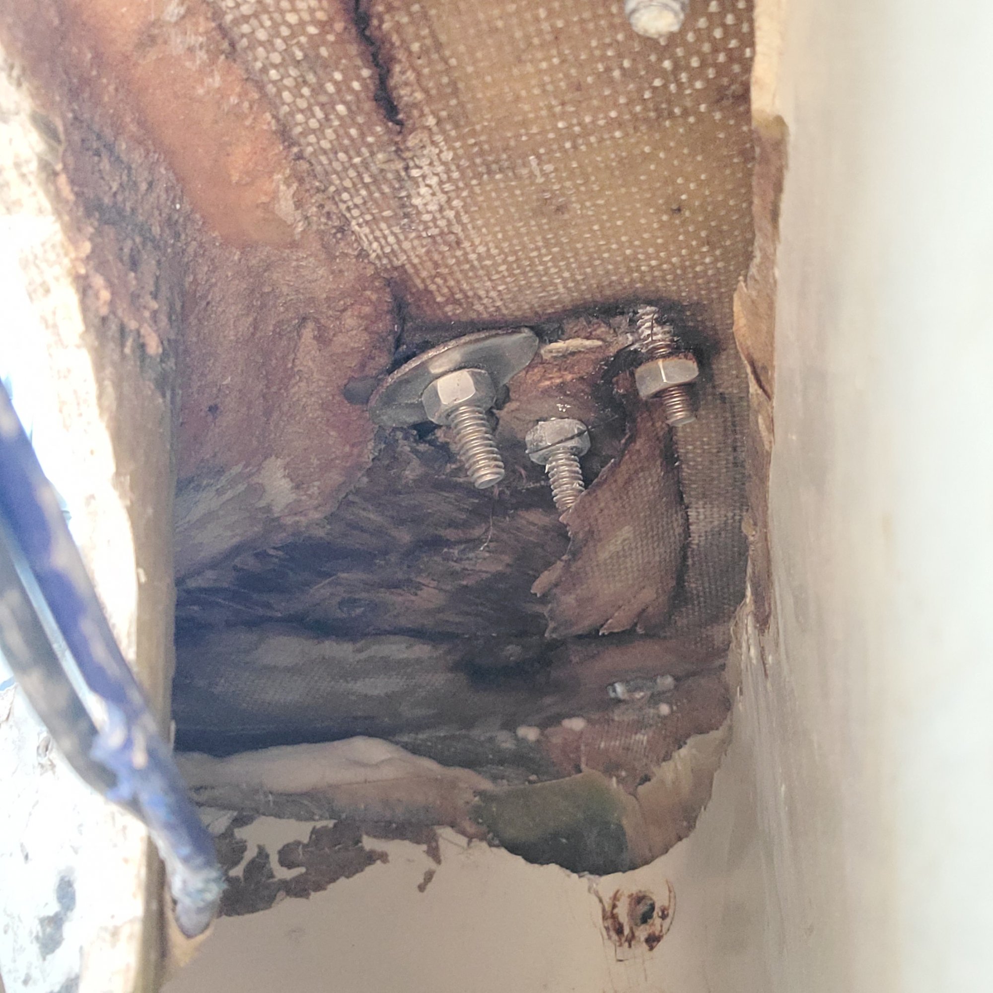

... the aft legs don't have any nuts under them, just these thin stainless plates, somewhat "imbedded" under the deck.
Any idea if those plates were original? I can't imagine how they would get those in later without the inspection ports you had to add to see them.
Sep 30, 2013
3,646
Yes, they have to be original. There's no way they could have been put there after the hull and deck were joined together.

Embedded plates are known to seize due to corrosion. I guess that's why Catalina switched to lag bolts which came with their own issues of loosening up
