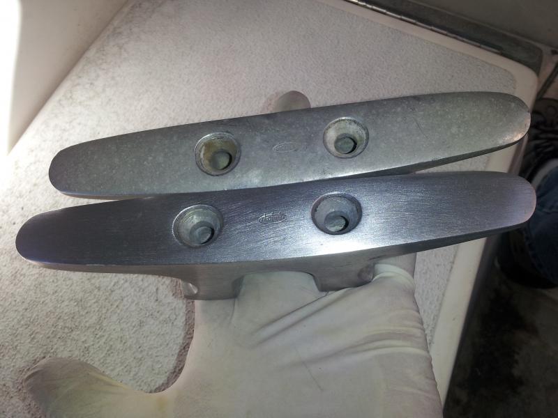

I pulled my stern cleats off over the weekend to rebed them since at least one of them had started leaking after Hurricane Sandy, and took the opportunity to clean them up a little.
Actually it sort of happened by mistake as I was trying to clean the bolt holes out with a SS wire brush and it started to clean up the area around the bolt hole, so I just ran with it and kept going.
While they have a great brushed look now, I am a little concerned that they will corrode faster as a result, and wanted to see if there was anything I should use on them to keep them from corroding?

They need to be anodized. The wire brush I assume was made of steel wire? At a microscopic level you have contaminated the base metal of the cleat and they will corrode rapidly. Part of the anodize process is to remove contaminants from the surface and then create a relatively hard protective coating on the surface. Without this treatment and in the presence of salt water they will corrode fast. Aluminum is a highly reactive metal (that's why it is such a good conductor) so do the right thing and get them in a shop and anodized.

They need to be anodized. The wire brush I assume was made of steel wire? At a microscopic level you have contaminated the base metal of the cleat and they will corrode rapidly. .
The brush I used was Stainless, I would never use a steel wire brush anywhere near a boat (unless cleaning an iron keel, which I don't have)

The proper name for stainless is Corrosion Resistant Steel (CRES). It is steel with a bunch of chromium and nickel that give it the low corrosion properties. But it is still 65% iron. Again at a microscopic level some atoms of iron will likely be imbedded into the surface creating sites where corrosion will be accelerated. Part of anodizing is to remove this surface contamination. Just like in passivating stainless steel imbedded contaminants must be removed first. Abrading the surface with a non ferric (iron) material should physically remove the contamination, something like a scothbrite brush or a nylon abrasive brush.
Coat the screws with zinc chromate primer to protect the interface from corrosion when you install them. This is pretty standard in aerospace when they install helical coil inserts into aluminum housings, the inserts are typically coated with primer at installation.
Most metals don't want to be in pure metallic form (except gold, etc.) and are created by taking ore and freeing up the iron or aluminum atoms by breaking the bonds under high temperature. So metals are in a high energy state and they are doing everything they can to get back to the nice low energy state that they reside in the natural environment. Anodize, passivation, chromating, etc. help slow this tendency to return to a low energy state. I used to explain to folks, take a walk in the woods, how much metal do you see?
Anodize won't cost much, they can throw it in with other work getting done at the same time. Just find a plating shop near you and they should help you out.
