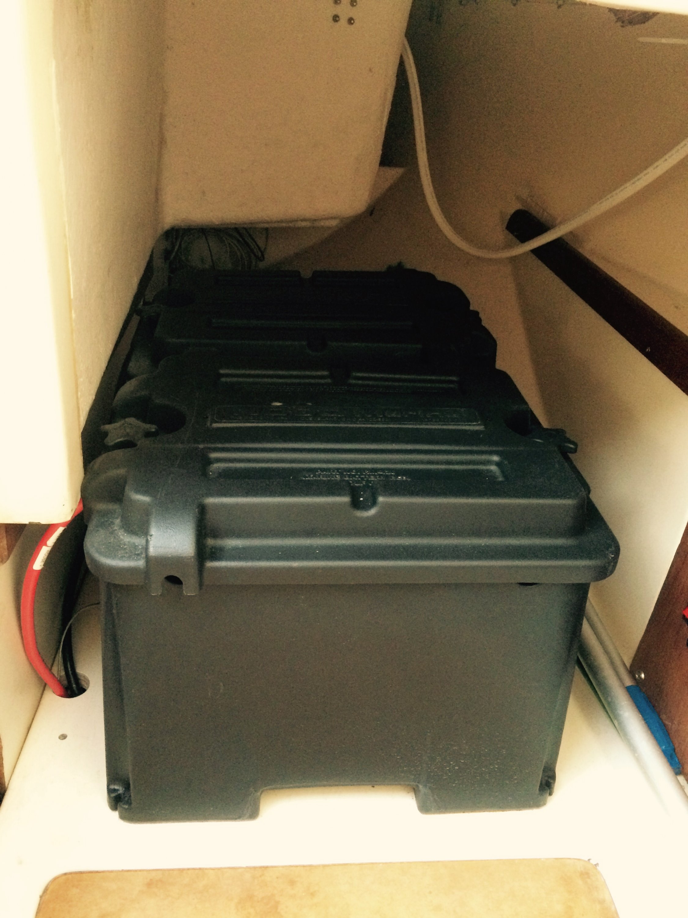

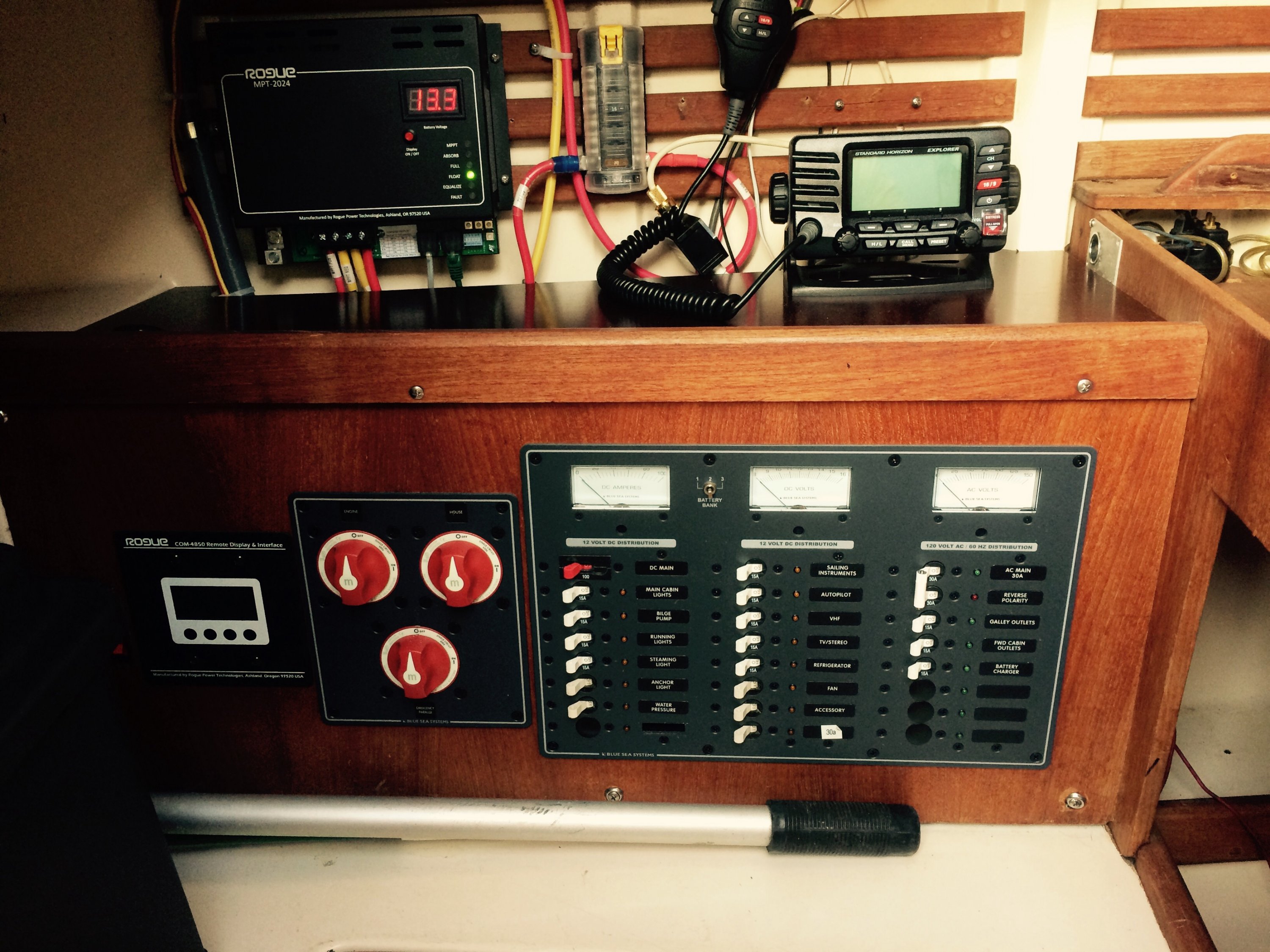

Slightly off topic question. I have a new boat with 4 new AGM batteries. 1 Start, 2 House, 1 Bow Thruster. The boat is going on the hard for the winter in Havre De Grace MD. The boat will not be hooked to power while out of the water. I was planning to pull them and keep them in my heated shop on a battery tender. Is pulling the batteries a good idea / necessary??
We have the same setup in the same location. Last year (our first with this boat), I made the mistake of not disconnecting the house batteries for the first few weeks of winter. Came back to nearly dead batteries. Turns out that the panel itself draws a significant amount over a matter of weeks. After that I disconnected the positive cable from the house bank, and just came back every few months after to run the charger for a few hours. There was no significant drain from the engine or thruster batteries. My understanding is that the self discharge rate of AGMs is pretty good to begin with, and even better in cold than warm. Of course I defer to Maine Sail if he replies with anything different.

I spent yesterday going over the boats electrical system. As far as the batteries are concerned I was wrong about the total number of batteries. There are 2 start, 3 house, and 2 thruster / windless batteries. So it looks like what you guys are saying is after fully charging turn the red battery and black ground switches to off and disconnect the cables from all the batteries and I should be good to go?
