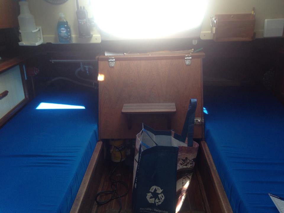

Bad picture but it gives you an idea of the area.
So the cabinet would align parallel to where the cabin meets the deck (right above the plastic sprayer bottle). That would be the bottom of the cabinet. It would go over about 15" from there.
The thing that I am trying to measure is the back of the cabin to make it fit the bulkhead there.
Another question. I bought a mirror, 1/4" plexiglass which is 12" by 12" in size. That will be my door for the cabinet. I thought of framing it into wood but I may not do that. I could probably cut it to size of the cabinet and attach the hardware into it (it should be strong enough for that). Still, I have to cut the plexiglass. Anyone know how hard that is and what to use?
all this time i thought you were mounting to the side of the hull .....take a framing sq and set it on the under side of the companionway trim short leg up ...then measure the distance form the long leg back the the bulkhead at the bottom then you have your angle for the wall side

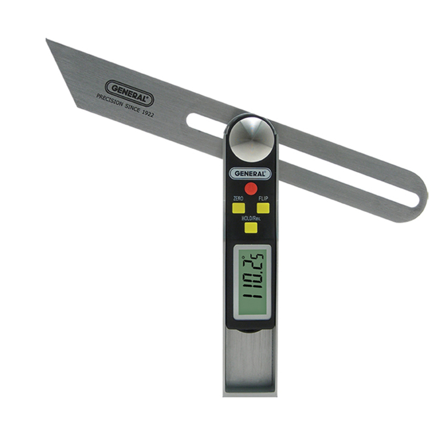

2nd stab at it...now I see what you want (fore and aft angle). I would pull the seat cushions off, use a large square (or an extension on a large square), and an angle finder and get the angle between the long leg of the square and the the bulkhead, using the seat area as a base for the square, since the seats should be more or less on the level line of the boat.
You could probably also get the same angle measurement from outside the boat by placing the square on the cockpit seat and measure the angle between it and the back side of the cabin wall.
