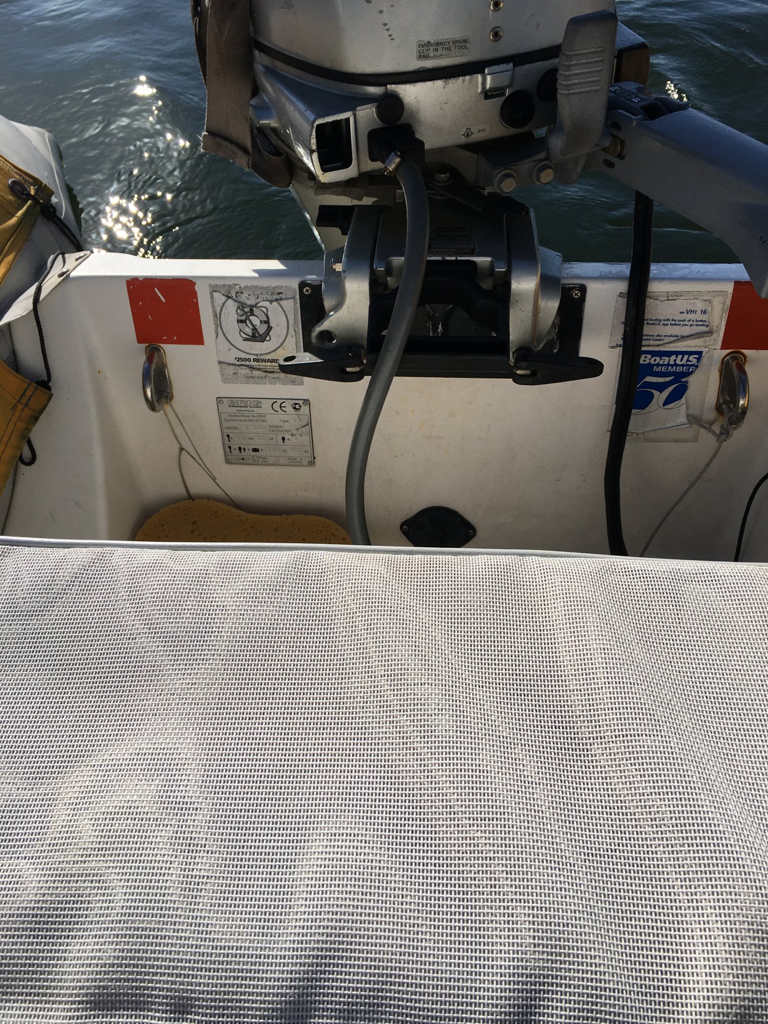

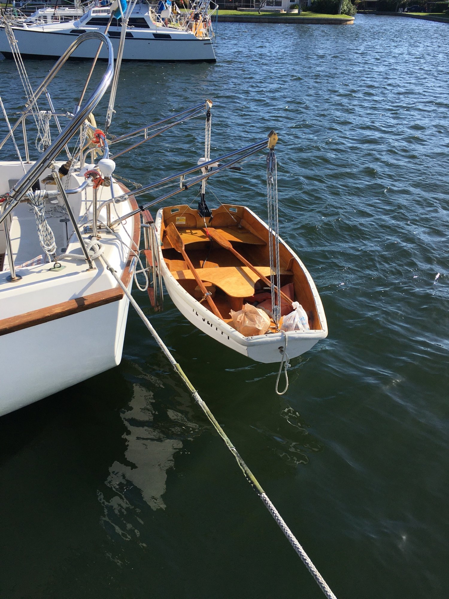

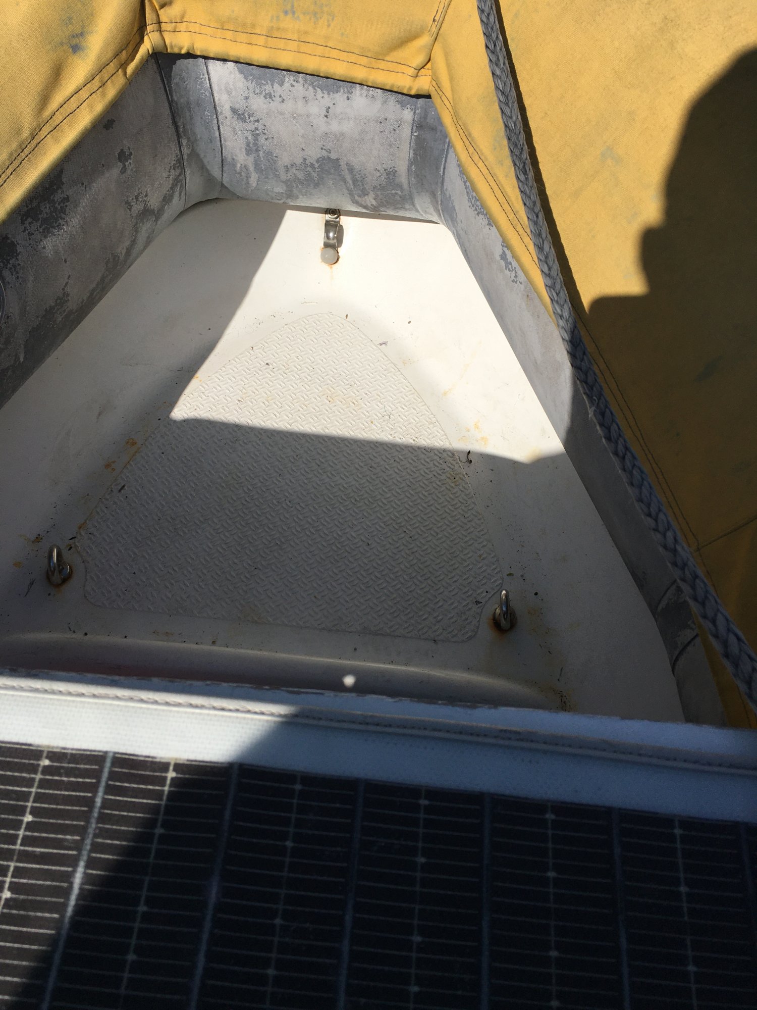

For your stern you said you added two U-bolts, mine are bow eyes so they are affixed tightly. Then at the bow itself does your boat have a bow eye to tow it with? Do the threaded ends protrude through into the dinghy and have nuts showing? There I have a strap eye under those nuts creating a lift point. The PO also added two points into the bow floorboard so a three point harness lifts the bow and a two point harness lifts the stern. He made a spreader bar which hauls the dinghy up level if two men lift it together. Someday, if the saints are smiling, I may have an electric winch to do the lifting.
I’ll get a picture when my coffee’s done.
438560FC-3CC2-4309-B9E2-D399DF7B6775.jpeg5C80A5EA-2120-4193-839B-76D7A4AE72CB.jpeg521500AE-0AA8-4540-9A5A-F62EC99DA772.jpeg98206A2B-0D43-46B8-A2F4-87918BD04C3C.jpeg
I added the boat rafted with us.
