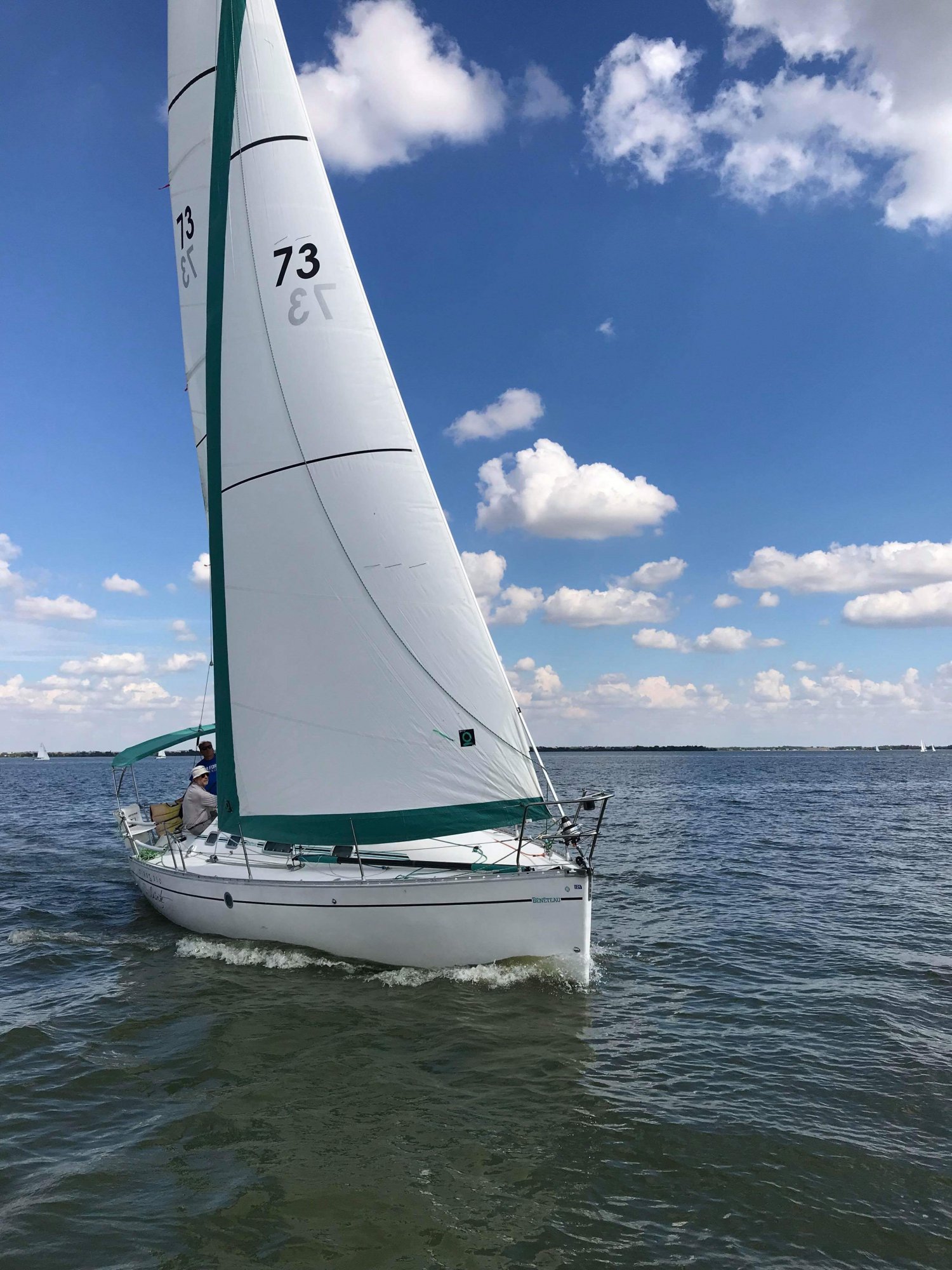

Do you have sets of telltales toward the luff of the jib? See the photo, we have three sets, one low by the sailmakers logo, one mid and one just above the sail number. Your 90 degree tacking angles seem awfully wide to me for a J-88. Perhaps you are not sailing as close to the wind as the boat can, "footing", and losing distance in the angles rather than being slower.

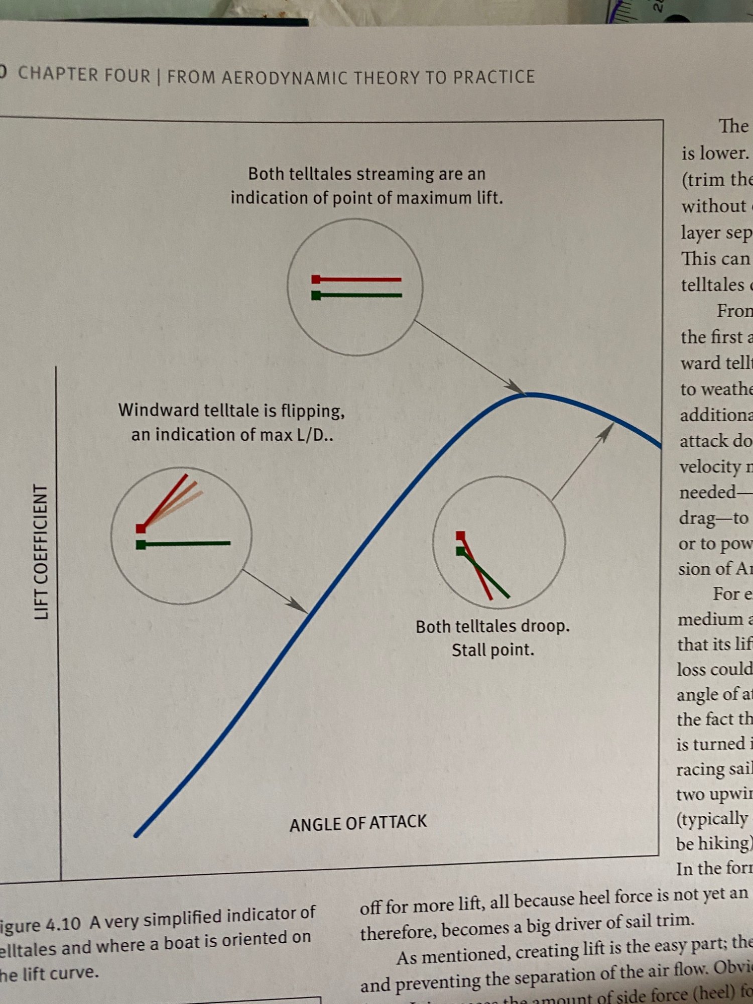

Arvel Gentry worked on the connection of aerodynamic theory to practical application on sailboats back in 1971. His work can be seen on his website. Gentry Sailing | Theory and Practice
A current update applying the ideas to sails can be found in the two additions of "The Art of Science and Sails" by Tom Whidden and Michael Levitt. They use Gentry's concepts and develop the building of North Sails based on Gentry's work. Their first edition is a bit more pure. The more recent "Revised Edition" includes the marketing of North Sails and pretty pictures to distract the reader.
One of the illustrations that might be informative concerning your tell tails...
It would be nice if getting a boat to go fast was as simple as watching a tell tail.
Gentry's work opens your eyes to all of the elements that can confound the sailor as they seek optimum performance.
