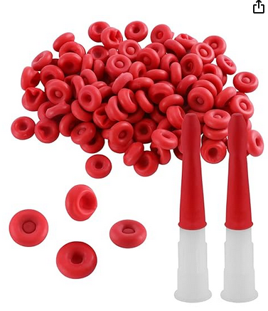

I bought some of these roll-on tube caps on Amazon last year. I just used the first one, so I can't say how they work. But it looks promising.
They fit very tightly.

WOW... they look like Condoms for Caulking tubes..:laugh:
Hold back the GOO..:yikes:
Red is a great color.:biggrin:

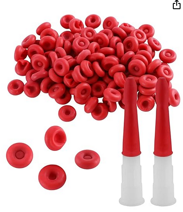

The problem with polymer seals (including duct tape) is that polymers are gas-permeable, even more so when stretched. Note the helium leaks out of rubber balloons but NOT aluminum-coated mylar balloons. This is why aluminum foil is preferred.
For sealing cans of paint with damaged rims, use aluminum duct tape, for the same reason--solvents cannot permeate aluminum, but they can permeate polymer duct tape.
Year of experience. Even a thin metal layer makes all the difference.
