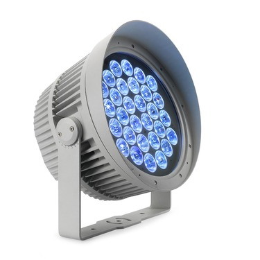

What I'm looking for now are called "up lights," I think. I have seen only one marketed as such, and it's for big yachts, and are about $300 each. They feature a 16° beam angle. They recommend mounting them on top of the spreaders, but don't say anything about the lights that would illuminate the lowest spreaders and mast below that. I imagine one would install a flush mount light in the coach roof.

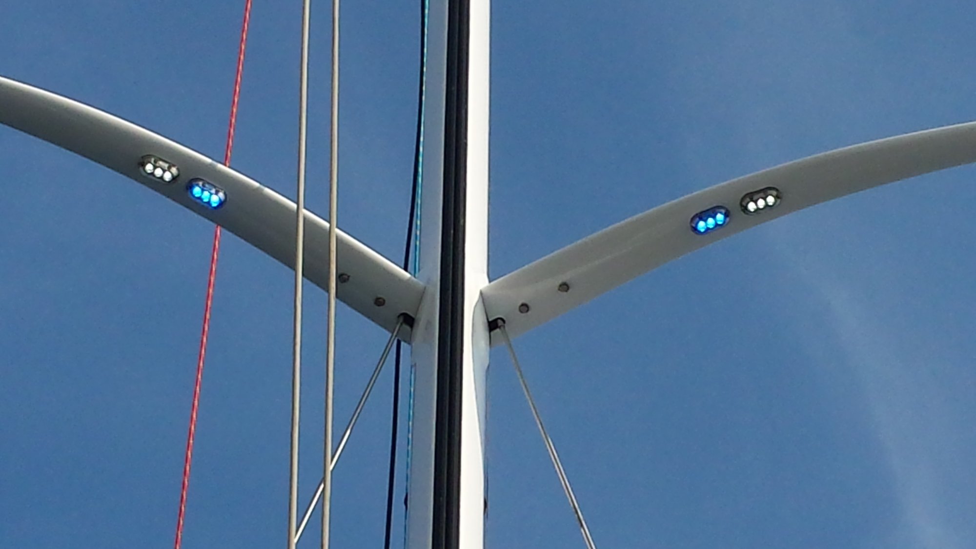

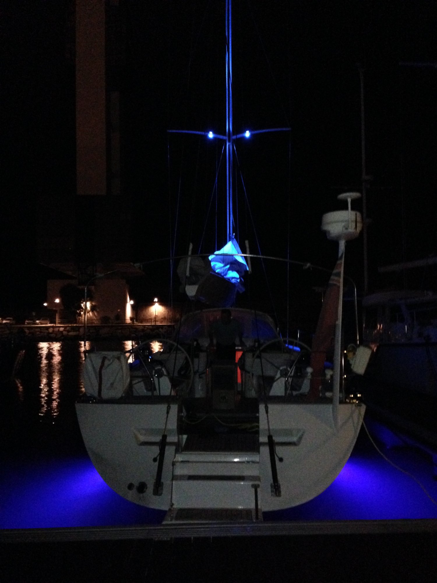

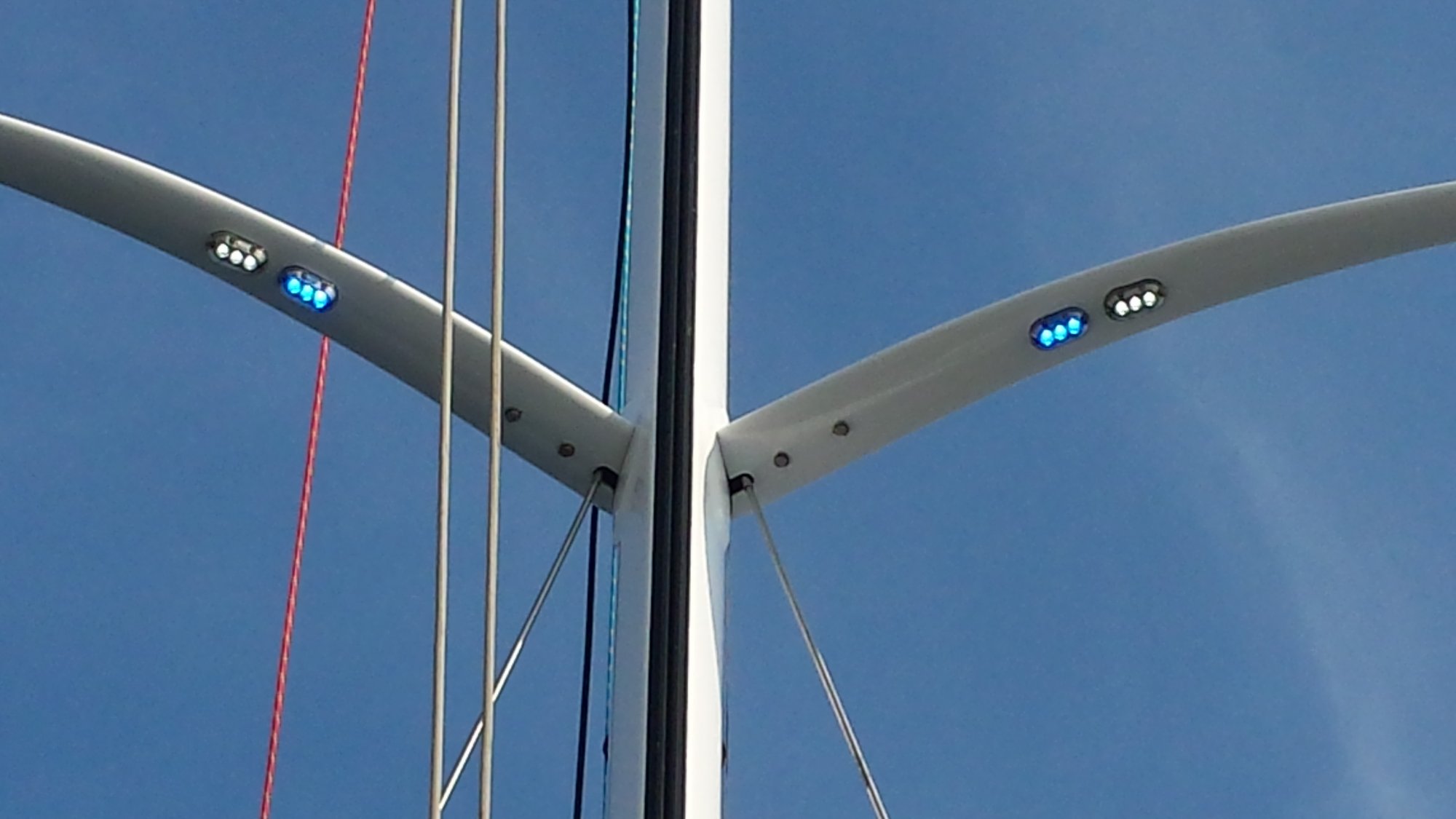

Common factory option now; blue LEDs seem less 'bug friendly', so you often see white and blue both installed, one for work, one for show. Some solid after market players as well; this outfit in the UK, but you get the idea.

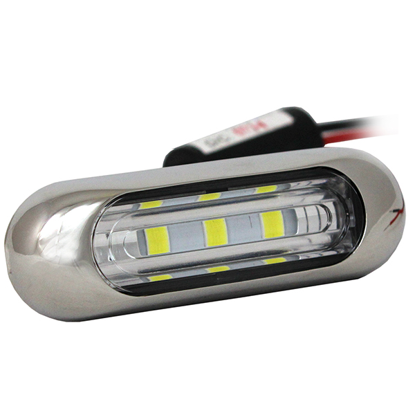

I see them all the time and think they're pretty cool, but I don't know what fixture they use. Defender has these;
Scandvik LED Spreader Light Item #: 701594.
I've seen running lights on the lower spreaders of more and more boats lately (pre C-19) and if I add anything aloft it would probably be those, for motoring.

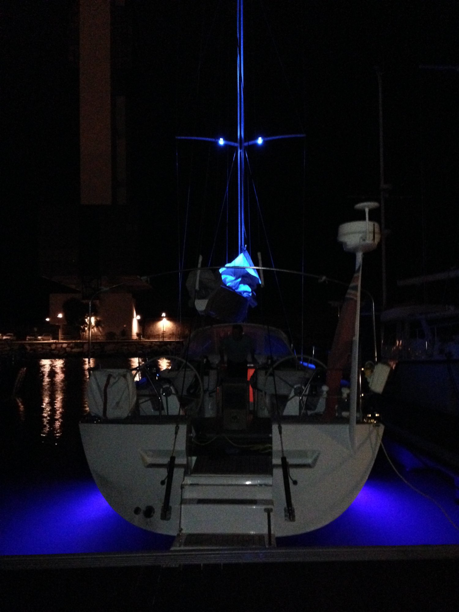

Next off season:
As @rgranger notes, I'm a fan of MarineBeam stuff. And I like the basic functionality of these. But compared to install on the Grand Soleil I posted above, these light look way too aftermarket, and the bulky bracket look tailor-made to snag a halyard. The flush-fit is much nicer; not just ascetically, but functionally.

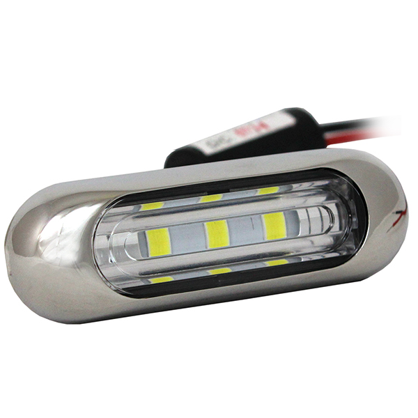

I think I've found what I want, which are flush mount, waterproof livewell lights, like these:
They are inexpensive and totally waterproof. I would toy with the idea of finding a tap for that thread, and drilling and tapping the spreaders for them. The only thing is I don't think I could bring myself to drill holes in the coach roof or deck!

Thats a HUGE hole for just a wire. I'd keep looking for a semi-flush mount unit that only runs wire thru the hole, and not the whole body.
12,909
I agree. Spreaders endure a lot of compression forces and I would not want to take that much metal out of the column.
Yes, it's a 3/4" hole for most of these.
