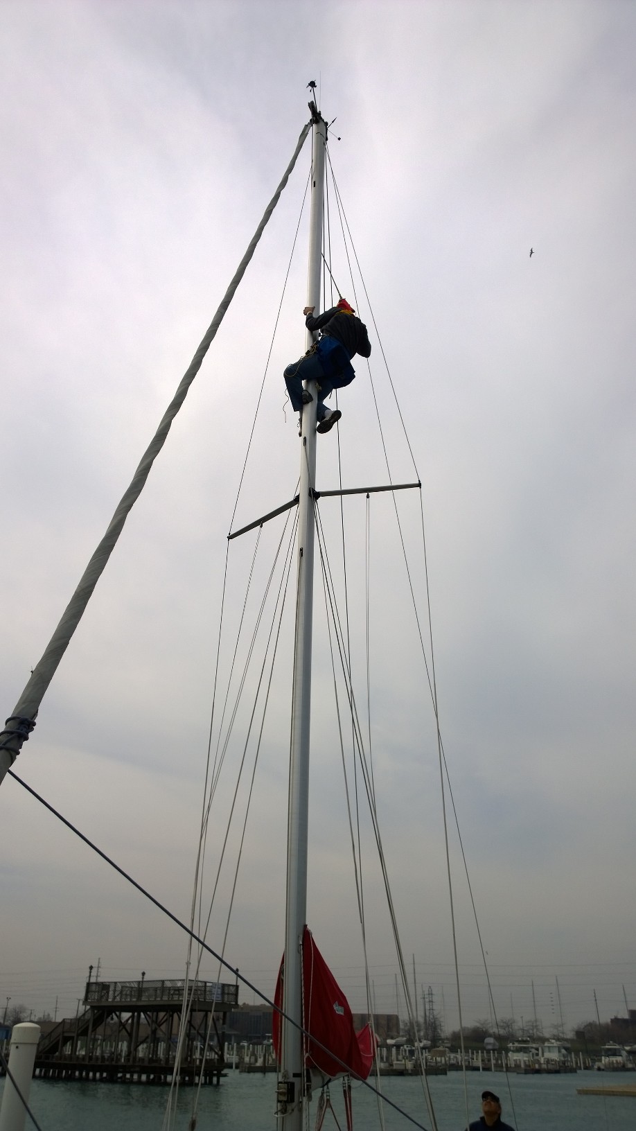

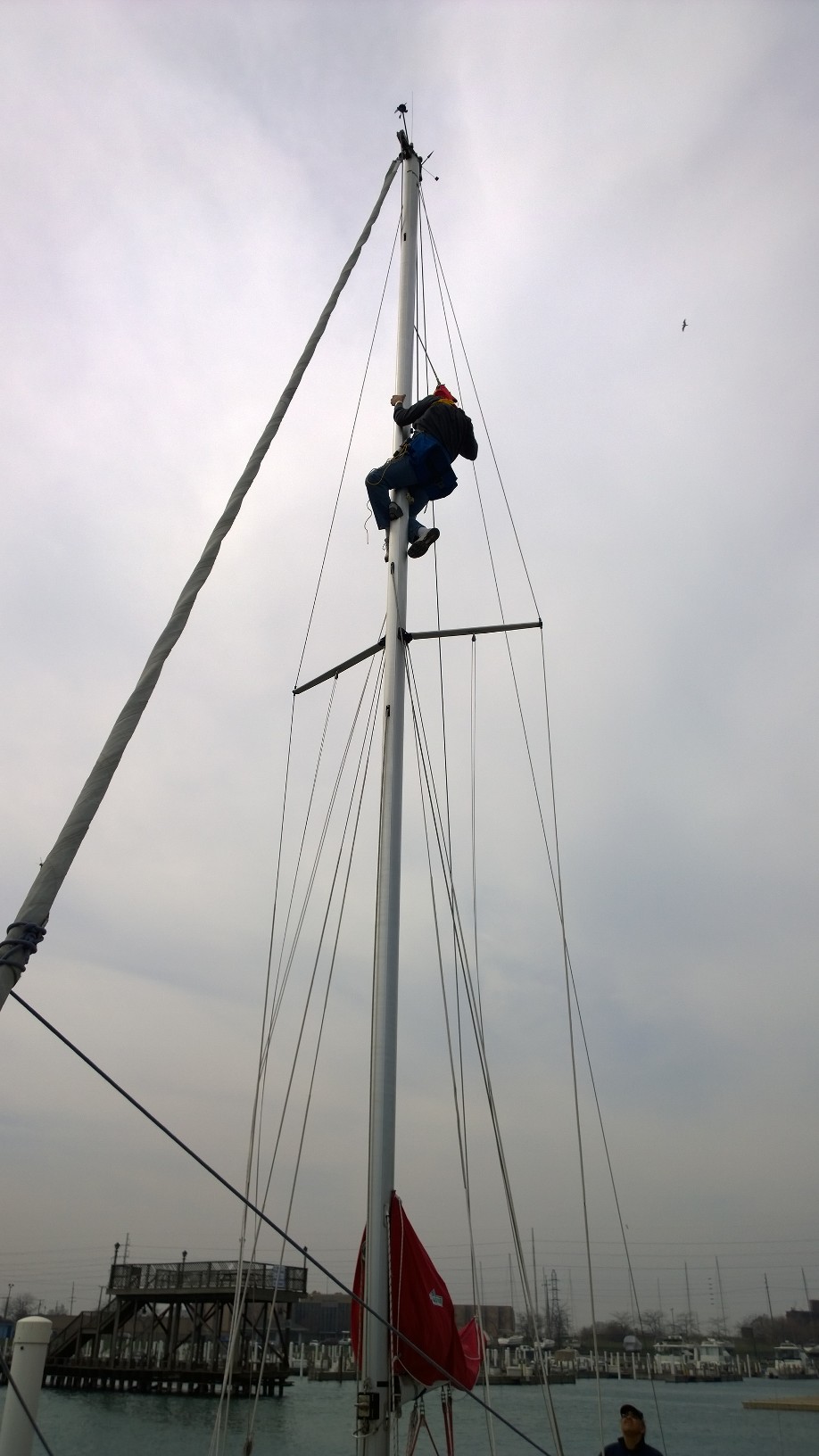

Rather than pay someone i instead purchased an ATN mast climber. I have IMF main but used the spare halyard as the main line and the topping lift as the safety line. Was able to climb to the top myself. Have a sloop rigged boat but i do not think a fractional rig would be any different as long as the spare halyard goes to the top of the mast.
bob
I think the OP posted that the problem is the Spinnaker and Genoa halyards on his fractional rig are about 3 feet below the masthead. We are assuming (possibly wrongly) that the topping lift (what he refers to as the boom halyard we think) may not have a readily available winch at the mast and may not reach to the cabin top or genoa winches. That second assumption is the key. We need to hear from the OP if the topping lift can reach a winch. Of course he'll have to support his boom somewhat and that may be a pain to do but it is certainly do-able. If the topping lift can reach a winch use it to hoist the person with the spinnaker halyard as the safety line. Alternatively Cat310 has a good idea.
If you can't get the topping lift to a winch buy an ATN mast climber like Cat310 suggests. You can hoist that with the topping lift unloaded and tie it off to a cleat. Its easy and safe and if you loose it before you cleat it off the only thing that falls is the ATN mast climber. Use the Spinnaker Halyard for the safety line and you'll only fall a few feet before the Spinnaker Halyard catches and you are good to go. Clean drawers are cheap. Just make sure you are securely in the bosuns chair so you don't fall out :yikes: in the few feet you fall (might be a good idea to have a harness on instead of a or in addition to the bosuns chair). Since you won't have the spare halyard at the top of the mast and your feet will be in the mast climber you'll probably need to tie off somewhere to keep you stable against the mast while you work with your hands unless you can do the job with one hand. Still a good idea to tie off to be stable. Like someone pointed out it sways a lot at the top of a mast unless you are on the hard and even more so if your weight is up there let along the idiot that throws a wake while you are up there. Good Idea Cat 310! Sometime it just takes a different perspective to find the solution that is not a Jury Rig. My point is that if you have to jury rig something, don't do it. The mast climber is not a Jury Rig. Depending on how old you are, how good your joints are and how height tolerant you are the ATN mast climber is a good solution. Its still not an "easy climb" but it is do-able and designed for that task.
