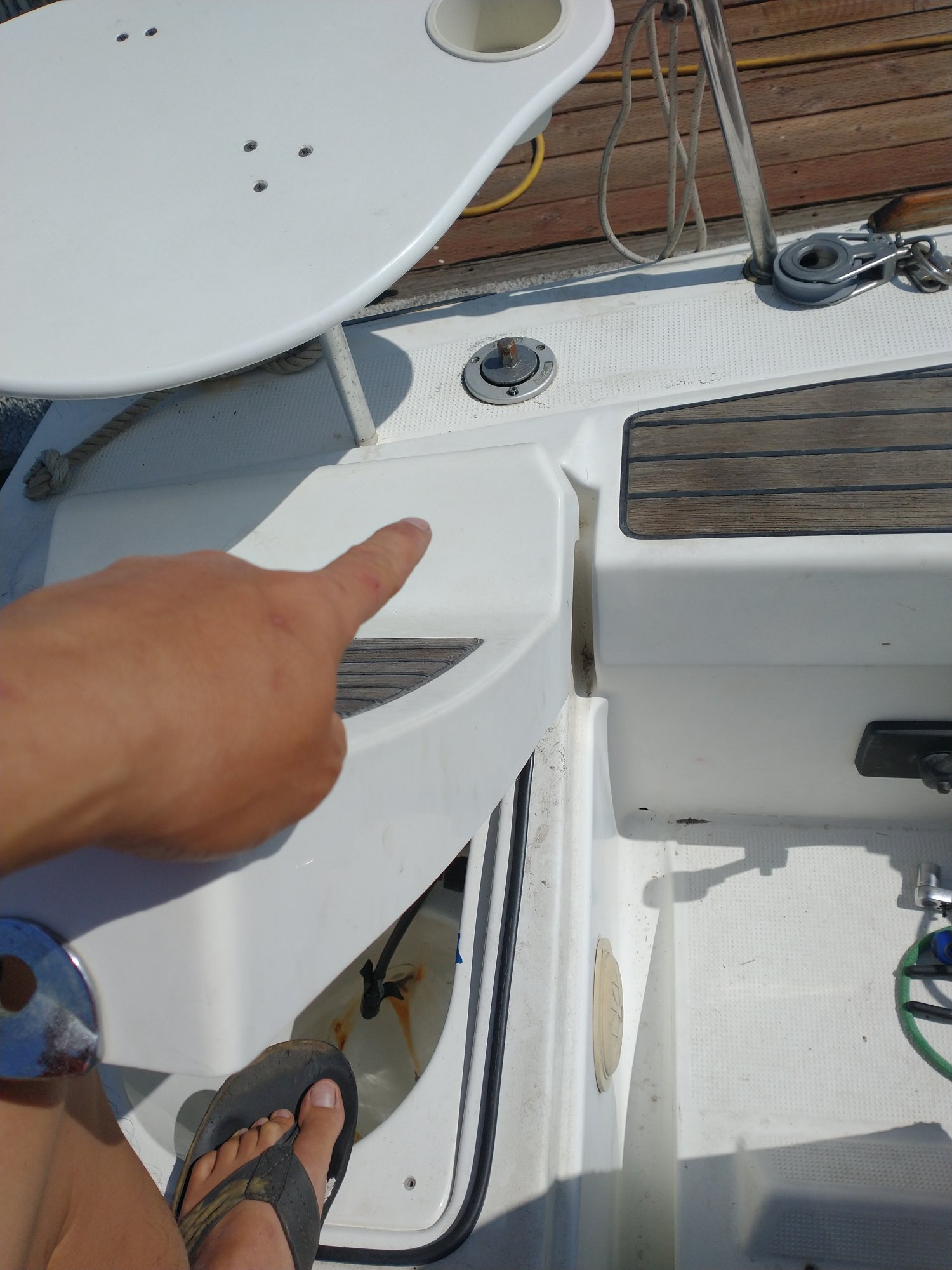

I'm trying to Change the fuel cap and seat ( on port stern deck) on my 2003 Beneteau first 36.7

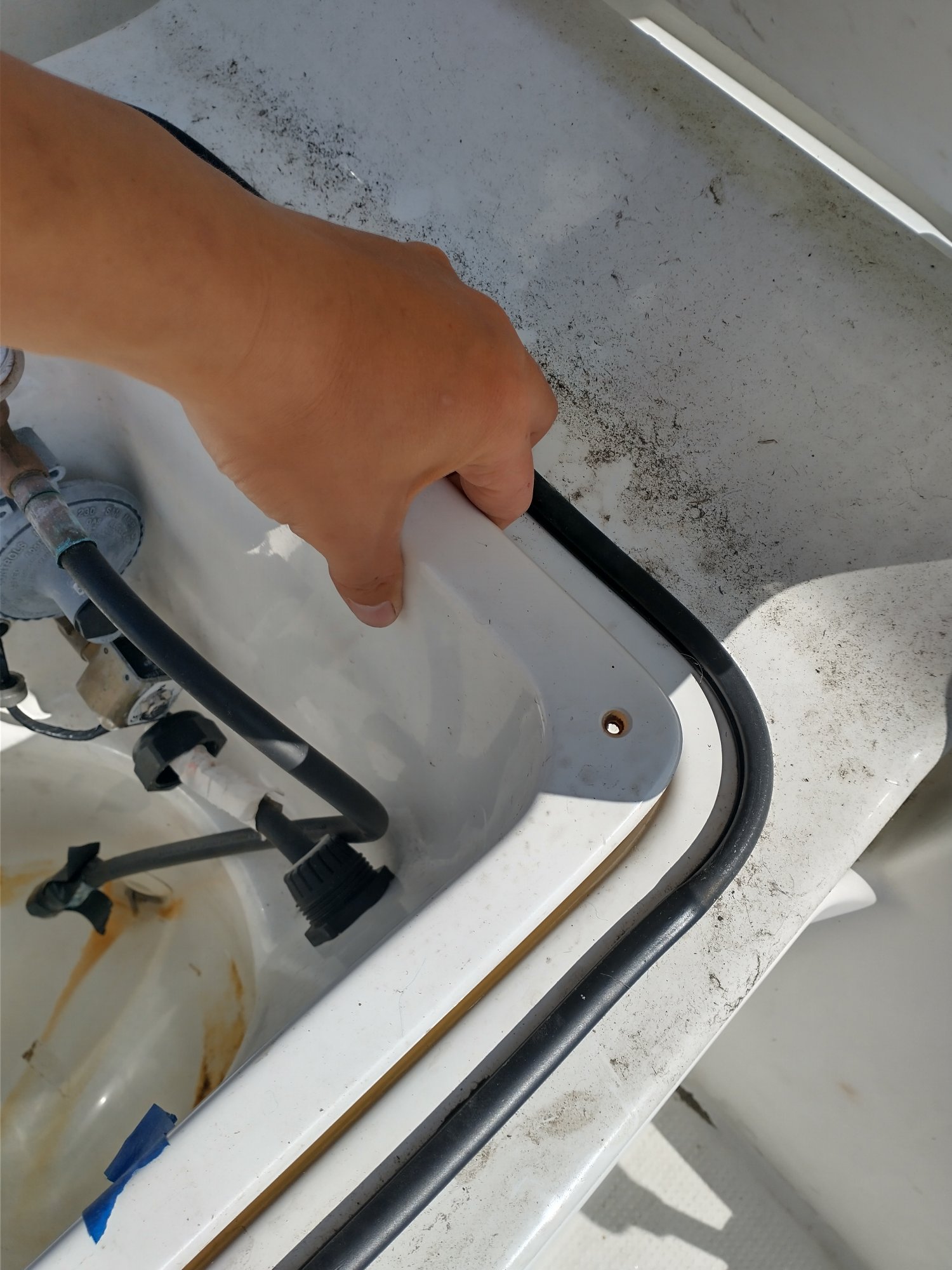

Since the seat is connected to fuel tube ( I guess is rubber , and secured by clamps?), I need to access the tube beneath. The port stern only has an opening beneath the propane tank bucket.
I disconnected the 4 screws on the propane tank bucket. But the bucket has a drain hole that's connected to a through-null on port stern side wall.
How can I cgain access to the port stern space, possibly by removing the propane tank bucket?

Can you access the vapor drain hose fittings through the small door at the back of the port stateroom?
Jun 21, 2004
3,104
Beneteau 343 Slidell, LA
Checked out mine a few days ago when the propane solenoid topic presented. Vent line for propane locker, on my boat, is accessible
thru the small door at the aft end on the port side of the stateroom. Also, a thru hull fitting & hose for the cockpit drain is present at that location.
