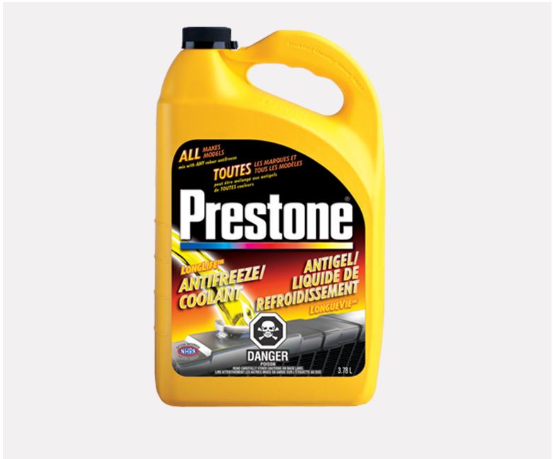

I find it easiest to change the coolant every two years with any well known (same colour) antifreeze such as Prestone. I choose two years due to having longs hoses leading to the hot water heater. This way I don't have to blow them out. Extended antifreeze is for those who don't want to change the coolant regularly.
Using distilled water ensures the antifreeze coming out is just as clear as the new stuff going in.
