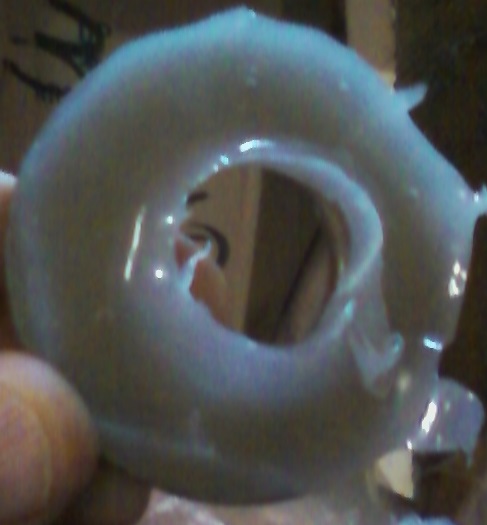

I made my own.....
Get a washer and use some masking tape to make a "dam" around the edge of the washer. Then fill it in with Goop (they sell it at Lowes and Walmart). Let the goop dry. It becomes a very hard rubber when dry. (see pictures)
In Pic#1, I had just removed the outer run of masking tape and you can still see the blue tape I used to protect the washer hole.
In Pic #2 you see the before-pic of the washer and if you look to the left you can see one drying that has been all set up.
In Pic #3 you see the final product. The goop drys hard and sticks very well to the metal washer. I then took a sharp knife and cut the edges flush where the goop had crawled up the tape walls. I should have snapped a pic of that but didn't. It turned out perfect and I had a nice flush rubber washer bonded to the washer.
It will take you 10 min. to pour the goop then go back inside, have a beer and watch some TV. Next day it will be hard and ready to use. Then put the rubber side against the keel trunk and tighten it down. Easy peasy and cheap.
