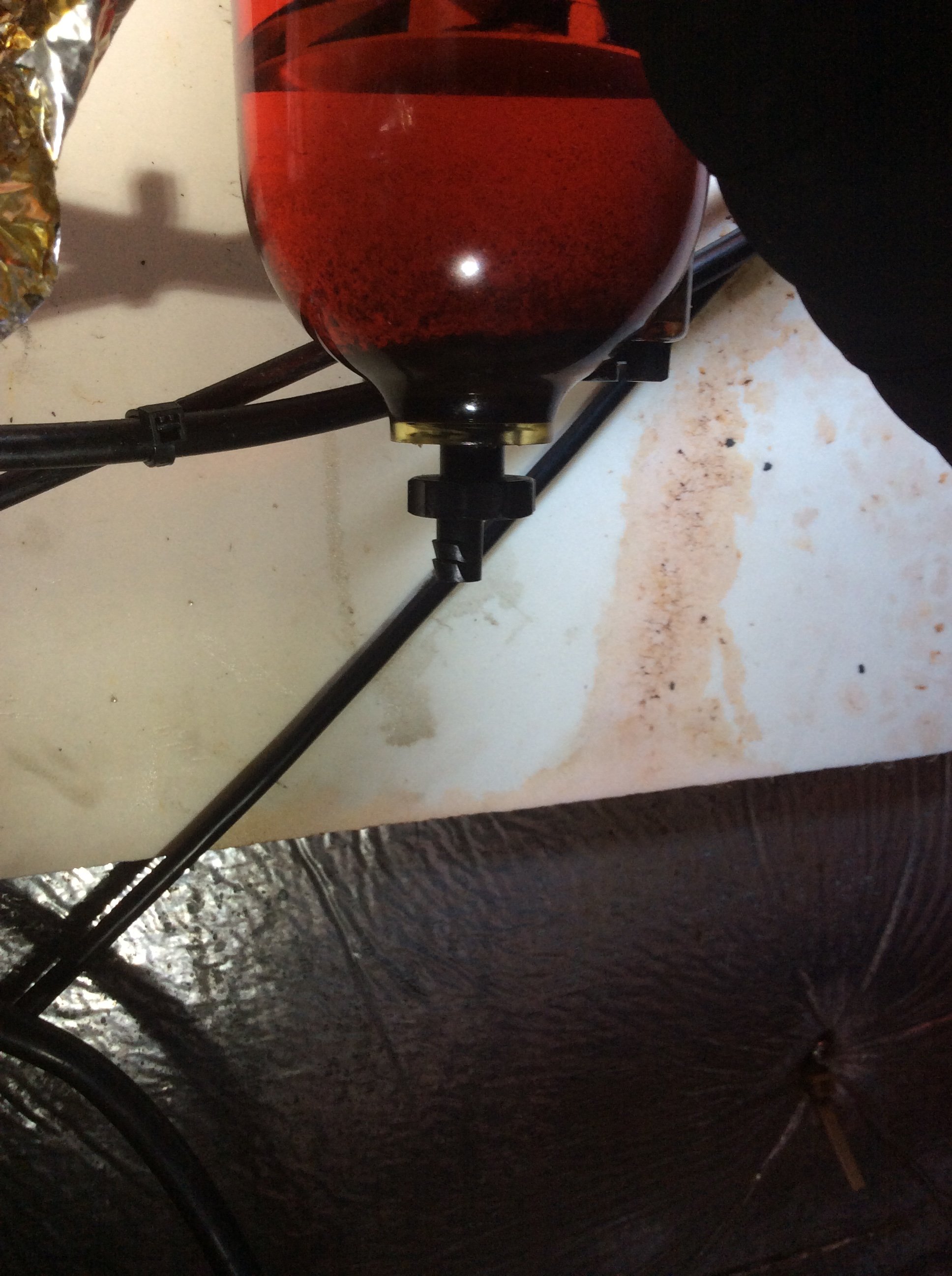

The end is serrated so you may attach a small hose to the end to direct the drained fluid to a container. Turn the valve counter clockwise to release.
Feb 4, 2012
95
LM 28 Pilot House Sloop Pilothouse Campobello Island & Fredericton, NB
On Tuesday I drained a Racor 200FG with a very similar drain and attaching a hose to that barb made it a very clean process.
Sis you drain out the crud without introducing air?
I am redoing my fuel lines and was also pulled the lines from the Racor body so breaking prime was not an issue for me.
