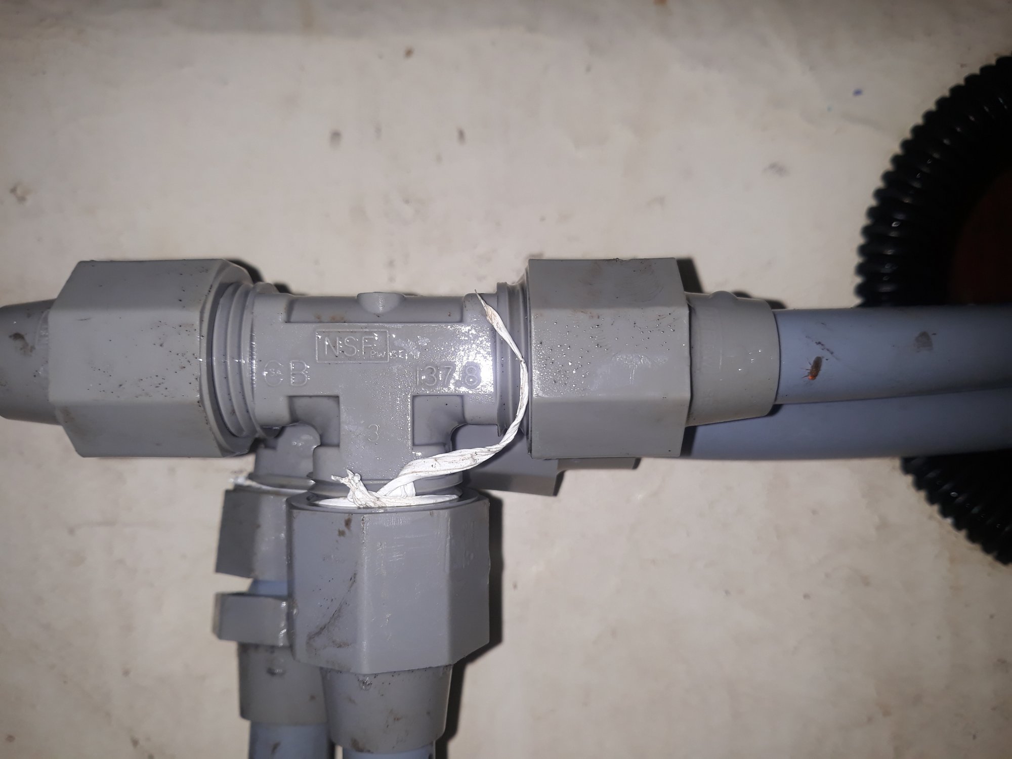

12
Hunter 40.5 Angra dos Reis
Hello Sailors
I own a Hunter Legend 40.5 1996. It comes with PEX piping. See pic attached.
I've found that chlorine affects PEX piping, but I am unsure if this is the case with all PEX or only the early forms of it.
What is your experience?
How do you disinfect water for those that have PEX plumbing?
Apex
Jun 19, 2013
1,229
C&C 30 Elk Rapids
grey tubing is likely Polybutylene. QEST fittings often used. That is now banned in home use, so finding fittings for the water system is difficult from my understanding.
