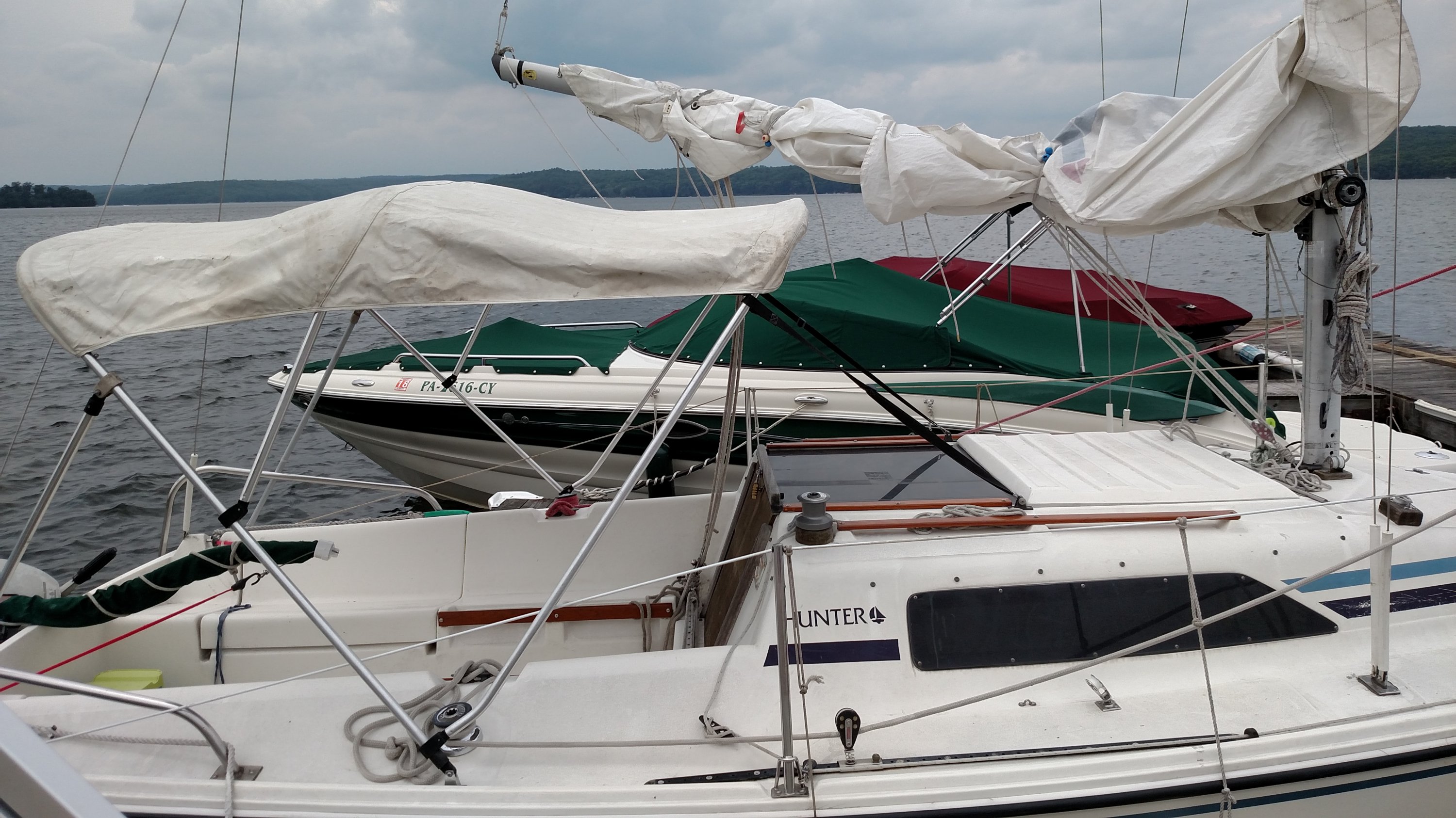

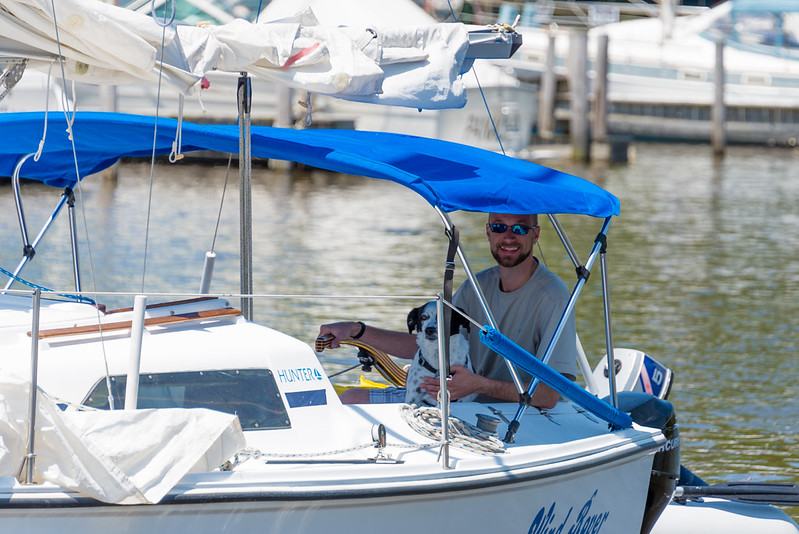

I got a bimini that is 4' and it just barely fits against the back stays and it went about 4" in front of the main sheet traveller padeye, so I moved it toward the mast to allow the bimini to clear.
It works pretty well and I've been extremely happy with it, since I burn so easily!

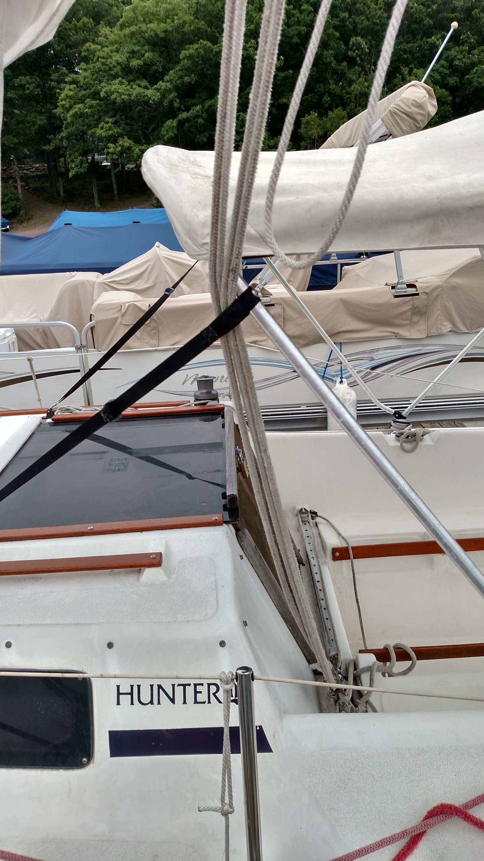

Thanks all. I think the PO (first owner) bought this at a dealer in New Holland PA, which is not near any decent sailing waters. I suspect the dealer may not have had a lot of experience with "blow boats". As an example I discovered that the jib furler had been installed incorrectly. So they probably sized the Bimini incorrectly.
I want to leave the main sheet vertical, and clearly can never sail with the Bimini open. I think I am stuck just leaving the main sheet drooped like in the photo, while it is open. While not ideal prob. OK since we'd only ever open it while on board at rest.
Other than major surgery to the tubes and fabric, or a new one altogether, I don't see any other options.

I like the look and fit of your bimini. Can you give me the source it came from and the dimensions : width, length, height and number of bows you'd recommend. Also, did it require any modifications of the bimini frame or boat rigging. I think I've read on some post that the owner moved the the main sheet bale attachment on the boom forward 4-5" to accommodate the forward bimini bow of his bimini choice. Were any mods similar to this required. Thanks for any info.

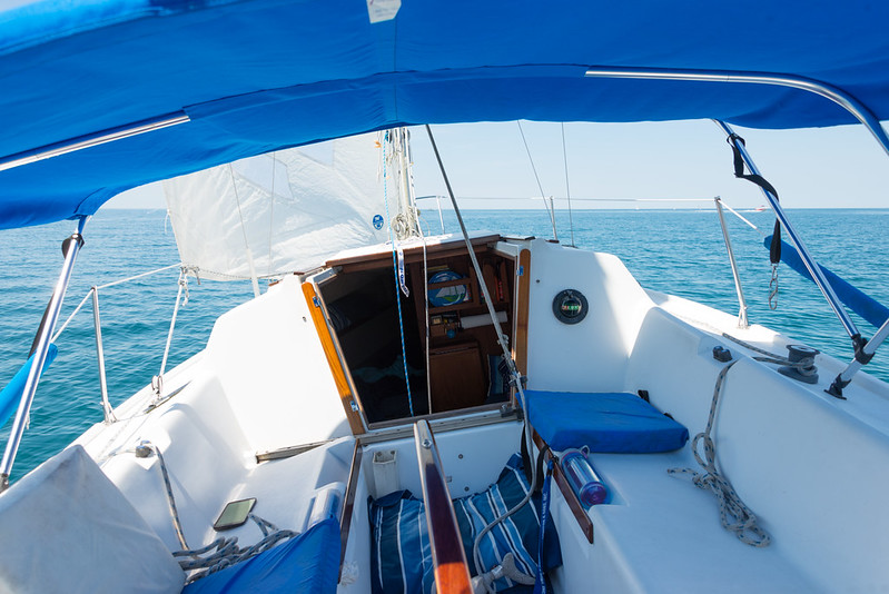

I got mine from this site back in 2010. I just selected Hunter 23 and it came pre-sized. I had to move the main sheet bale forward about 4" to accommodate it open. It wasn't a big deal.
