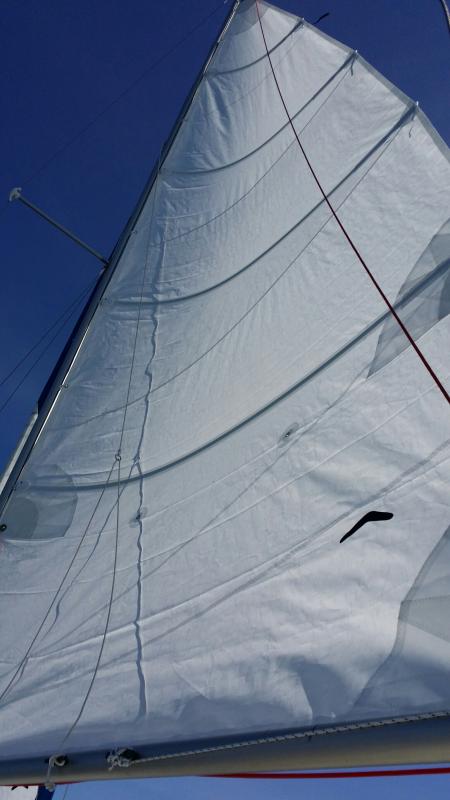

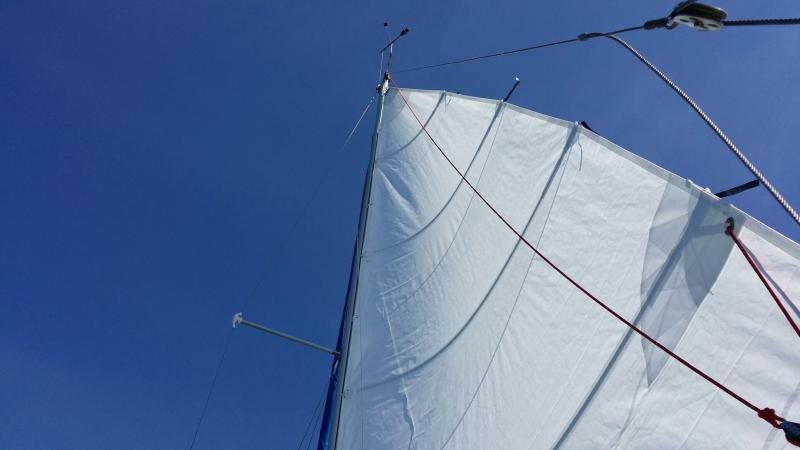

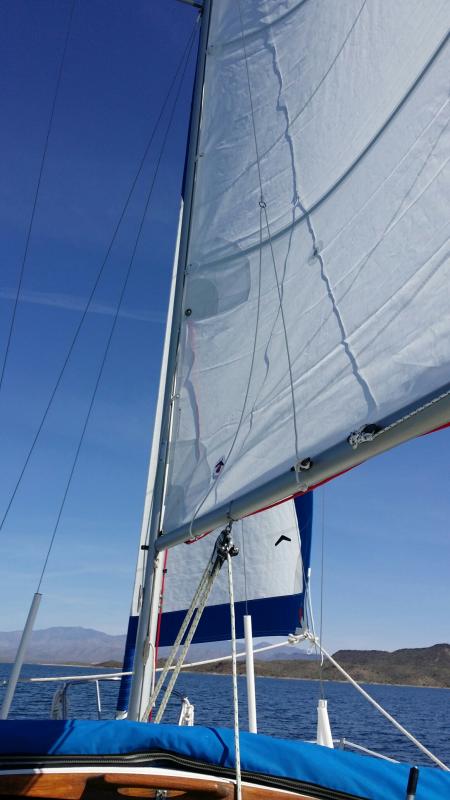

For six years now, I have been using on my 1980 Cherubini Hunter 36 a second-hand Catalina 36 dacron full batten main sail probably made in the mid 1980's. I did the bolt rope procedure in RichH's link. The sail has since driven my boat forward countless countless times in the frequent SF Bay 20-30kts wind. After all the years and outings, the fabric integrity is still fine.
Also, the ~135 head sail that was on the furler when I bought my boat also is from the mid 1980's. I still use it during the winter when the winds are generally much lighter on SF Bay. Fabric integrity is still fine enough that I am not concerned about losing the sail when out.

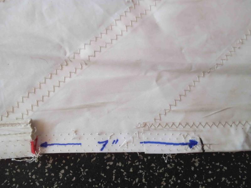

Going back to the topic of shrunken bolt rope on the mainsail. Can you comment if possibly also the dacron itself stretches along the luff? I ask because a few years ago, for a head sail, I detached the #6 foil luff tape from the sail's luff by carefully cutting the zig-zag stiches. Subsequently, laying the sail down flat across my driveway into the garage, the luff length of the relaxed sail fabric became 7" longer than the original ~42' luff length. See the attached picture (which I have posted before).
Luff tape is Dacron appearing fabric with a synthetic fiber cord sewn in which I would conjecture might not have a tendency to shrink much? Maybe instead the Dacron sail fabric stretched through the years? Or it's a combination of both?
Maybe the same happens with main sails?
Because of the 7" increase length of my jib luff after re-sewing the luff tape back onto the Dacron sail fabric, I needed to cut down the jib luff at the head a bit because the previous head now extended beyond the top of my furler's aluminum foil length.

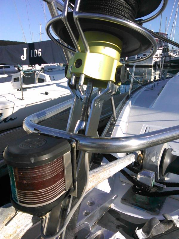

I'm a big Profurl fan.... I'd get the cruising foil (round) with the extended tangs to raise the sail off the deck for better visibility and water dispersion.
I installed a new Profurl last year with the extended tangs that Joe mentions. Here is a picture of the outcome. From memory, the extended tang option doesn't cost more than the deck swept variation.
Luff tapes (called continuous support luff tape) and Boltropes are NOT the same thing.
Boltropes prevent the luff from stretching.
Luff tapes and luffs can easily permanently stretch due to long term heavy halyard strain or long term use of the sail in high winds .... and when they do stretch the sail cloth panel along the luff will also become permanently stretched.
The main cause of all this is: forgetting to release jib/genoa halyard tension at the end of the days sailing. Same permanent stretch will happen when forgetting to release the outhaul on a loose foot mainsail at the end of the day. Such permanent deformation is called 'creep'.
Suggest you consider (if not already used) a luff tape with two small embedded reinforcing (small diameter) rope ... One of the very small ropes inside the tape fits inside the foil groove, the other will be located 'just behind' and outside of the 'groove'.
