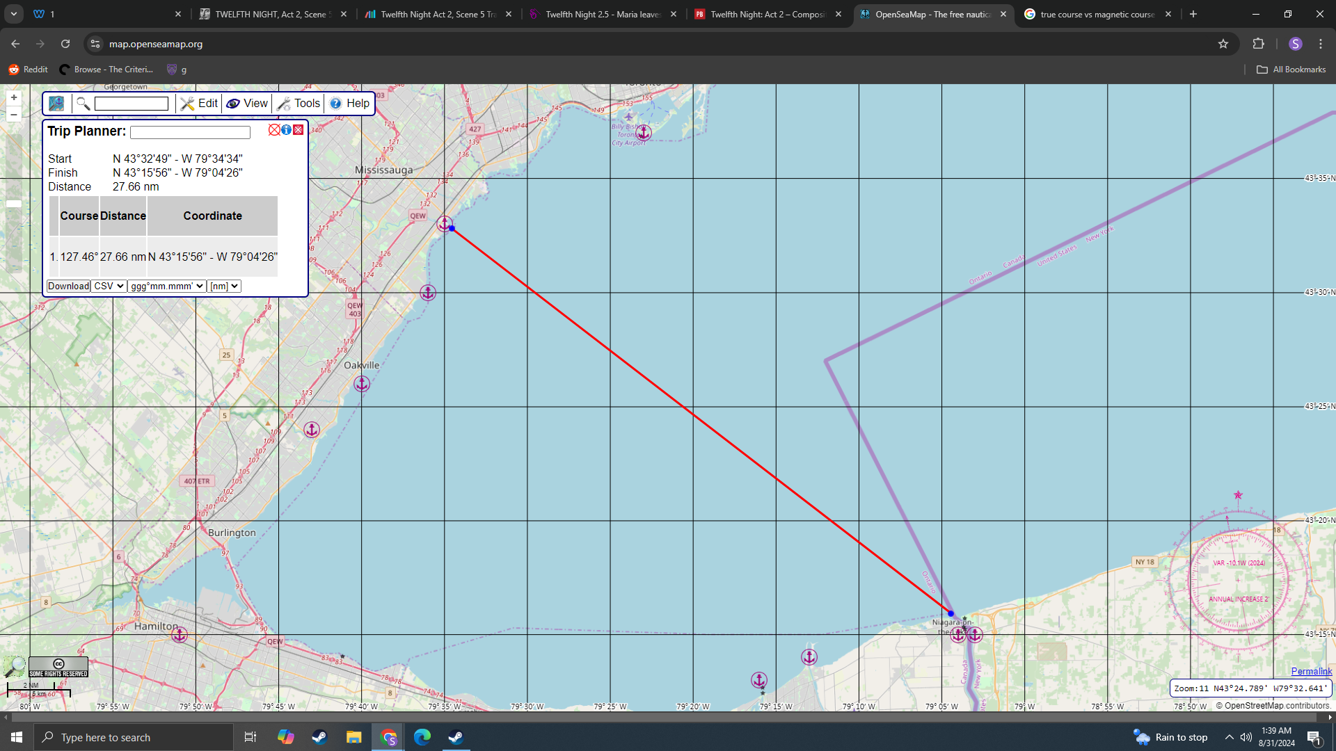

Hello,
I am a new sailor and want to understand how to chart a course. I understand that it is rather complex so I want to leave it simple for now. This is more hypothetical as I am not experienced enough to sail that far. I don't own any nautical charts so I have been using an app called OpenSeaMap. Let's assume that I want to sail from Port Credit to Niagra-on-the-lake (which I have included below). It is a distance of 27.66 nautical miles and it says I would need to sail on a true course of 127.46 degrees. However, I want to use a magnetic compass. The magnetic deviation is -10.1W. I understand that if the deviation is west, it is added to the true course, so I would sail on a course of 137.47 degrees on the compass.
Can someone tell me if that is even remotely correct? I have not accounted for other factors such as the tide.
Thank you!

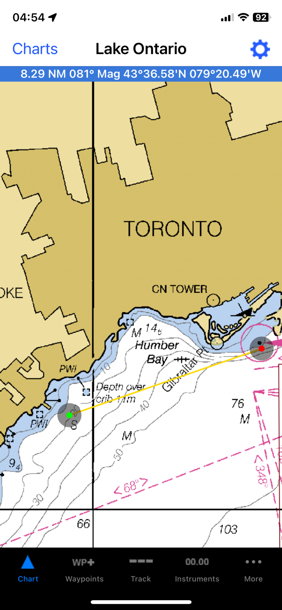

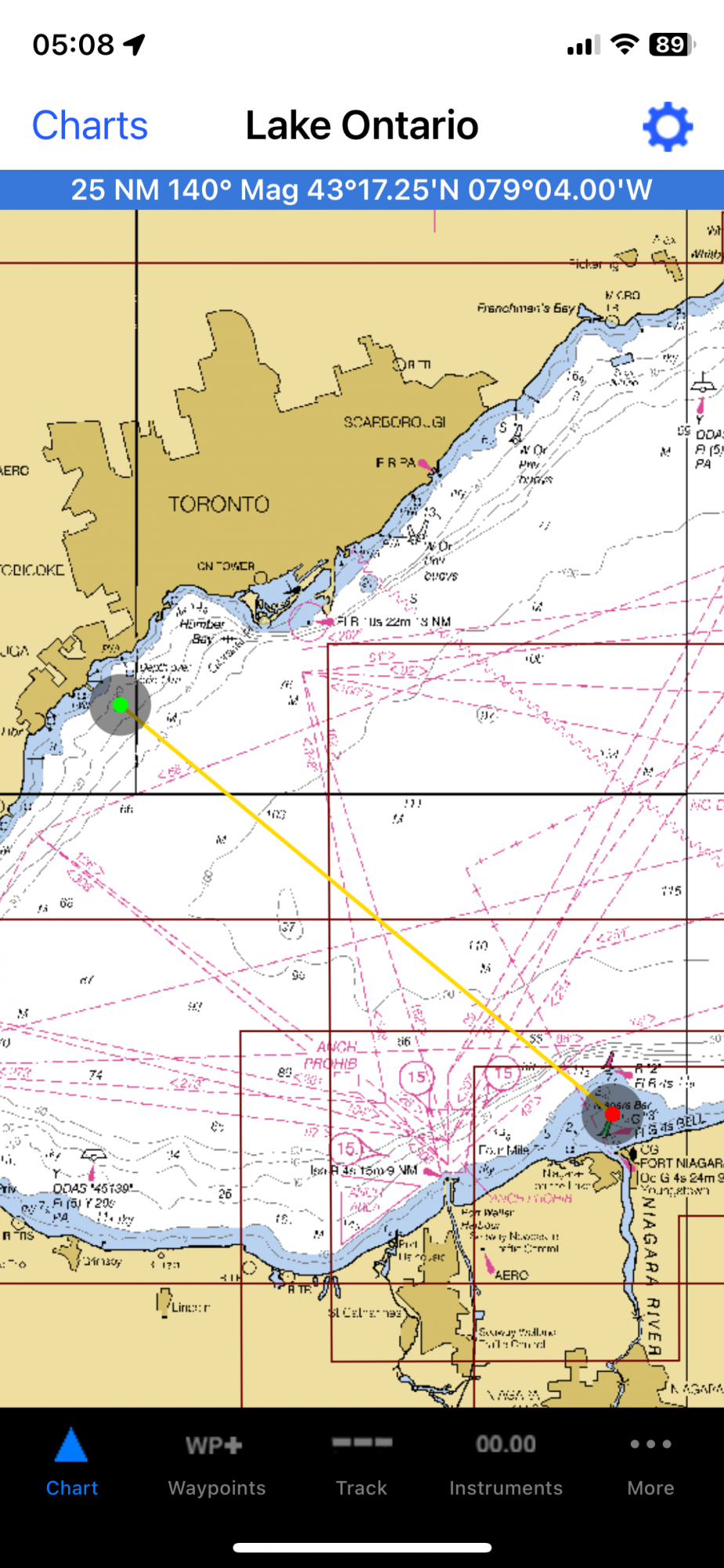

Thanks for the resources! I will check them out soon. I noticed the first course you charted came out somewhat different than mine. Is it from Port Credit to Niagra-on-the-lake? Cheers!

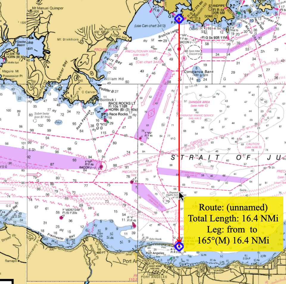

note my compass heading and head out
That is precisely what I did a few years ago when I left Victoria, heading to Port Angeles to return to the USA from Canada. It is 15º 32' + East magnetic deviation. It was clear (Visibility 10+ nm) when we left Victoria. A Sea Fog formed in the middle of the Strait. Visibility went down to 2nm. We continued our course heading, following the compass. As we approached Port Angeles, the fog cleared. We drifted maybe 1nm west due to tidal currents. It was a glorious day.
Here is the chart.
Here is the chart.
And to be fair, I have GPS and a chart plotter on my boat…
But we did learn dead reckoning in my sailing class. Probably have a divided ruler in the nav desk…but honestly haven’t pulled them out in 10 years:(
