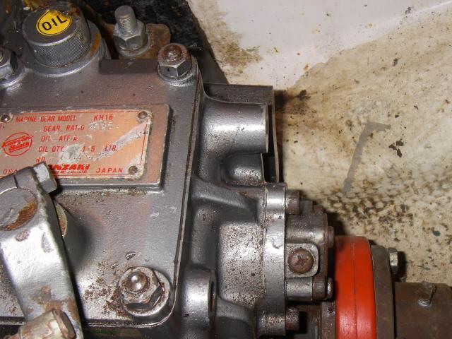

I have a 1983 37c with the 3QM30F engine also. See attached picture of the transmission label.

I also have a 1983 37c with 3QM30F and it takes ATF (automatic transmission fluid). I don't believe brands make much difference but do believe in sticking to one brand. The first time I double changed with Penzoil Dexron 111 and have stuck with that.
The picture was from when I first got my boat, it is cleaner now......

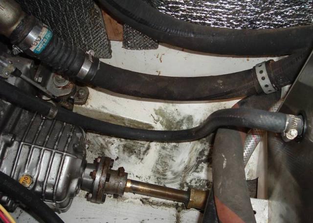

Your transmissions are very different from my 1979. Obviously yours uses ATF as seen on the label. My label was on the side and said nothing about lubricant. When I sold the engine and tranny so went the manuals. I wanted to verify what it said about using regular motor oil. Other guys with "old" Cherubinis will vouch for it. And like John, my picture was taken before I owned it, during the survey. :)
