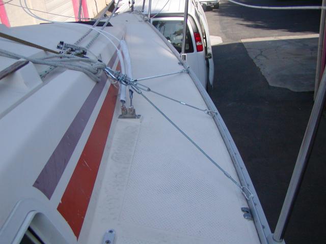

Mar 6, 2008
1,524
I am not sure if you have toe rail - I used the toe rail on my 1984 25.5 Hunter to create the idea that you are thinking of. I have more photos if you would like to see them. My mast also swung 45 degrees one way and bent the hinge - but I straightened it and I did not want that to happen again. The 3 screw rods creates a stationary point that is in line with the hinge pin and keeps the mast straight in the middle while it is being raised. I tie a harness to this point and connect a line around the mast and pull up with the main halyard up to the bottom of the spreaders and pull them tight. This works for lowering as-well. Let me know if it worked for you. My mast I think weighed about 300 lb.. haro_b@att.net

No, the H23 lacks a toerail - else I'd use chains, or rods like you did, Joe. It has a kind of ridge, roughly an inch high and wide, molded into the deck, and of course that has no holes as attachment points. Whatever I do, assuming it is well fixed, it'd serve much the same purpose as yours. What sort of line/wire do you use for the harness itself? Have you found that the mast is quite stable with these baby stays?
