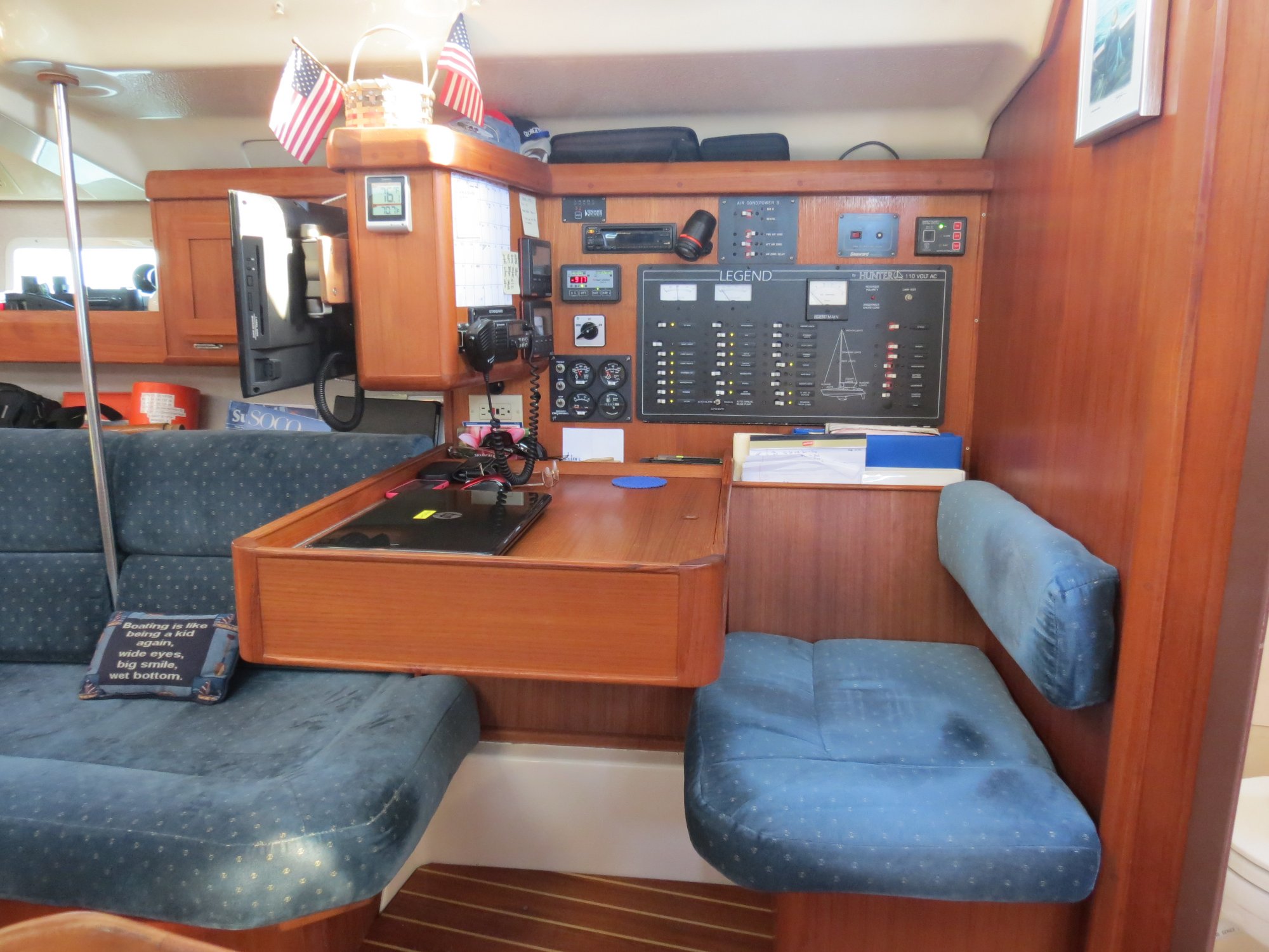

Rick- A picture would help a lot. Your 44DS is likely to be the same as my 40.5. In any event, the picture below shows a wood compartment/box that is mounted above the chart table. If your setup is like this, I can tell you that the only access to the back of anything mounted on the box is through the opening that is behind the CB panel. However I would think that you could access the back of the VHF by simply removing the radio and pulling it out.
I needed access in that protrusion/box to put nuts on screws where I was mounting a TV. What I did was to cut a 5" hole in the top of the box and install a quick access plate. So now anytime I need to get my hands into the box, I can just unscrew the access plate.

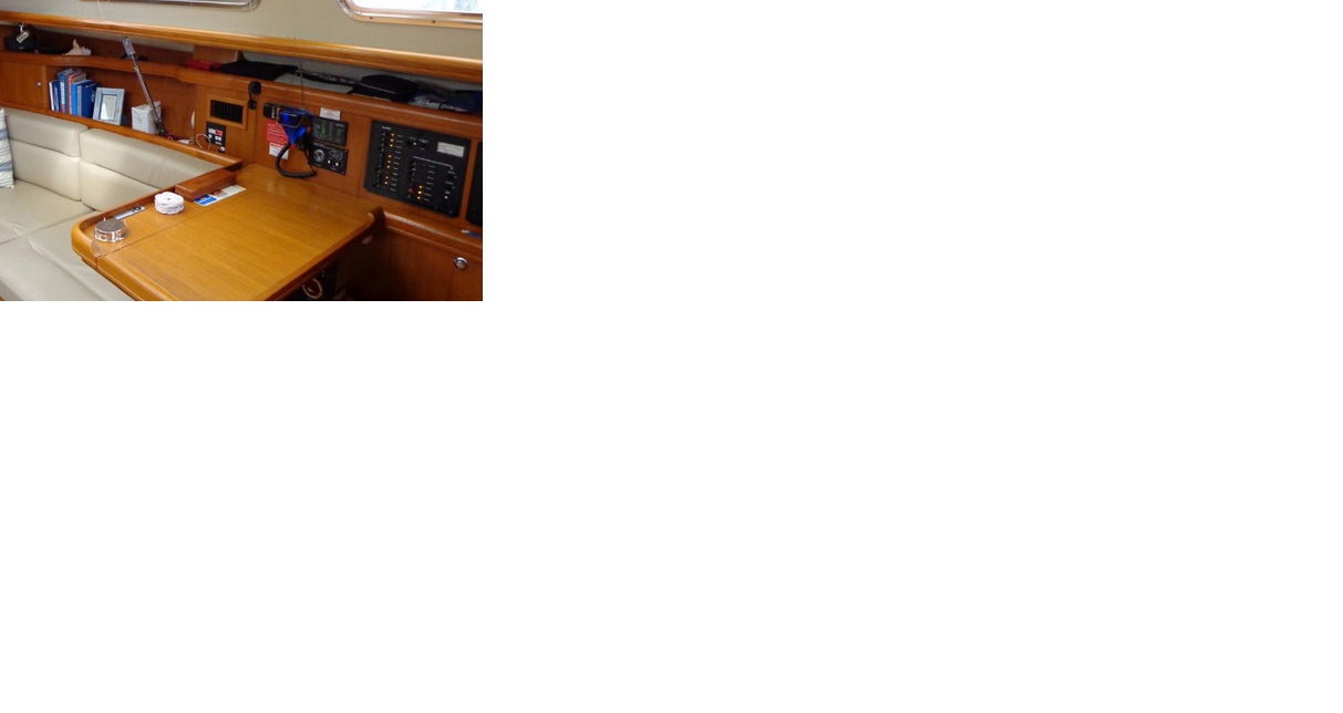

Hi Rich:
Thanks for your response. I have attached a pic from the web that basically shows my situation. I have pics of our boat but not here. I will post tomorrow. You can see this panel with the radio, charging panel, and tank level gauge. My VHF is not accessible from the front as it is mounted inside the panel. You can see the seams forward and aft of the radio/charger/tank level. So I'm thinking that panel just pops out since there is no access above from the shelf.
Thoughts?
Thanks
Rick

Oct 1, 2007
1,865
Thank you all for your helpful suggestions. I "fiddled" with it today and discovered the entire panel pops out. It is held in place with the snap locks as I suspected. In the pic I posted the entire panel from the edge of the switch panel forward to the A/C fitting easily comes out with a little outward pull. I inserted a knife blade (dull) into the space and rotated the blade outward and the snaps release.
Now that is step 1. Next I need to troubleshoot the command mic.
Thanks again,
