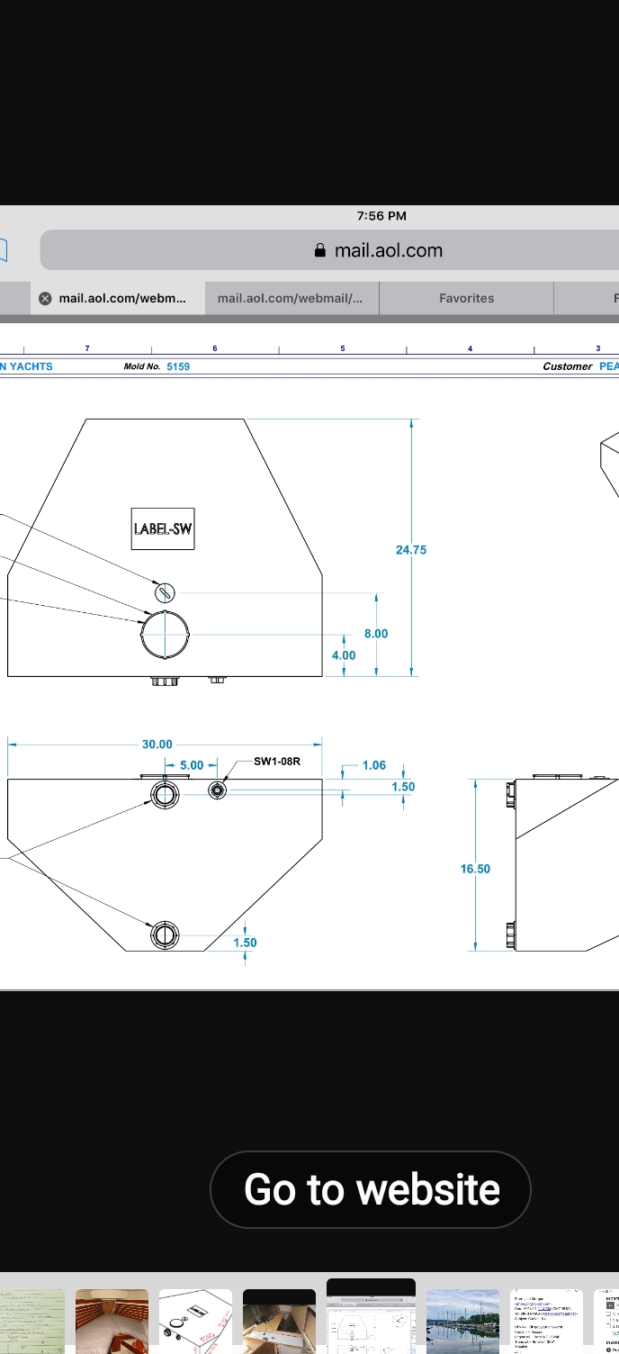

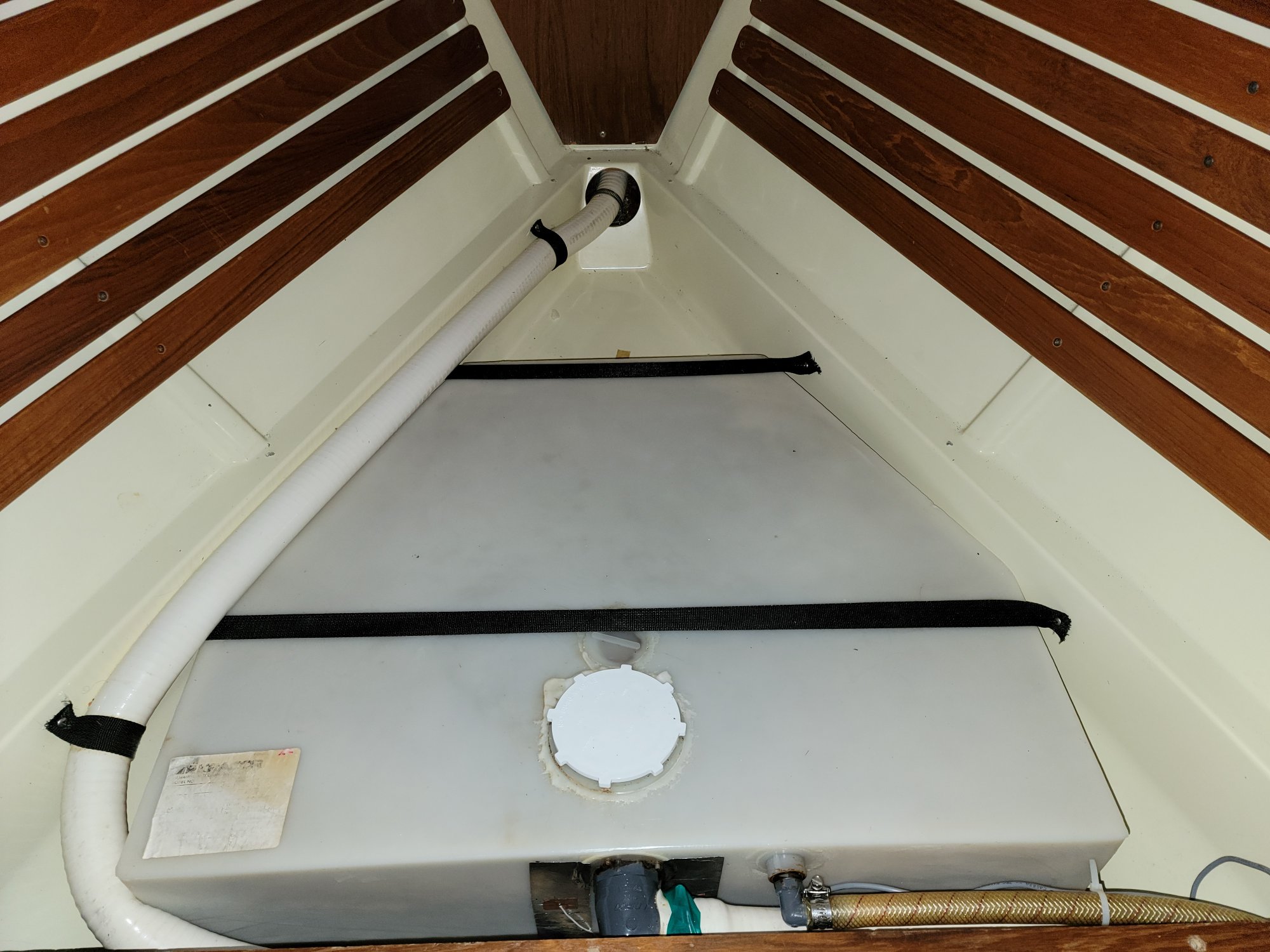

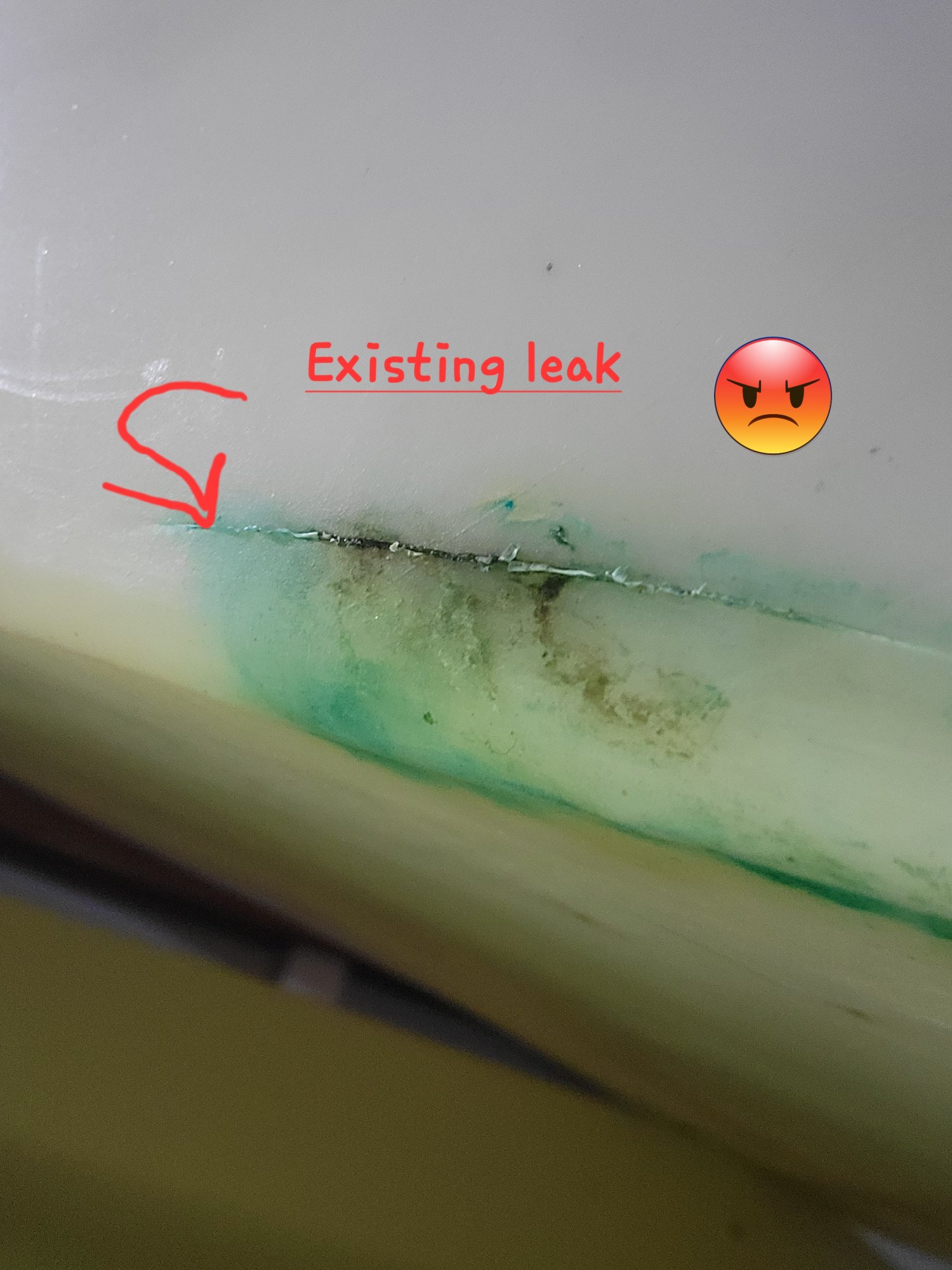

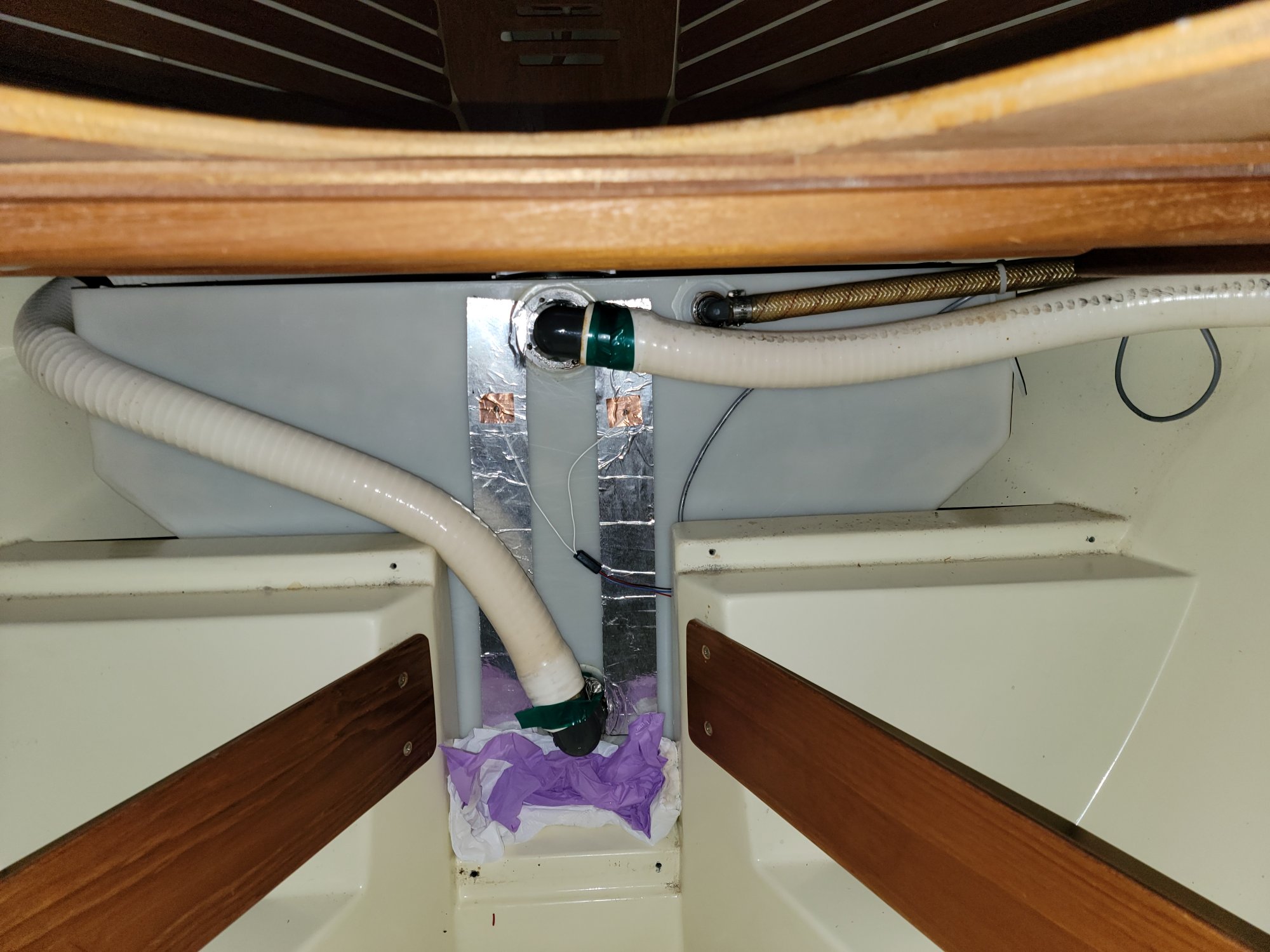

vmaks
May 31, 2012
79
Pearson 31 Suttons Bay
As you can see this tank has a really tight fit and a unique fit in the allowable enclosed area. These pics are of the old tank, old hoses,etc. We have a new tank, same fitting configurations on the tank, better hoses, larger vent + hose. I had to dismantle the entire v-berth enclosure to access this tank. Once I put e'thing back together, clearances for the front of the tank and the top are minimal. Without the enclosed wood structure the v-berth is in-operative as it provides the v-berth bed support. As Miss Hall suggests I will either use quarter mold or rubber blocks + webbing straps to keep it from moving.
