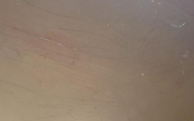

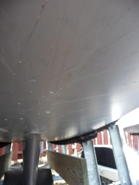

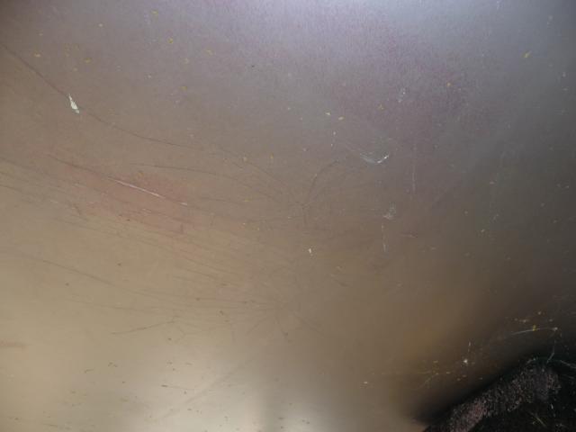

Fellows, I have finally zeroed in on a boat model that I want to buy. I found 3 within 300 mile radius of me and looked at them...they are all about the same age (20 year old) and all have a common defect (some smaller than others)...CKACKS in gelcoat on the bottom they look like a crushed eggshell and on some boats are all over the bottom. Take a look at the pix...how serious is it?
Some say it's just cosmetic-just paint over them with bottom paint...I tend to think it's more serious and they all have to be widened and filled and epoxy painted. What is your opinion? I can send you a higher resolution pix for a better view.

The ones that are clearly visible in the first and third photos appear to be stress cracks and may indicate some serious underlying problems with the hull or impact to the hull in those areas. It would help if you had a good overall photo and indicated where the photos above were located on it..
To me, it is generally worrying to see parallel cracks like that in the gelcoat, as the indicates that the hull is likely flexing along those lines in a fairly significant way...more than just oilcanning.

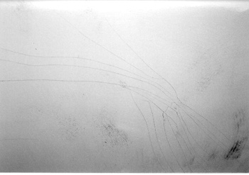

Gelcoat cracks occur in several different patterns, depending on the cause. They are listed in order of increasing worry and severity.
First, and most common is spiderweb crazing...this is a series of mostly random intersecting cracks with no particular directionality to them. It is usually caused by the gelcoat being applied a bit to thickly, and is fairly normal.

The third form gelcoat cracks often take are stress cracks. These are generally parallel cracks that run along an area where the underlying laminate is flexing more than is good for it. Generally speaking, the greater the number of cracks, the more severe the flexing...

Yes, I should have mentioned the model It's oday240. I looked at 1988 and 1989 models.
The pix you see is actually gelcoat painted with VC17.
As for location of cracks - most are about 2-3 ft aft of the keel , near the bunks of a trailer that it rests on. Parallel ones are closer to the bow in front of the keel (keel is a wing type)
as seen on pic 2). All 3 boats that I had seen had bottom paint applied right over these cracks, but cracks show through anyway. My worry is that water will get in and with freezing and unfreezing cycling cracks will widen and gelcoat will start flaking off in big chunks... I wonder if it was a common problem on odays of this year. There sas an oday25 next to the boat that I was looking at It had the same bottom paint, but NO CRACKS at all. One more thing...2 of 3 boats I looked at are vrey dry inside.

Such cracking could be the result of
1. a VERY hard grounding
2. Long periods of inappropriate dry storage on 'vee-poppits'
3. Radical flexing (long time) of the hull during sailing - 'oil-canning' of the hull.
4. Just a lousy gel-coat / matting layer lay-up.
Obviously, the only probable way to determine is by some destructive testing wherein the lay-up sections (gel, matting, roving) in a small 'zone' are sequentially removed and the 'next deeper' section is examined for integrity, especially the important roving layer.
In all probability this is nothing more than a weak bond (hydrolysis) between the gelcoat and the matting later (both 'cosmetic' and non-structural) ...... BUT, Why take a chance? Such to me would be a 'run away from' unless the boat was a gift. Especially too that this boat has a bolt on keel, where the stresses are so concentrated at the keel root (and evidence of 'something wrong') ... would also raise a big RED flag in my mind.

I had a 1988 O'Day 240 for 15 years. (It was 2 years old when I bought it.) I took it off the trailer and put it in the water every Spring -- then back onto the trailer every Fall for Winter storage. Never had any problem like this on the hull. In fact, the gelcoat held up well all over the boat. I covered it every winter, and it picked up some cosmetic cracks on the decks, but it looked awfully good when I sold it.
My trailer had long boards to support the hull along the sides -- which would help spread the load. Do you suppose these boats had trailers with pads -- causing stress points at specific places?

Having read all the comments and your description, it's still too hard to tell definitively what, if any problem exists.
It could be stress cracks in the gel and into the glass;
It could also be a bad barrier coat job which could exhibit this appearance;
It could be a bad VC17 paint job.
It really is hard to tell anything until you remove the paint and see the glass/gel coat.
Unless he knows more than he is selling, any seller should have no objection to you scraping off the bottom sufficient to actually see the structure. Even if you walk away, the seller can demonstrate the appearance of identifying the cause to his next victim/prospect.
Not to diminish the comments above but one can only guess at the cause until you can inspect the structure.

I will bet on the hard grounding theory. look on the inside for signs that the furniture has been disturbed.
May 11, 2005
3,431
Seidelman S37 Slidell, La.
I'm going with
Either a hard grounding or problems from sitting on a trailer that maybe don't fit the hull just right. Those cracks look to me kind of like they radiate from a central point. First thing I would do is as Ross suggested, and check for any movement of stuff inside the boat. Furniture or possibly bulkheads. If you see anything inside, then run, don't walk away.

Just my 1/2 cent worth with NO idea except an opinion....
A hard grounding to the front of the keel would tend to pull the front down and want to push the aft end of the Keel up. Both instances would cause these kind of "Cracks" .
Might not be that big of a deal. As Ross said... Look very closely inside to see if you can tell were the Glass may show the same type of past flexing.
