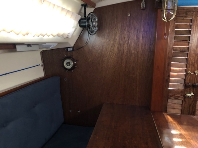

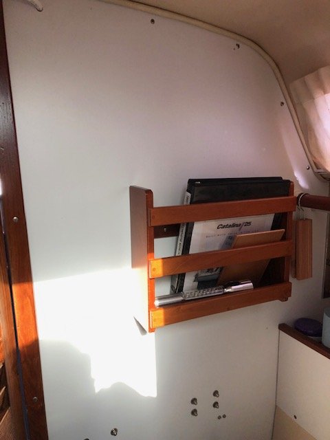

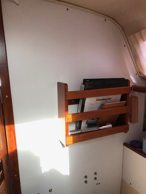

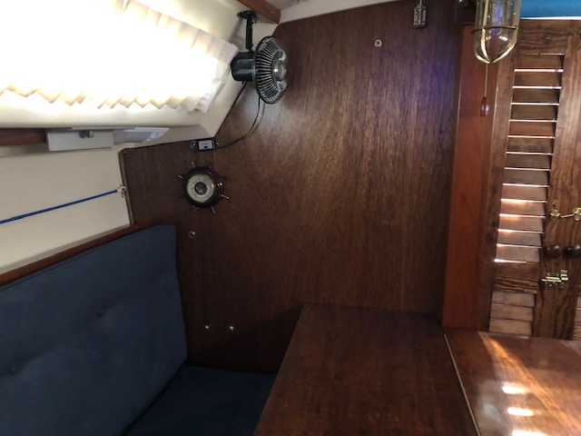

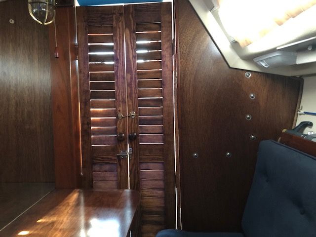

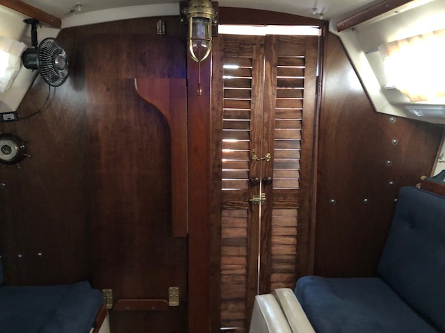

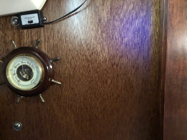

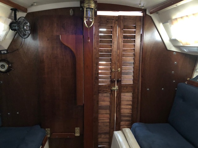

Attached are some pix of the bulkhead replacement project. It was not necessary to remove the compression post but maneuvering the new port bulkhead into place was like a magic trick, but it was able to be done in one piece. I used the old bulkheads as templates to cut the shape but drilled the holes for the chainplates and the tabbing screws once it was in place. (The hidden screw was NOT replaced.)The starboard bulkhead practically jumped into place on its own but the port bulkhead required a lot of wailing and gnashing of teeth. I used Hydrotek Meranti and was able to cut both bulkheads from one 4 x 8 piece. The stain, however, did not quite match the existing interior. Three coats of marine spar varnish followed. The backs (forward sides) were painted satin white. The project was completed with the mast down and the boat on the trailer. The louver doors did match up until the boat was in the water, the mast was raised and the shrouds tensioned. After that they were misaligned by about 1/4".
