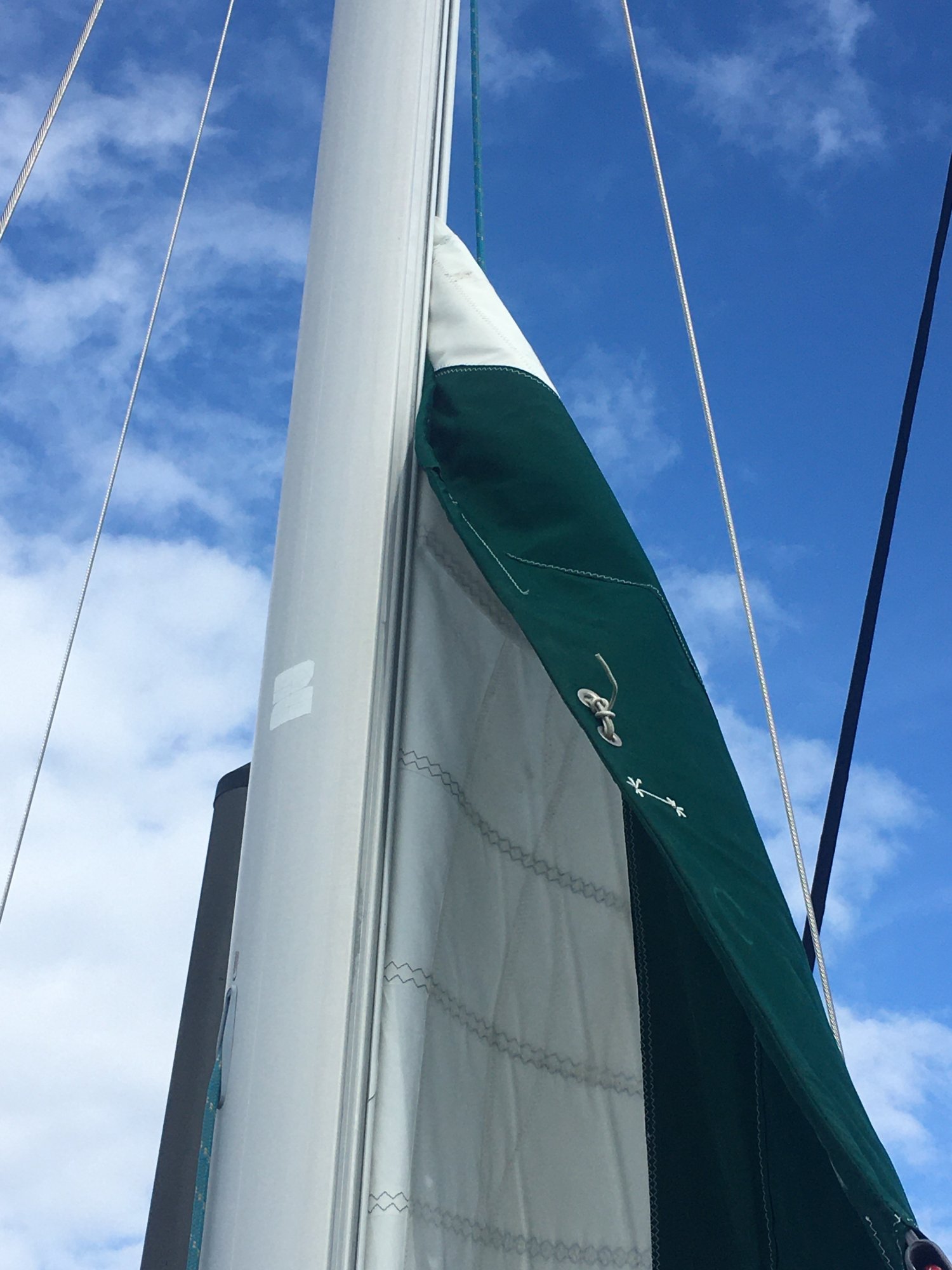

Since buying my b-331 a year ago, I have never been able to unfurl the mainsail completely. The foot is out completely but not the head of the sail. I bought a new Neil Pryde mainsail and need instruction on how to remove the old mainsail from the furler. Is anyone available to give me instruction or advice on tricks to do the job done?

The whole luff rotates on one foil, so I don’t see how the foot could be out and the head still partially furled.
I just unfurl mine completely and release the halyard. It starts falling on its own and then I pull the luff down a little to help it along. The trickiest part is getting the head and tack shackles off the foil after the sail is down. That takes some delicate work reaching inside the access cutouts. For that step it helps to stuff a rag in the mast under the sail to catch any escaping parts.

Do you have vertical battens? On my 361 the top batten would stick in the mast not allowing the top to come out while the foot of the sail would fully extend. Battens or not the solution is to go up with a bosun's chair and yank the top out!

When the top of the sail is jammed in the mast, we alternate pulling the inhaul back in a few feet and pulling the luff out a few feet at the mast, going quickly back and forth until it comes out. this process needs two people, one in the cockpit on the inhaul line and one person standing at the mast. Thankfully, we have never had to go up the mast.

Ah the challenge of a furling mainsail, with (2) persons one in the cock pit and one on the mast mounted winch deploy the mainsail controlling its deployment from the mast mounted winch watching the luff edge at the same time the person working the outhaul in the cockpit keeping tension on the outhaul, working as a team work the sail in and out in small advances and furl back in, back and forth while on a starboard tack. Allow the mainsheet and vang some slack.
Sounds as if the main at one time was furled hurriedly and possibly while going downwind, which will cause the head of the sail to start its adventure back into the mast before the tack.
Once you have the sail all the way out (head and foot) you will have to furl it back in while paying attention to the luff edge, make sure it goes back in somewhat evenly, so when at the dock while pulling it out during an almost windless day (or in the lee of a building, or bow to breeze) it (the main) come out fully, then you can release the main halyard and pull the sail down.
Once down you will see how head of the sail is connected, be careful not to drop and parts.
While the sail is off, lubricate all the moving parts of the furling system with while lithium grease or dry lubricant, The upper (top of the foil) is important and usually involves stepping the mast to lubricate properly.

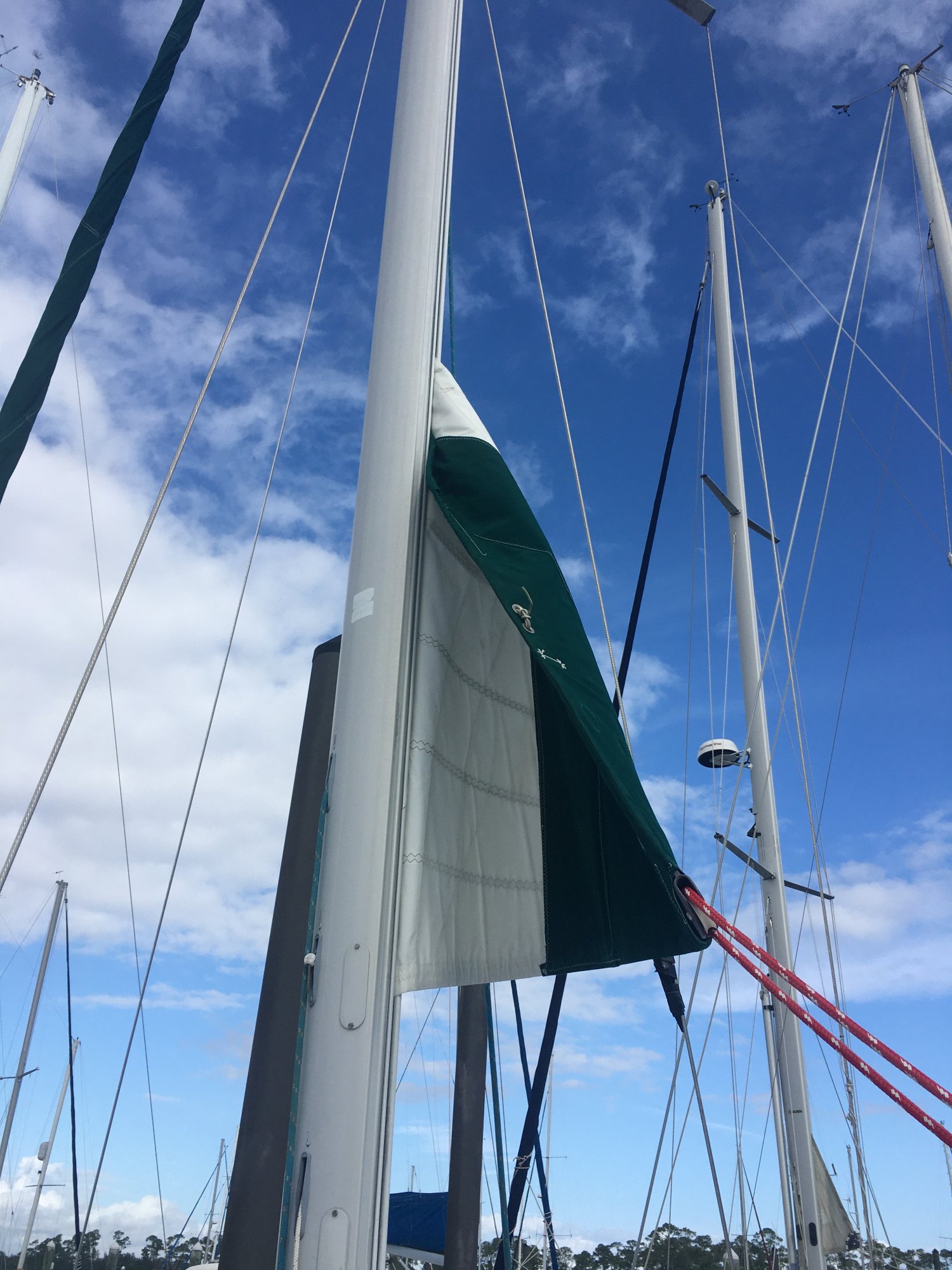

Thanks to everyone who posted a response. Unfortunately, I took my boat out for a sail, to really work the main sail furler... and I got things really screwed up. The sail overlapped and jammed up and down the Mast track to the point where I was barely able to get it in, with still about 4 ft out. After getting back to the slip, I went to the local rigger with my photographs. He said "I know exactly what your problem is, you're using the original sail and that is not going to work. An in-mast furler works well with a crisp new sail and will not work well with anything old and blown out. I had to unjam one this morning just like yours. We fix them all the time, but you need a new sail." Fortunately, I have a new sail I bought fron neil pryde at the Annapolis boat show that I have been waiting to put on...., so he and I arranged to have him do the job next week. The rigger asked me to pressure wash the bearings below the Barber pole line wrapper before bringing the boat over....I admit I did not know there were bearings down that low, but I guess there are.

Yeah, that’s a bad one. One key point when both furling and un-furling - if it’s getting harder or the sail is starting to overwrap you should stop and reverse direction quickly. No good comes of trying to power through it. The wraps don’t work themselves out, they just get tighter and harder to fix.

I've never seen the foot of a sail so high. Mine is no more than 2-3 " above the boom. That looks like a couple of feet? Definitely going to be fun to untangle.
