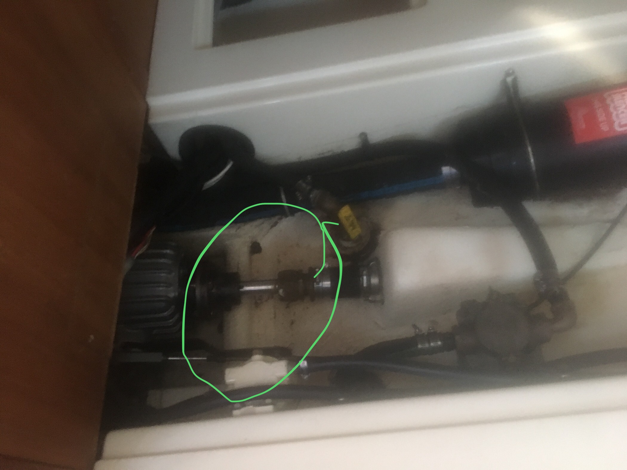

That doesn't seem like a lot of water, but the goal is no water.
Look for its sourced, you may easily be able to stop it. It could be condensation, but probably not.

Kgatesma -- unless I'm mistaken, that's not a stuffing box. It's a shaft seal.
Assuming you don't have a bent shaft or a misaligned engine, etc. , it's usual for there to be a few "drops" of water to be emitted by the shaft seal as it starts to spin. On our J/Boat (19 years ago when we got her) we had a flexible, clear plastic shield installed because we noticed on other boats a line of corrosion on metal parts in a various other boats' engine rooms where the sea water had created a line orthogonal to the shaft. It was subtle, but consistent on a variety of manufacturer's boats. The seawater usually just evaporated, but anyway....
Your boat doesn't have a vibration isolation fitting between the engine and the shaft, so you have more vibration at start-up or from use.
Do you have a feathering or folding prop on your Hunter? If not, then you may have a shaft that turns constantly.

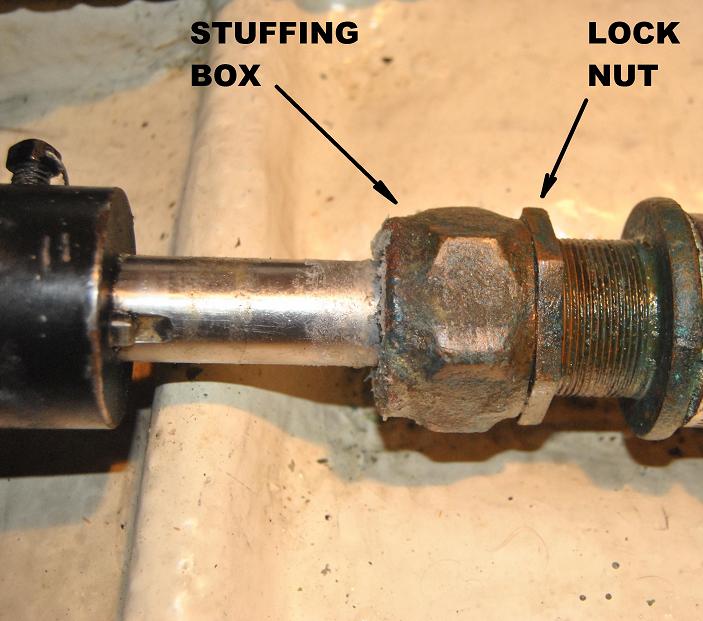

Is there a difference ? ? ?
Yes. They function completely differently.
The expectations of performance are different. They are devices that function very differently.
If you over-tighten a stuffing box "lock nut", you'll have negative consequences. You should expect some very, slow, intermittent dripping while the shaft is turning.
With a Shaftseal, you should expect no real noticeable dripping unless something is amiss. (As I pointed out, the key is "noticeable" because their is often a momentary "spitz" which you'd not likely notice -- only the traces of it.) If you have a vibration issue where the parts (rotor and pressure block/plate) don't mate; or, you don't maintain reasonable pressure by adjusting the "compression" of the bellows, etc.), then you might get a bit of water.
PS.- I didn't see much adjustment room and no "protection" donut/or a stopper on KGatesma's installation.
And the over-tightening of the "lock nut" affects the packing how ................................................. ? ? ?

If that is in fact a PSS, where's the vent hose?

The packing wears out from over heat or scores the shaft.
Yes, of course, when you over-tighten the stuffing box NUT, but not when you over-tighten the LOCK NUT. The only thing that causes is skinned knuckles when you try to undo the lock nut after a year of sitting there.

Yes, of course, when you over-tighten the stuffing box NUT, but not when you over tighten the LOCK NUT. The only thing that causes is skinned knuckles when you try to undo the lock nut after a year of sitting there.
;^))). Yes. I wrote loosely. Not about the distinction between that nut and that not so loose screw.

To your question, after I hand tighten our stuffing box (our packing material is in fair condition, but due to be replaced; last replace in 2011) there should be no drips when the shaft is at rest, and maybe six to eight drips per minute when the shaft is spinning. Depending upon the age and/or amount of use, you may need to replace the packing material. Making the adjustment mentioned above should provide some indication.
