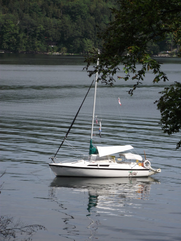

The six inches is relative to the waterline (Teliki floats pretty close to it). This is the way it came and the side shrouds look to be original. When I removed the rake, I had to add to the back stay to get it connected. The forestay was shortened to accommodate a furler (previous owner).
But I do get what you are saying. The mast may not really have that much rake - it just appears that way. That idea may be supported by the fact the shrouds and back stay All seem to be the proper length and that the boat balances very well.
The attached pic shows what I mean - Teliki is flat on her waterline but the rake is quite noticeable. On the same trip we were anchored with Nelson (Tootsie 26S) and it had about half the visible rake. Both boats seemed to be riding about the same on the waterline.

6 inches or rake? Why not.
Most boats are designed to have some (1-2 degrees) rake in the mast. And the standard rigging supplied with the boat will account for this. You can always measure it (with boat floating on her lines) with a line and a weight off the main halyard. Just measure from the back of the mast and be sure to subtract the length of the backstay crane if your rig has one.
On a boat like yours with a 28 foot mast, 6 inches of rake is only ONE degree.
One more thing, Adding X inches of rake doe NOT require X inches of additional forestay length. Recall your geometry, and remember the mast top is also swinging down as it goes back. You could very easily have 6 inches of rake.
