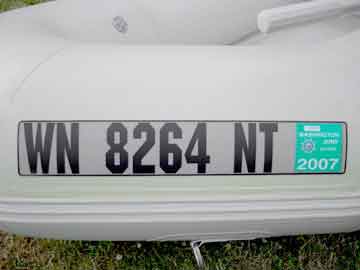

I just bought a set of boat number plates for my Achilles dinghy. They are 3.5" x 18" and I have two of them.
I have 5 ounces of two-part Hypalon glue on-hand and I am wondering if that will be enough. If not, I want to get more before I start the glue job, but I don't use the glue very much, and supposedly it has a shelf life so I don't want to buy if I don't need it. Each plate requires two thin coats of glue to both the plate and the dinghy area. So I need enough glue for a total of eight thin coats for both plates.
Has anyone glued these boards on their dinghy and know how much glue it really takes?

These "number boards" are custom made by http://www.boatnumberplate.com and they are made for either Hypalon or PVC. They are flexible so you can deflate/inflate without the numbers or sticker coming off. Rather pricey at $46 but for years I have used stencils and magic marker or paint with poor results. The paint runs under the stencil and looks terrible when done and the magic marker transfers to the other parts of the boat when folded and fades so badly that I need to re-do it almost every year.

Hi Rich, I bought the same number kit last year for my inflatable, mine took the PVC glue which I purchased from WM. It came in a 25cc tube, I needed almost 2 tubes to glue mine on (almost 50cc), which I also picked up at WM. Cleaned the boat and back of plates with accetone as per directions, they really stuck good !! Happy with the way they turned out.. Good Luck, Mike.

Rich, Yes it was 50cc for both plates, I traced on outline on the rubber boat then applied glue to it, then to the back of the plate I believe it said wait 15min. then stick the plate on. I forget it might have said two coats of glue on each? Anyways, I did like the directions said and it came out very good! Mike

Thanks, Mike. I had also sent off an email to the boatnumberplate people and I just received a replay that an installation requires 2-3 oz for both plates.
