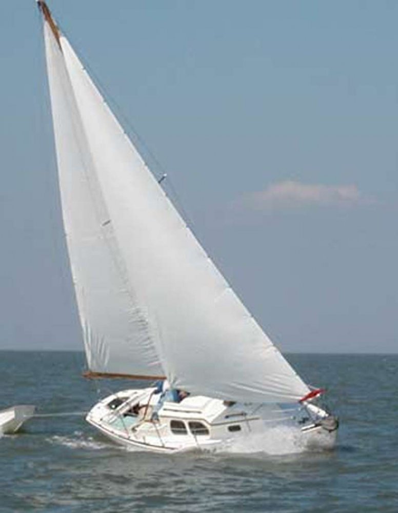

A I said- My rail goes under (per my inclinometer) at 45 degrees heel
Tehani is an old Seafarer Meridian- Phil Rhodes design, from 1961. 2500 pound cast iron keel, and a wine glass shape to the hull. ANY wind at all and she's at 15-20 degrees And locks in there. VERY good helm balance- I can steer with a finger tip
Sailing pic in Matagorda Bay

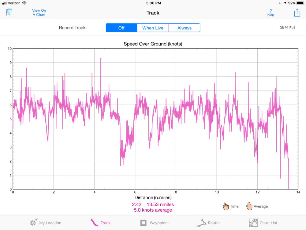

I don’t mind up to 30 degrees of heel or so, but the Admiral starts squawking at 10 degrees. Boat seems very happy and fast around 15 degrees. But we were out in 17 kt winds, with reefed main and partial Genoa, and sailed a respectable 6-7 knot run with a fairly flat boat.
Greg
